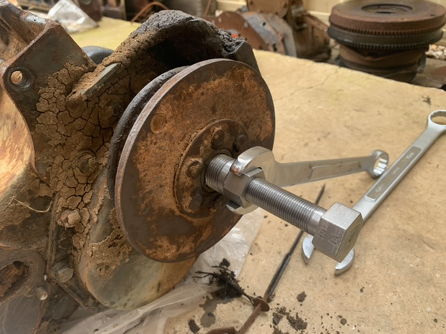

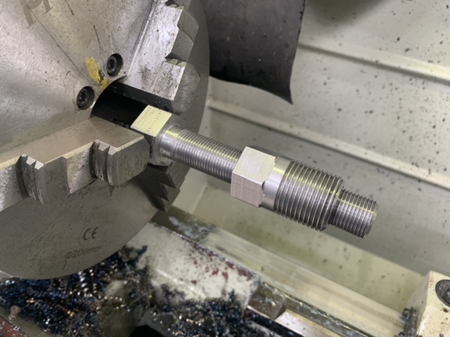

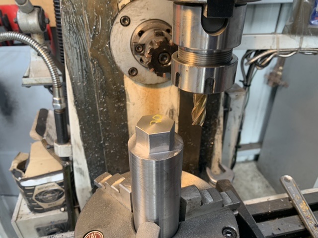

So after picking up a 3.36 diff center from Rick and checking out his wild green machine I threw my diff housing in the acid bath then gave it an etch and a coat of GMH black.
Didn’t get a photo of the finished paint sorry I also have been stripping grey motors to find some
good usable components, didn’t have a harmonic balance puller so I whipped one up.
If any one needs to borrow it just shout out
Worked a treat
[/attachment]
Worked a treat

just whipped one up eh ????????
nice work , when you have another 5 minutes spare can you whip me one up too ????
