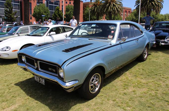

Another random thought has come my way: I repainted my LJ GTR a metallic silver blue colour ( can't remember what it was called, but think it was one of the standard holden colours at the time- might be Electra Blue metalic) and they had black sills and around the tail lights. I think I will go for this colour scheme for Fred, and give the black sills and plenum grill a try to see how it looks. Might look nice with my chromies and black interior
All howls welcomed.
