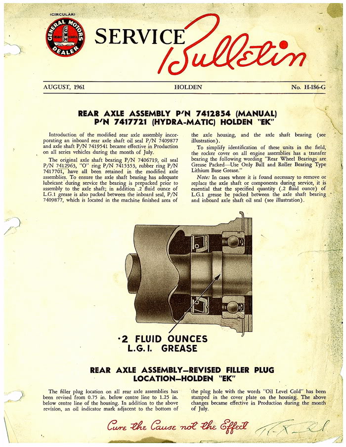

Big warning Joe! If you're going to run inner axles seals you must pre pack the open bearing with 2 ounces of LGI grease or alternately run a sealed bearing with or without the seal.

Craig Allardyce wrote:Big warning Joe! If you're going to run inner axles seals you must pre pack the open bearing with 2 ounces of LGI grease or alternately run a sealed bearing with or without the seal.
Bloody hell! You’re absolutely right. I completely forgot to do this Image
Thanks for spotting this Craig (I think Rob even made mention of this earlier), I guess I’m just so used to the sealed bearings I’ve always run on my later model cars that I went into autopilot on reassembly... all good, I’ll sort it out tomorrow. I’m a pro at locating those axles now anyways Image

FYI

Craig Allardyce wrote:FYI
Am I right in understanding that LG1 is white lithium grease? What is the modern equivalent? I have HTB and moly disulphide only in my stash, so I’m off to the parts store this arvo.
Again, thank you for this information...

Interesting about the transfer mentioned in the service bulletin Craig. Never seen one.
