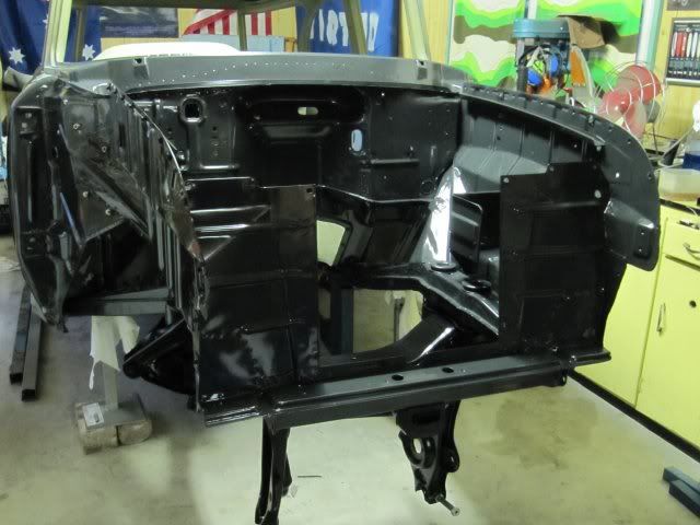

Got the front subframe on this arvo with Luis help. :thumbsup:
Question...or tips needed for a young player...
My plan was whilst the car is on the car stands...assemble the front cross member with suspension and to the point where I can bolt the wheels on and then jack it up to the front end and bolt up. Should the guards be bolted on when this is done to support the front end?
Then do the rear end. Once both front and rear wheels are back on get the car back on the ground. OR
one end first and lower that to the ground and then do the other and and then lower that end to the ground.
Just trying to work out the best step by step getting it rolling again. Any thoughts appreciated...

Yep all bolted up Tim. Thanks for that.
If all the bolts are in the subframe this is no problems at all
I've found out I can too...! :)
Re: Rebuilding of Old Timer (EK wagon)
OK. That was Luis suggestion too. Many thanks.

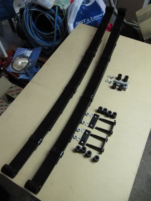

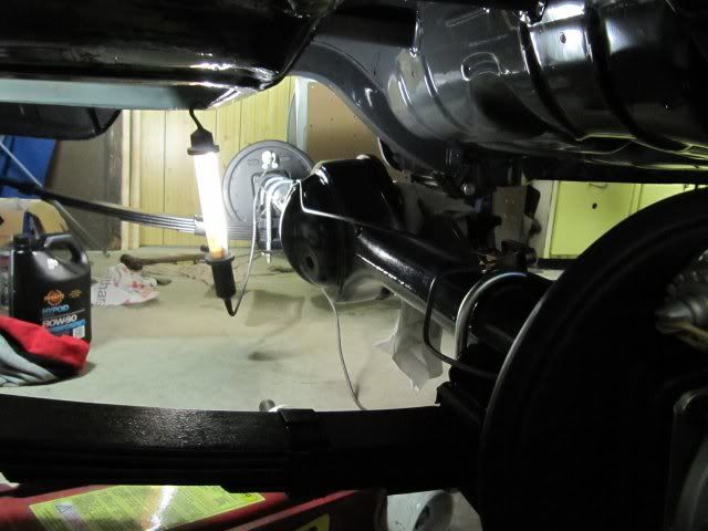

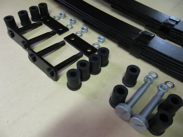

I started putting the rear end together first as it seemed a more straight forward job.
Putting the front pins of the rear leaf springs wasn't as easy as expected but I got there in the end....http://www.fbekholden.com/forum/viewtop ... 24&t=14894

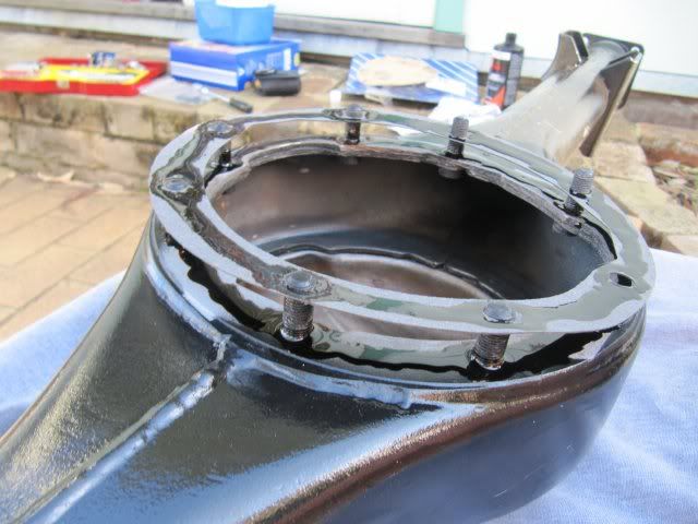

The centre is a 355.

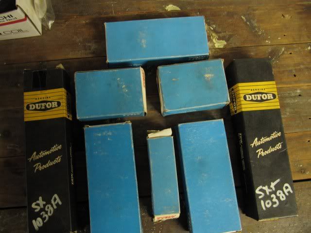

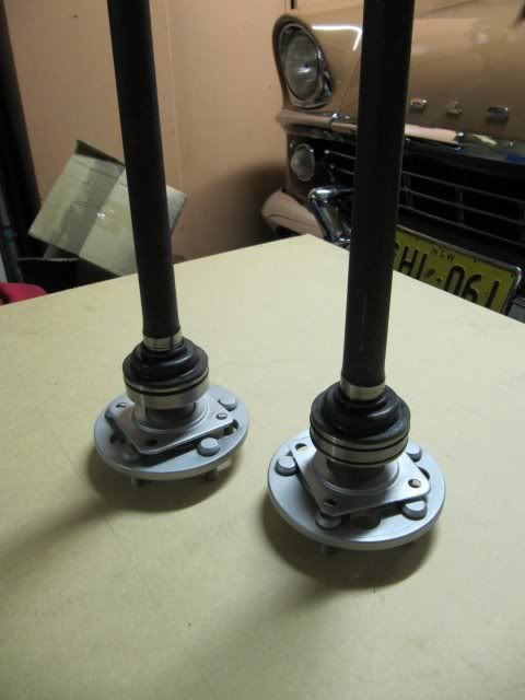

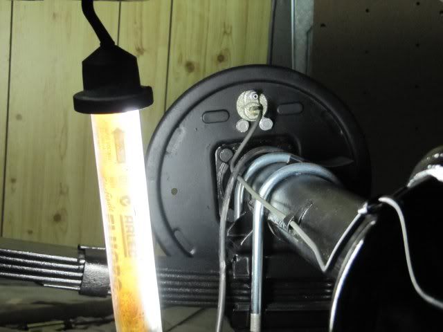

All new bearings and seals etc

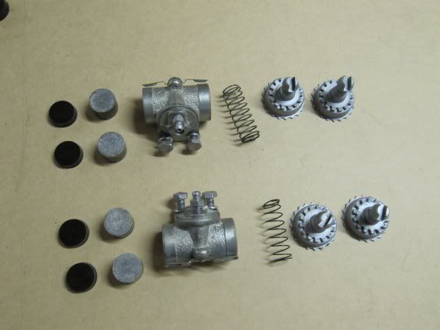

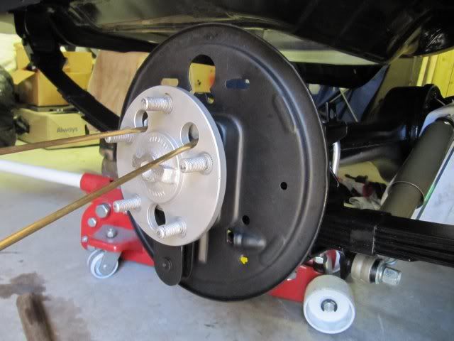

Resleeved cylinders, new cups and painted adjusters...

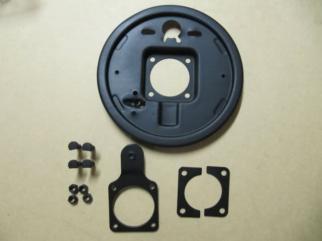

I used some rod to line up the backing plates
My son Thomas rolled the diff into place with the trolley jack and positioned it and I bolted it up. Teamwork!

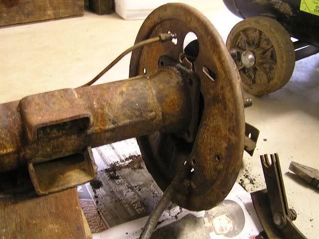

A reminder of what it used to look like...

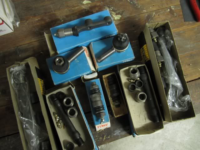

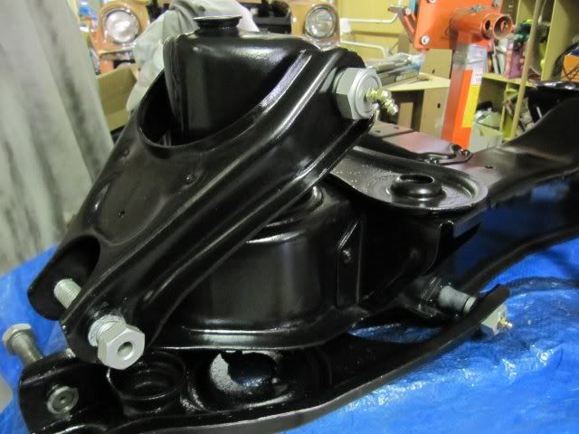

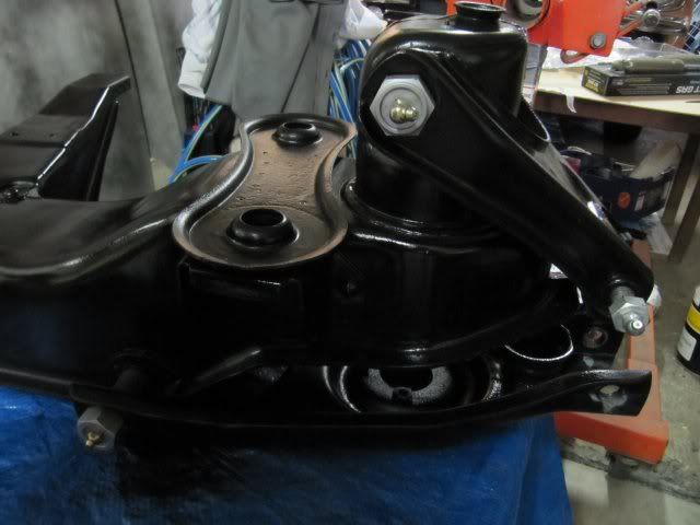

Front end was next...I've been collecting NOS pins etc for a while...
Inner upper, outer lowers, upper outers, outer inner lower upper...confusing... :crazy: :ebiggrin:
I learnt a leason here...don't fill threads with paint...it makes it very hard to screw pins in etc... :oops:
Then Thomas and I placed the crossmember under the front end and bolted it up...
