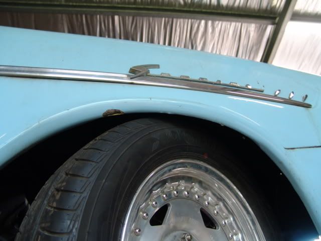

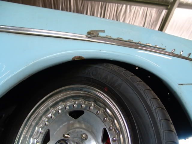

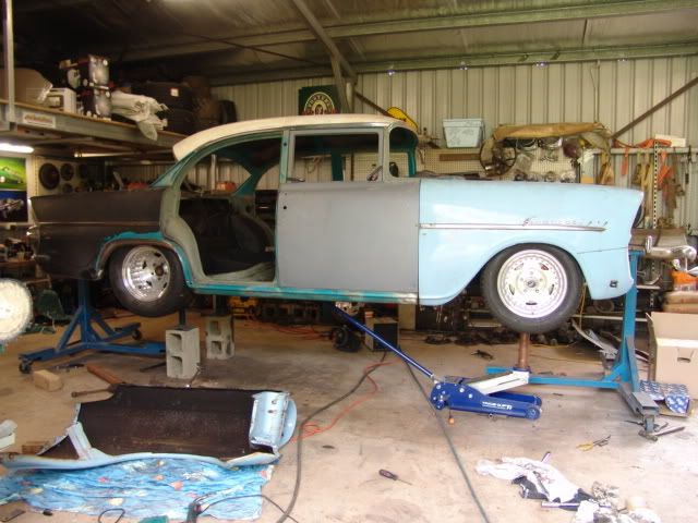

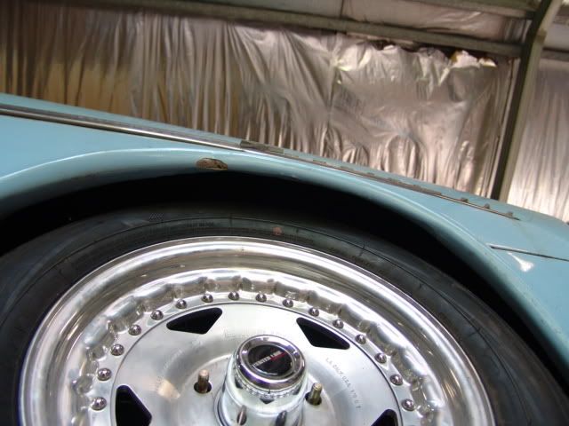

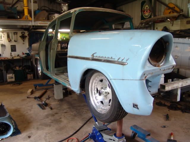

Trial fit of Torana frontend, modified P76 discs, HQ calipers and "pumped" guard. Very happy with the clearance at this low ride height (front 2" lower than rear, should be a good stance). Have to keep reminding myself that these wheels are 15" which doesn't make it any easier :roll: .

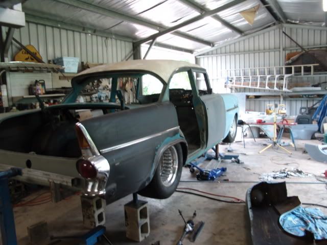

:) The peice that you put above the rear end that has clearance for the diff, the photos dont show the shock mounts only small holes shouldnt there be some strengthening there as there is lots of preasure from the vertical movement from the shocks .My floor tore around the original mounts when I had similar coil over shocks I had to weld 1/8th plate there to stop flexing

No probs :roll: ....... top shock mounts aren't even in yet, trial fitup was to measure for the best position and fab the top mounts, will post them when done. Also had to do this "prefit" to double check the best way to run the exhaust (on the inside or outside of the coilovers). Also had to check for the exhaust clearance on the fuel tank at the same time, it's all good :D :D :D

EK283, yes the guard lip is rolled, but not flattened out. The Torana wishbones are alot longer than the HR items, the stubs are similar length. The "final guards" will have the lip removed, rolled and pumped slightly as I don't want dramas with tyres rubbing when we drop it down low, the guards look good with the current setup (photos probably don't really show it), I could get away with less but then it would be a case of "oh, a driveway, better be careful of how I do this so the tyre doesn't rub!!! :wink: .

Look at the "Avatar" or first pics I posted as "ride height" :D the best bit is that I have got the rear down 20mm lower and the front is actually 35mm lower than the first pics posted and the avatar pic (which was just the body suspended and the wheels attached to thin air!!! :lol: :lol: :lol: :lol: ). Very happy with the end result! :D :D .
