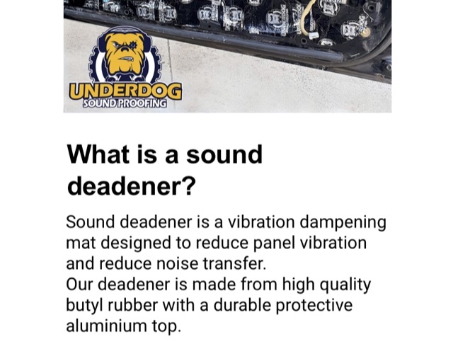

Thanks fellas for the advice, I but the bullet and bought 2 rolls of this stuff.
Works out to be $120 delivered which is way under half the price of the dynamat for the same coverage.
I guess time will tell what the product is like but I’m sure it will be absolutely fine

There is a subtle difference in some of the cheaper sound deadeners. The expensive ones use a butyl material. It sticks, and stays stuck. It is pretty impervious to heat, just like windscreen sealant. Some of the cheaper ones use bitumen type backing. It sticks too, but can melt and ooze a bit under heat. Not a big deal on the floor, but would be nasty under a headliner.
To guard against this, its a good idea to cover any joins between the deadener sheets with ally tape. Get some from Bunnings: https://www.bunnings.com.au/weatherproo ... lsrc=aw.ds
The ally tape also covers the sharp edges of the joins. Not a big deal once the carpet is in, but if you are going to be rolling around inside doing wiring etc before the carpet goes on the edges can be nasty.

Cheers Harv, I did it know what the hype about Butyl was all about until you just broke it down for me.
I double checked the website and they claim that it is Butyl so I should be right to stick it too the roof.
Feeling much better knowing the other boys have used it too!
