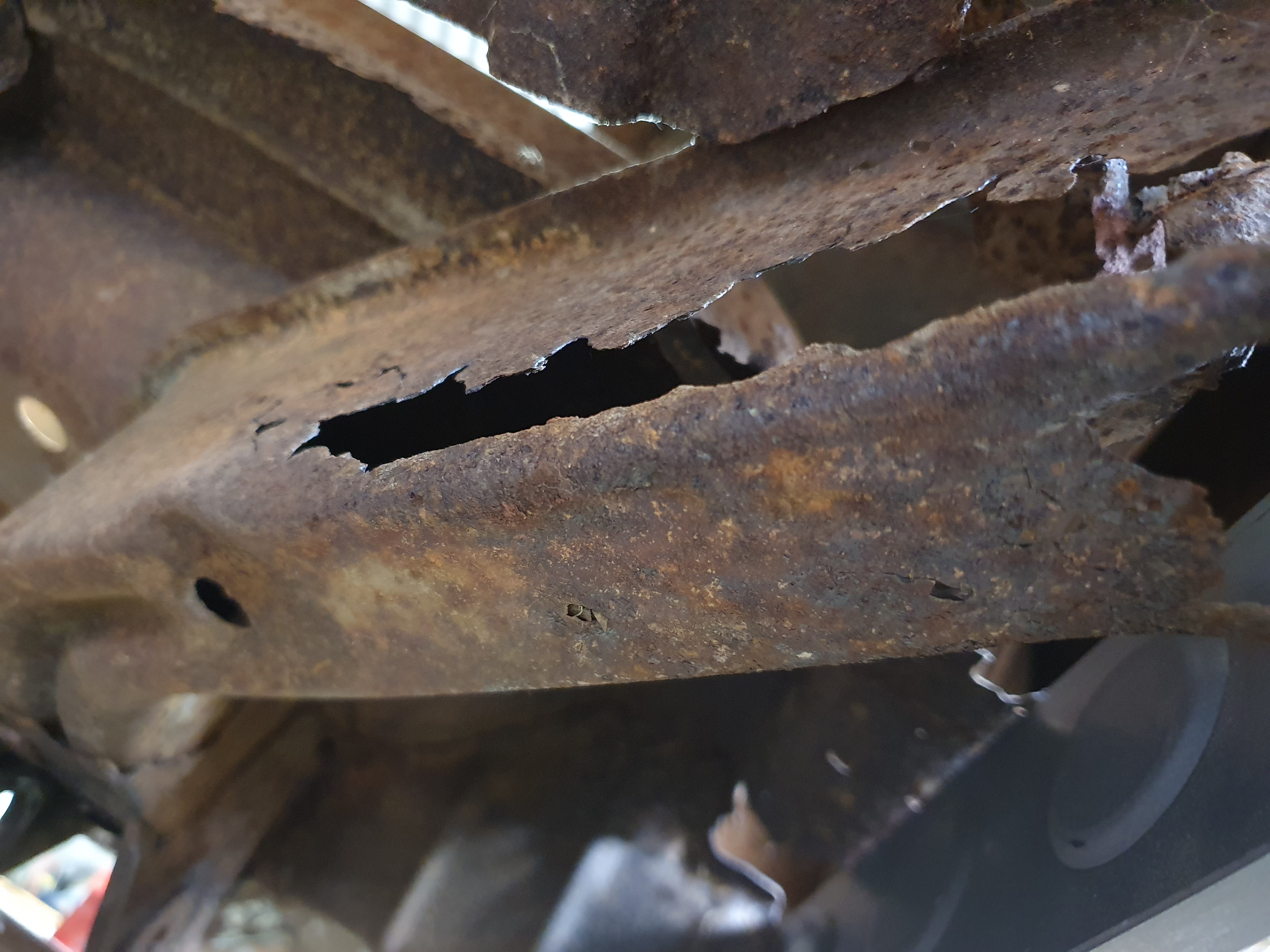

A bit of experimentation this morning on those curved rail sections. Not exact with the look.
Posts: 2523
Re: Project 2.
A bit Mad Max ish at the moment but with a bit of caressing with the grinder they should come up OK. Hopefully the humps and curves are close to the original.
Fully closing them in might be a mistake but can't be worse than the original design. Maybe a drain hole at the lowest point once installed.
