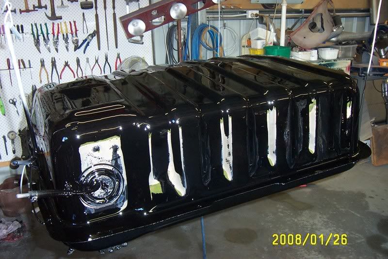

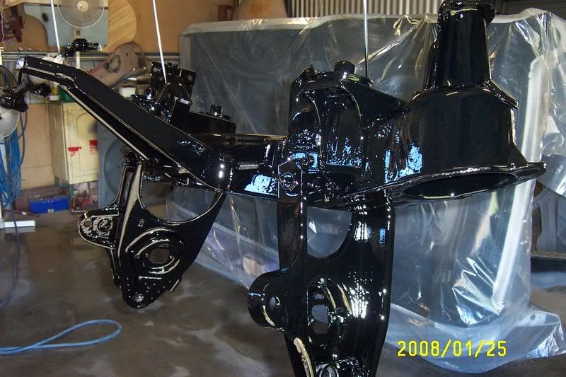

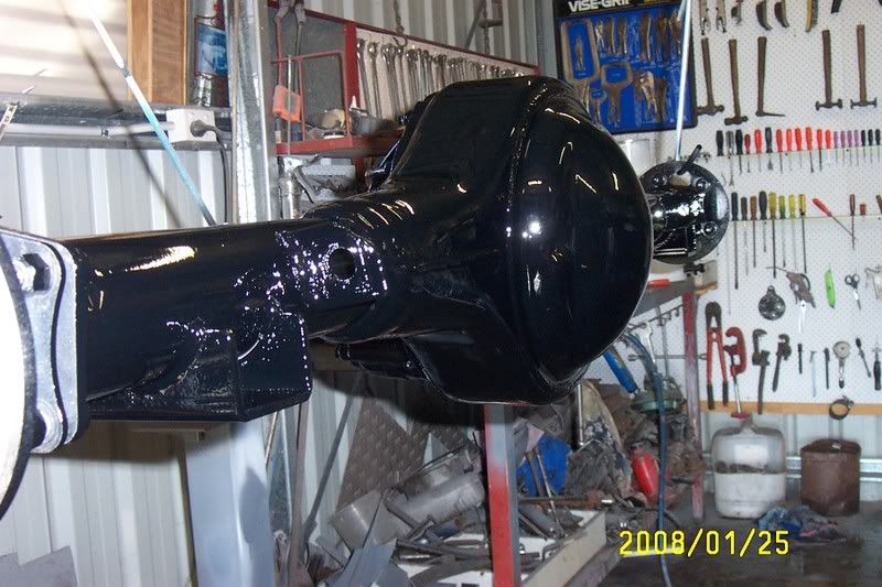

Hi guys, well the end of my 5 days off and I'm happy with what I've done in the shed :shock: . Actually a bit glad to
go back to work for a break. :roll:
As I had hoped I got the subframes, diff, all front & steering bits and brake stuff painted as well as the fuel tank.
I decided to keep with the black subframes as I want to keep the car
as original as possible :lol: :lol: :lol: :lol: :lol:
I also got the firewall, dash and door openings all rubbed down,
seam sealed and ready for some topcoat next weekend.
(all going well)
Malcolm W.

Nice work Mal,
Does this mean your not going to body deaden the outside of the subframe front and up in the guards ?
I was thinking this area still cops the stones and road muck.
How did you prep the tank for paint ?
I guess another 4-6 weeks and you would be close to finishing.
Mate the end is really near.
Malcolm
Posts: 709
Location: Gympie
Progress
Post by Malcolm »
Greg,
I did think about doing the outer subframes but :?, just decided on only doing under the guards with the stoneguard and painting it the same as the floor. Also going to stoneguard the front of the door pillar (under guard section) where it will cop a bit of a caining as well.
With the tank I just took it back to bare metal, etch primed it and did a wet on wet with 2 coats of primer, let it dry for about 45 minutes then 3 coats of the black 2pack straight over it.
Malcolm W.
