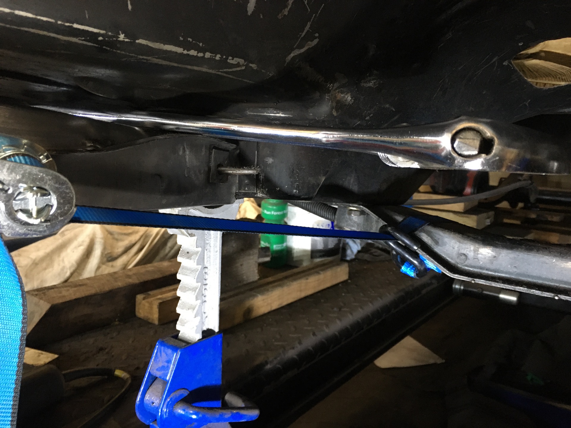

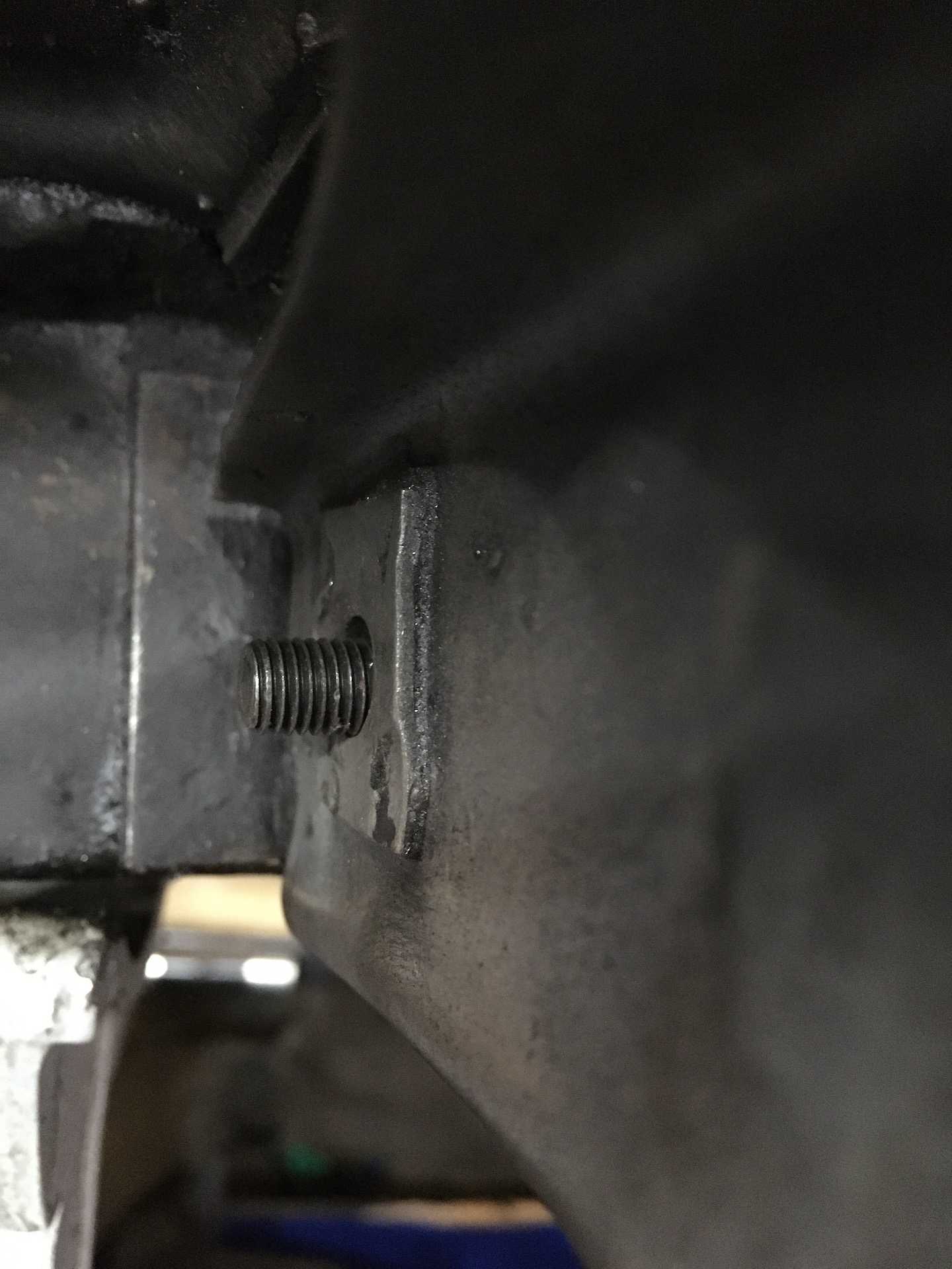

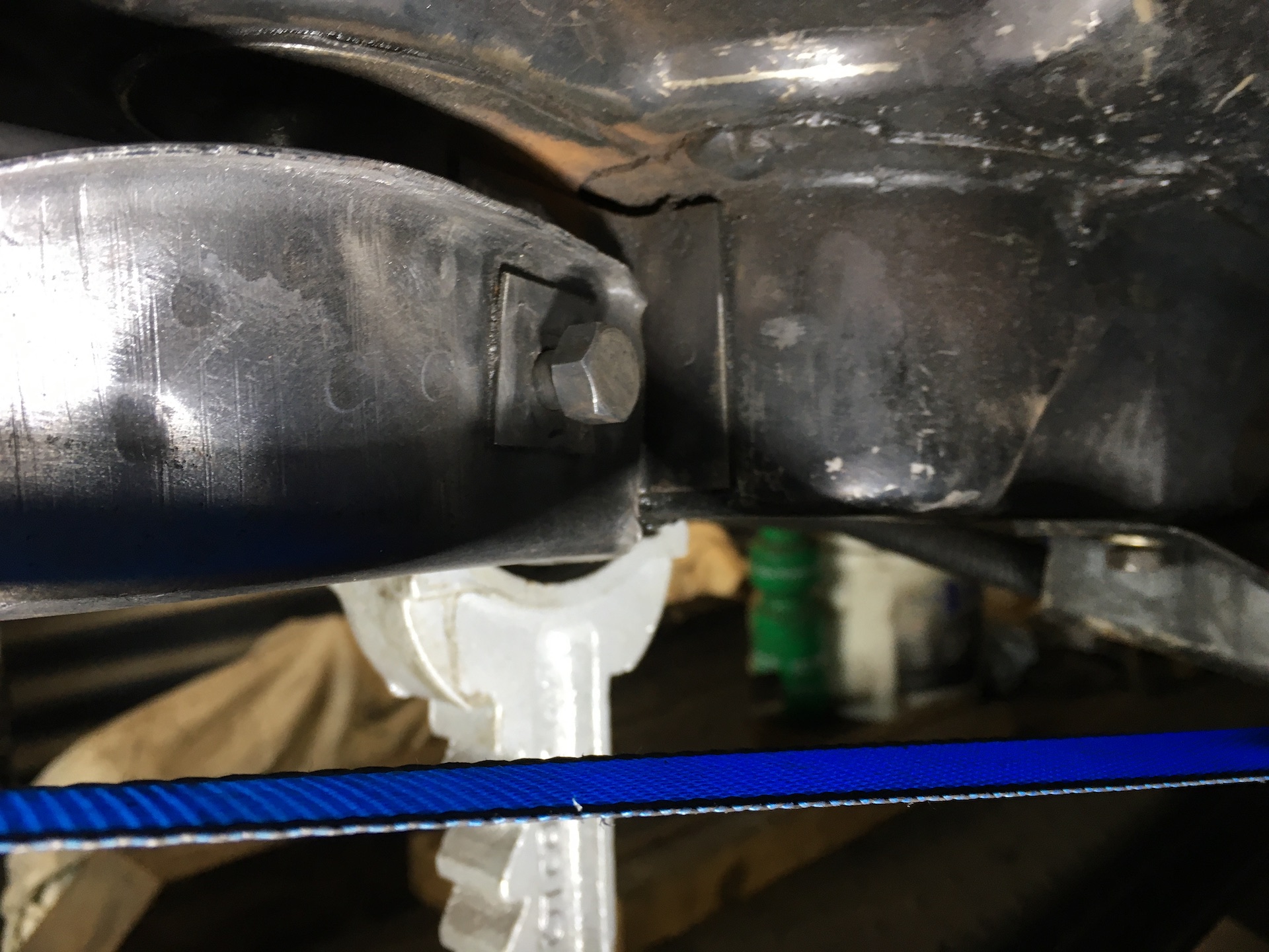

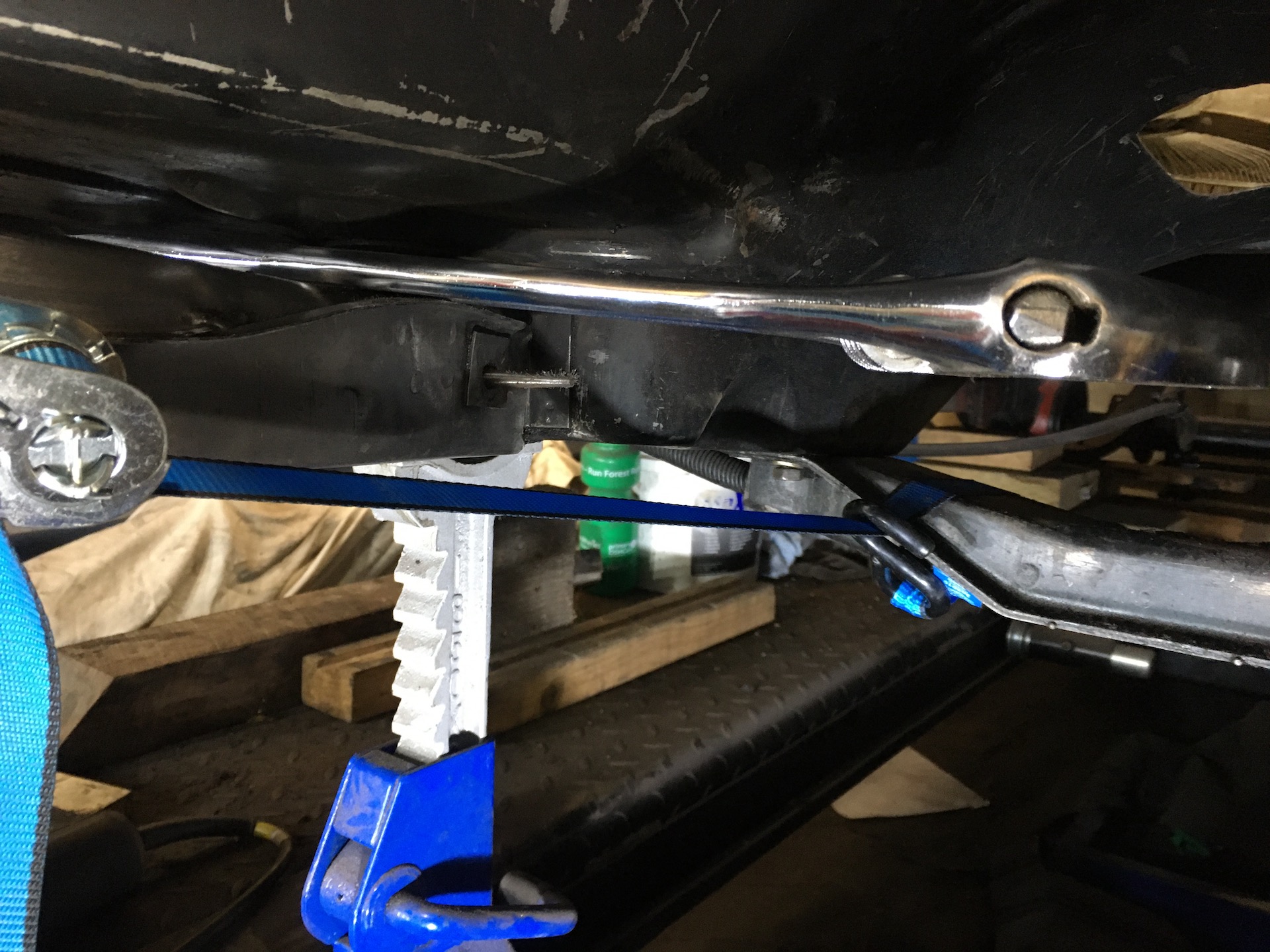

To drill the holes for the wings to bolt to the firewall I have to fully fit the sub frame. Which means getting all 4 bolts in the legs of the sub frame, and the two tapered bolts that screw the mid point of the verticals to the firewall. All these points did not change in the resto, though a lot around the verticals did. No amount of hammering/grinding /bending or swearing would get the necessary clearance to get the inner drivers side bolt in. Just could not work out a way to get the whole frame to move in 5mm further.
So after 4 attempts and several hours doing my best Catherine Zeta Jones Entrapment impressions, took the sub frame off the stands, and tried to get the bolts in with the subframe lower at the front, then tilt it up into position.
Found a few more gotchas in this lowered state (remove/bend/grind/refit), but with a ratchet strap, hammer, and long punch, finally got it lined up.
And because I was so pleased with myself, I took a phot with the bolt in.
Well almost
The bolt is sitting low and for now that is the best I can do.
My solution for locating and fitting the outer bolts was pretty simple
But can't do that with the inner.

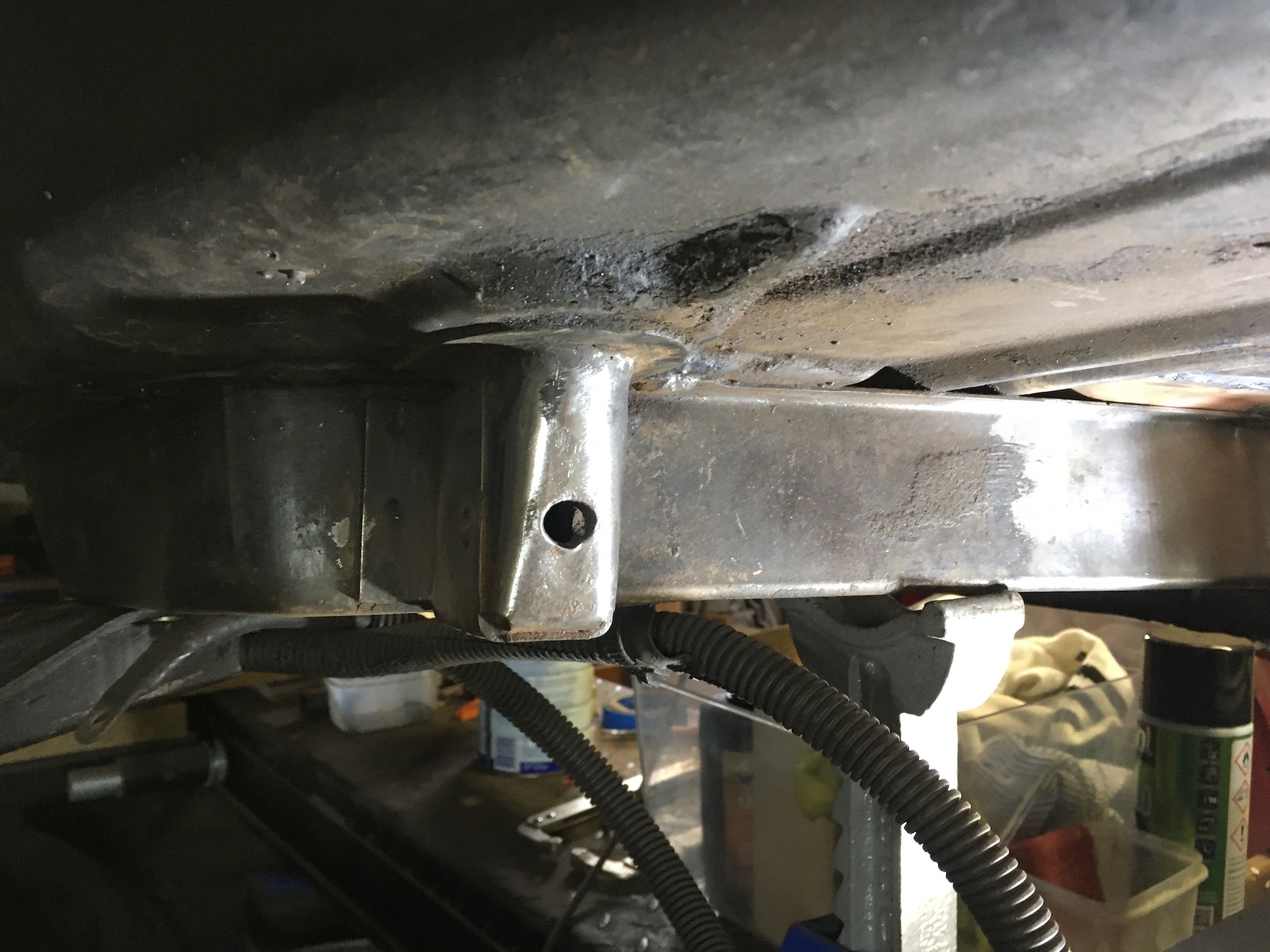

And as I stared at it for long enough, was the hole in the centre of the mount used during manufacture? Can't think of another reason, except to let water and dirt in.
Scott
Posts: 2542
Re: Ol' Rusty - FB/EK Sedan
Hi Scott. Those holes and gaps are part of the Holden Planned Redundancy Program (HPRP). They are strategically placed so as to collect dust and water to make a rust generating poultice that gives the cars a 10year lifespan. Fuel companies had a share in the HPRP as well, with 30 kg of fine dust adding to vehicle weight and increasing fuel consumption.
I have been amazed at how many containers of dirt have been held in chassis rails, k frame arms and supports, crossmembers and sills of my current project. Rails were full from one end to the other. In Wilma everything was sealed and I will do the same in Project2.
On the other matter, I reckon if your k frame bolted straight on with no difficulty at all it would indicate a problem: something must be out of alignment!!!😄

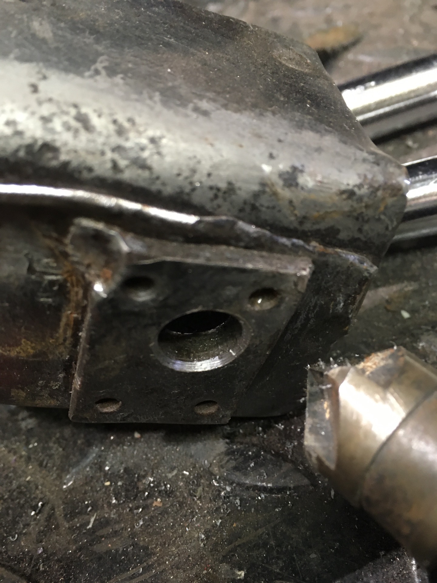

Next job - fix the captive nut. Thought about folding a sheet metal bracket round a nut but I didn't have a square nut and it all seem too hard. Instead I got an offcut of mild steel 5mm bar from the rotissery build (still a work in progress), and cut it down to fit between the ribs of the brace.
Then drilled a 7mm hole in the brace and plug welded it in . Also filled in the self tapper hole.
