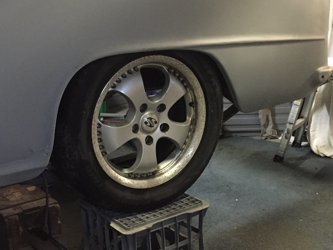

Ammo and I picked the top photo, with the grey centre in 15" x 7.
As the ute is Amoo's ride the steering needs to be lighter so she can drive it.
There is a EK sedan in Adelaide with the " salt " wheels which I like.
These are wheels I purchase way back, that fill the wheel arch nicely and are Commodore pattern, 16 x 7 with 225/ 50 tyre.
There is little wiggle room inside the wheel arch so either reduce tyre size or do the slice and dice to the wheel tub. Using these wheel my diff needs to be 1425mm. So I think I will select the wheels then narrow the VN diff to suit.
