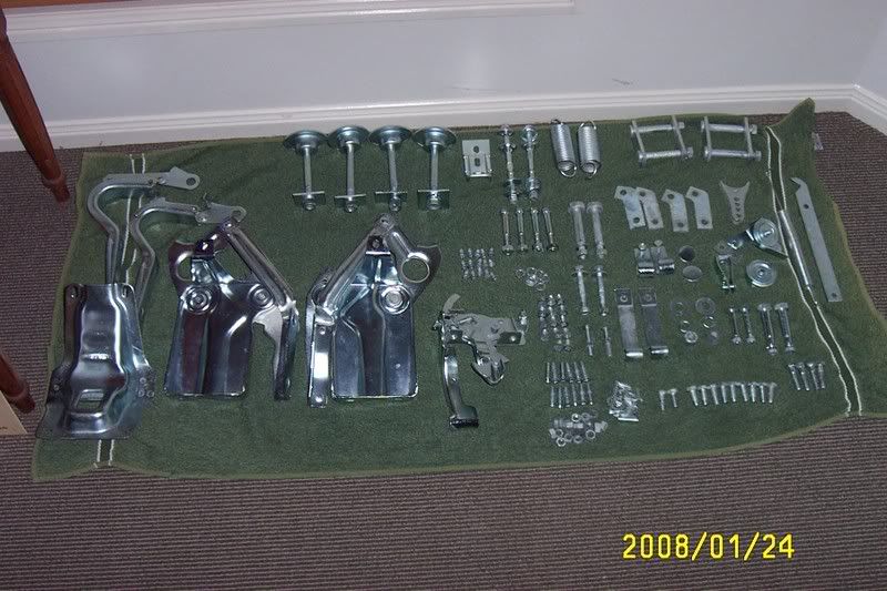

Just a couple more things, I picked up some zinc plating today :) . I
must say things in the shed are starting to get exciting. Not bad
400k round trip to Brisvagas to pick up that. :? :?
All the other nuts & bolts and washers are going to be stainless.

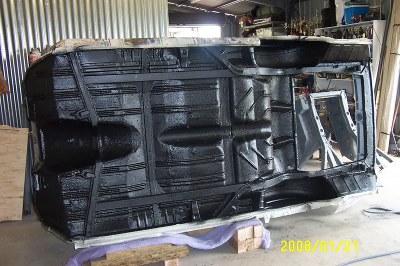

Today also did the floor and a heap of other underneath bits 2 pack
black. All the other parts I had sandblasted and etch primed, so it just
got a light scuff, and then I did a wet on wet, 2 coats of primer, wait aprox. 45 minutes
then straight over with the black 2 pack.

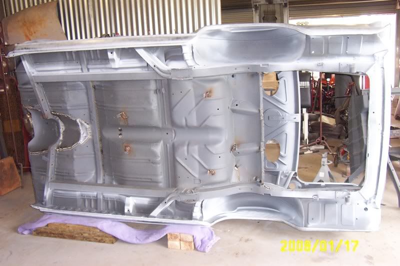

First, with the floor pan cleaned down and ready for the sound proofing.
All the seams were sealed and the bare metal covered.
Then with the sound proofing applied, this was done a couple of days
ago giving it time to dry out properly after application.
Then the 2 pack black after being sprayed on. Photo's are pretty hard to
show how it came out. I'm happy with it. :D
Hopefully tomorrow I will get the front end, diff, fuel tank painted in the black also.

8) Mal, roughly, how much did the zinc plating cost and what time span did it take and what prep did you have to do to the goodies. Also where abouts did you get it done.

Dan, the bits you see in the photo cost $265. All the parts I got done I just degreased, they did the rest. All my plating is being done at Pine Rivers Electroplaters, 3/23 Paisley Drive, Lawnton Ph. 38812018. A mate of mine out here has an old Caddy he done up, he used them to do all the chrome on that and it looked shit hot. The zinc only took a week to do, chrome work is about 4 weeks wait.

The quarter trim looks good mal,very clever.That will break the colour up nicely.Floor looks good sealer and paint,never thought to paint over sealer.

a very thorough job on the floors there, should last forever

The sound deadening I used is water based (paintable) and the only reason I like to paint over the sound deadening is for ease of cleaning. If you use bitumen based products on the underside, as you most probably know you cant paint over it and when it gets dirty its crap to clean. I'm using the bitumen based stuff on the inside of the floor for a bit more sound proofing.

Geez the zinc plating is expensive over on your side of the paddock !
I took the bits for my FB to get done and they quoted me $60 for up to 20kg of bits - whether you do one bonnet hinge or 19.9kg of stuff the price is the same so I went home and collected all the bits I could find and had the lot done - I now have enough bolts for about 3 cars.

must be a bit thick today - have id'd all your zp parts but two - those behind the hood lock plate - the have a gooseneck bend in them............. maybe mine is missing something?
Are they the boodlid hinge arms? haven't taken mine out yet if they are.......

I too thought they were a bit on the expensive side :shock: , how they explained it to me was that they wired all the pieces up instead of what they call barrol plating them, its supposed to give a better finish. :roll:

I know the bits your talking about, and so far I've found quite a few things that I've forgotten to get done. And yes they are the boot hinges, a NOS pair came up on evilbay so I bid on them and got em, cost me $18 inc postage. :D Pretty good I thought.
