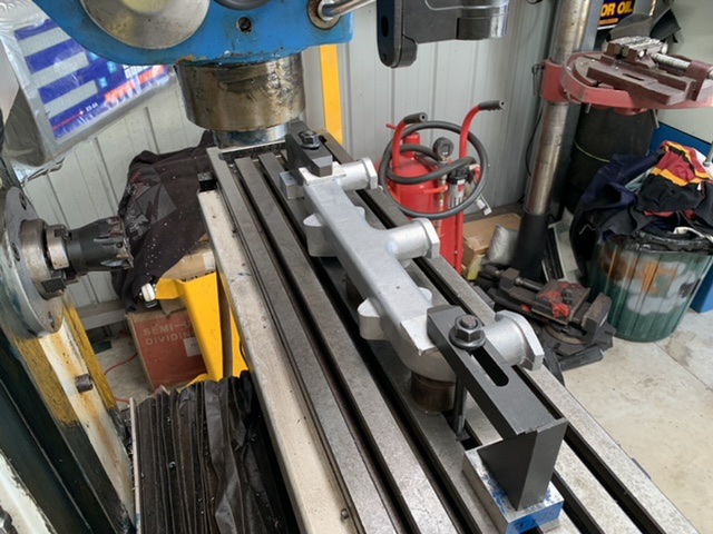

Brett you have just read my mind!
There is some good usable material to drill and tap on the manifold, stand by and I’ll keep yas updated!

Drew,
X2s used ganged shafts and W-clips to connect the throttle shafts together. This arrangement is more reliable than might appear, and if GM-H adopted it, I'd call it a vote of confidence. The extension shafts were like a standoff, internally threaded at one end to screw onto the throttle shaft, and with a shoulder to reduce the OD to the same size as the W-clip. I seem to remember that once the extension shafts were tightened onto the throttle shafts, they were then cross-drilled (across the flats of the throttle shaft) and a small-diameter roll-section pin driven through to retain the extension shafts in position. Thread-locking compound would work just as well. Since you're pretty handy with machine tools, you could make up a pair of extension shafts, and do away with one W-clip.
With a ganged throttle shaft setup you can use the original throttle linkages with only minor modifications. Cast headers (e.g. Jack Myers) clear the original linkages way better than extractors.
I have a festy old X2 setup down the back. I could post a photo of the throttle shaft arrangement, if you'd like.
Or, referring to photo of manifold in milling machine - drill through the outer stud hole of each carburettor flange and tap the holes from the underside. Machine away some material on the underside of the bosses, to make two mounting pads in the same plane as the throttle shafts, and mount the external shaft via brackets to the new holes. The best place for an external shaft is directly under the existing throttle shafts, but that's usually impossible. The closer you can get to the side of the manifold, the better.

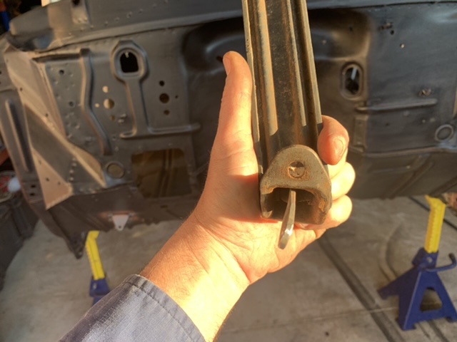

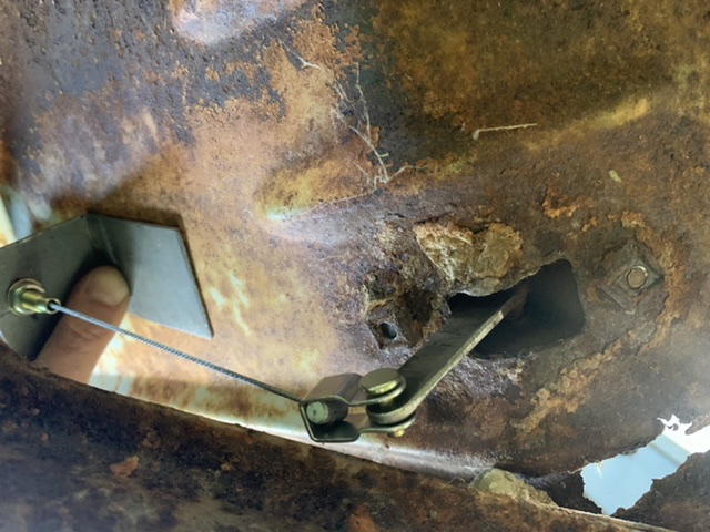

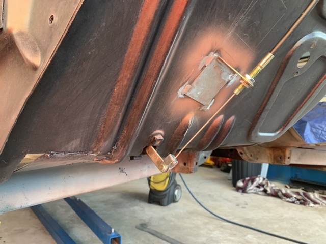

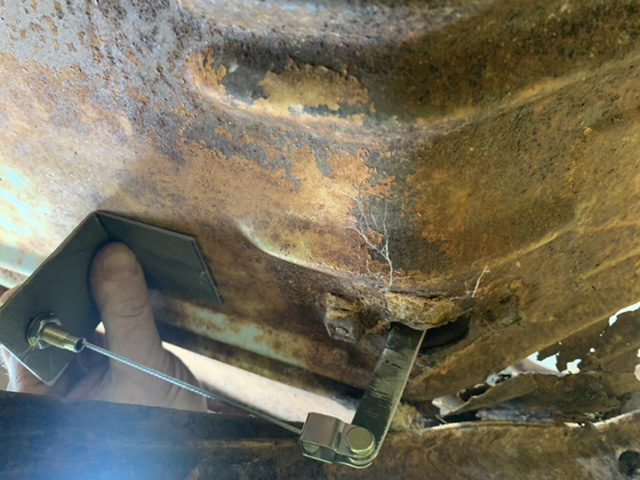

So this arvo i extended the shaft on the accelerator pedal and dummy fitted it to my garden art in the front yard.
I thought I had better check y frame clearance and I’m glad I did.
I did the extension about 30mms but in reality 20mms is a better fit.
Once I was happy with it all I welded a cable mount to the wagon,
End result is ‘so far so good’ and I can now move on with painting the firewall area.

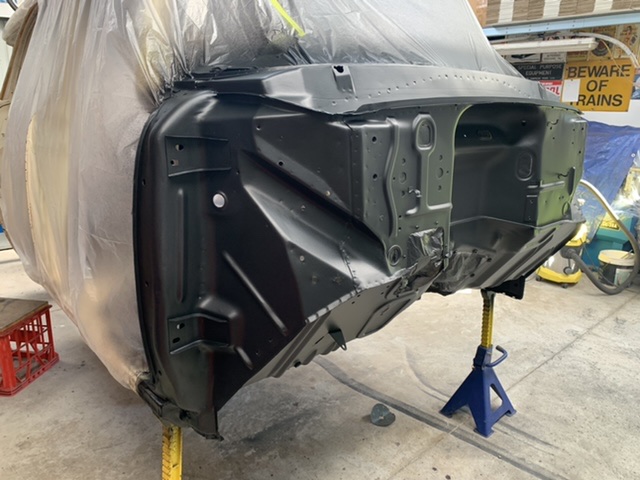

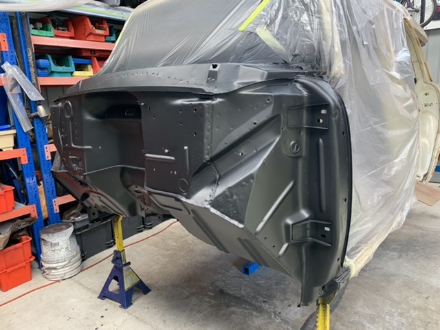

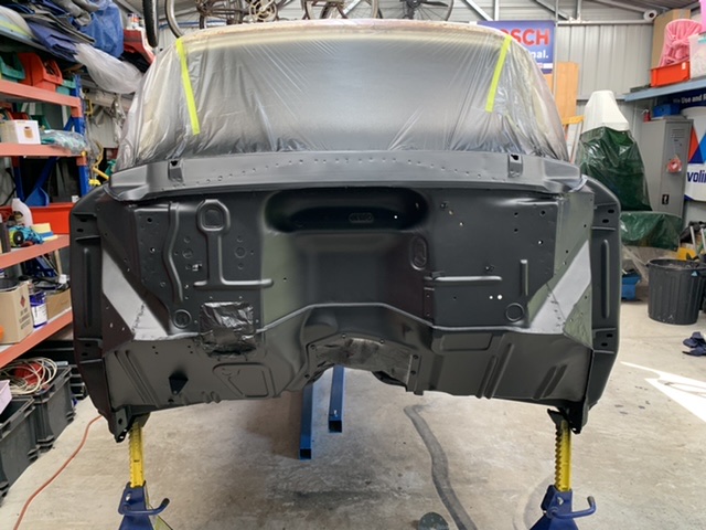

After getting tha accelerator pedal and cable mount sorted 8 gave the prepped firewall a scuff over and painted with etch primer.
This should give the protection required to give me the time to get the wagon back on the rotisserie and hit the underbody body inside and outside.
Things are finally moving in the right direction after 6-8 months of rust repairs!

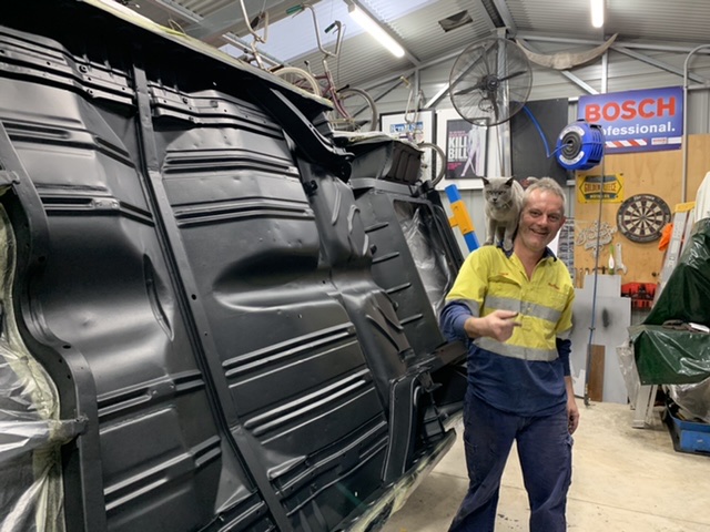

Underbody etched!!!
