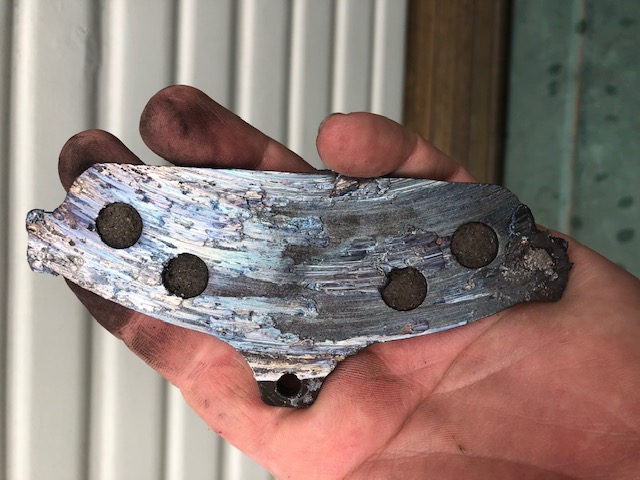

Spent the afternoon pulling apart Number One Sons VL. What was described as slight brake noise turned out to be a locked front wheel, a pad with no meat left on it, and a rotor that has been eaten on the inboard face. Piston popped out of the caliper, and outer seal damaged. Looks like new pads, caliper rebuild and new rotors.

For Sale: brake pad, suit VL Commodore. One careful owner, only driven on weekends. May need rebuild before use. Will trade for a blown H4 bulb, or stripped 10mm bolt. Can supply matching rotor for extra. Wiling to help with delivery (as far as I can throw it). No offers, no time wasters.

“No Dad, it wasn’t making any noise for a while... it just started”. :lol:

At least he got his money's worth out of them. 😂

I'll swap you a set of broken grey motor piston rings. Or three-fifths of a fibre timing gear.

ardiesse wrote: Sun Dec 01, 2019 8:25 pm I'll swap you a set of broken grey motor piston rings. Or three-fifths of a fibre timing gear.
That sounds like a deal... I think I have the other two fifths of the timing gear to make a set. :ebiggrin:

Thats at least three months lawn mowing there!
