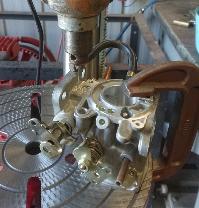

Swapped down to twin 1 1/2 Su's and did some rework to the throttle as I wasn't getting full throttle and it was touchy to operate at slow speed. It still uses all the standard throttle set up but now runs cable and rollers to a cam lever on the throttle spindle.
The carbies were later HIF Su's with emission set ups and the vacuum take off for the distributor advance is not in the correct spot for proper ported vacuum so that had to be redone. Removed all the carbon canister tubing, plugged and drilled out other ports, and bashed out another set of filter covers (Still to be polished). Annoyingly I will have to replace all of my vacuum tubing for the wipers and washers. The quality of rubber these days is crap.
