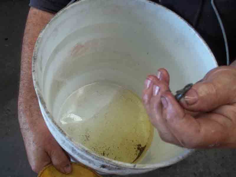

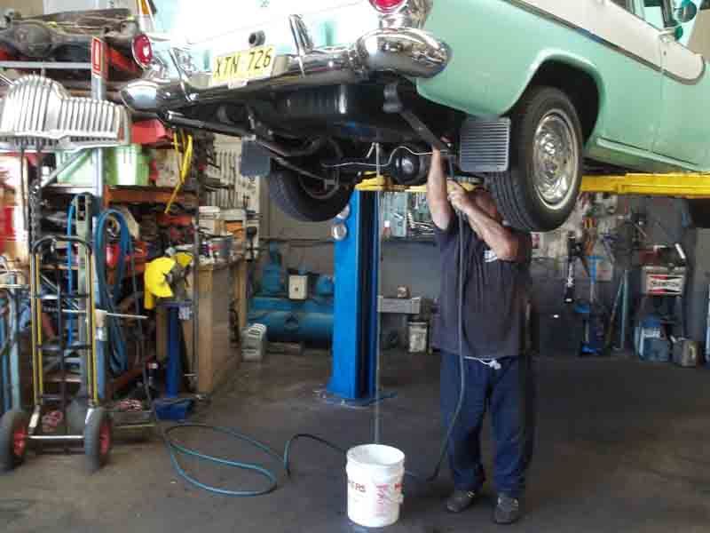

So after putting up with the fuel delivery system shitting it's self every so often
I bit the bullet and had the lot dismantled and cleaned to find out what the problem was... :(
Milkshake would run great until the fuel level dropped to a certain level then play up, somewhere between 1/4 and 1/2 full... :?
So all the lines were cleaned and the compressor pumped up and the gun stuck in the pipe and blow!
She was pumping until I though my fuel tank was going to explode... :o
THUMP...Something let go and a tube of fuel spat out the inlet at the back!... :shock:
So you can see by the pics what we found, a garden lizard had somehow got into the tank? :wtf:
Looks like it was floating in the tank until the contents reached that level were the pickup tube sucked it in.. :crazy:
The tank was clean when we put it in so only god knows.... :lol:
And before the peanuts ask, yes it was dead....... :lol:

how do you know it was dead??? .................................... it may have just been out of petrol :lol: :lol: :lol: :lol: :lol: :lol: :lol: :lol: :lol: :lol: :lol: :oops:

You idiot Mick :lol: :lol: :lol: :lol: :lol: :lol: :lol: :lol: :lol: :lol: :lol: , he was probably flooded !!!!!

My auxiliary tank on the land cruiser had the same problem, back in the seventies.in this case it was a sharp stick though. It would float around until about 1/4 tank and then get sucked into the outlet pipe. I put up with it for about 12 months before I found it. If you had told me the symptoms, I probably wouldn't have remembered though.
