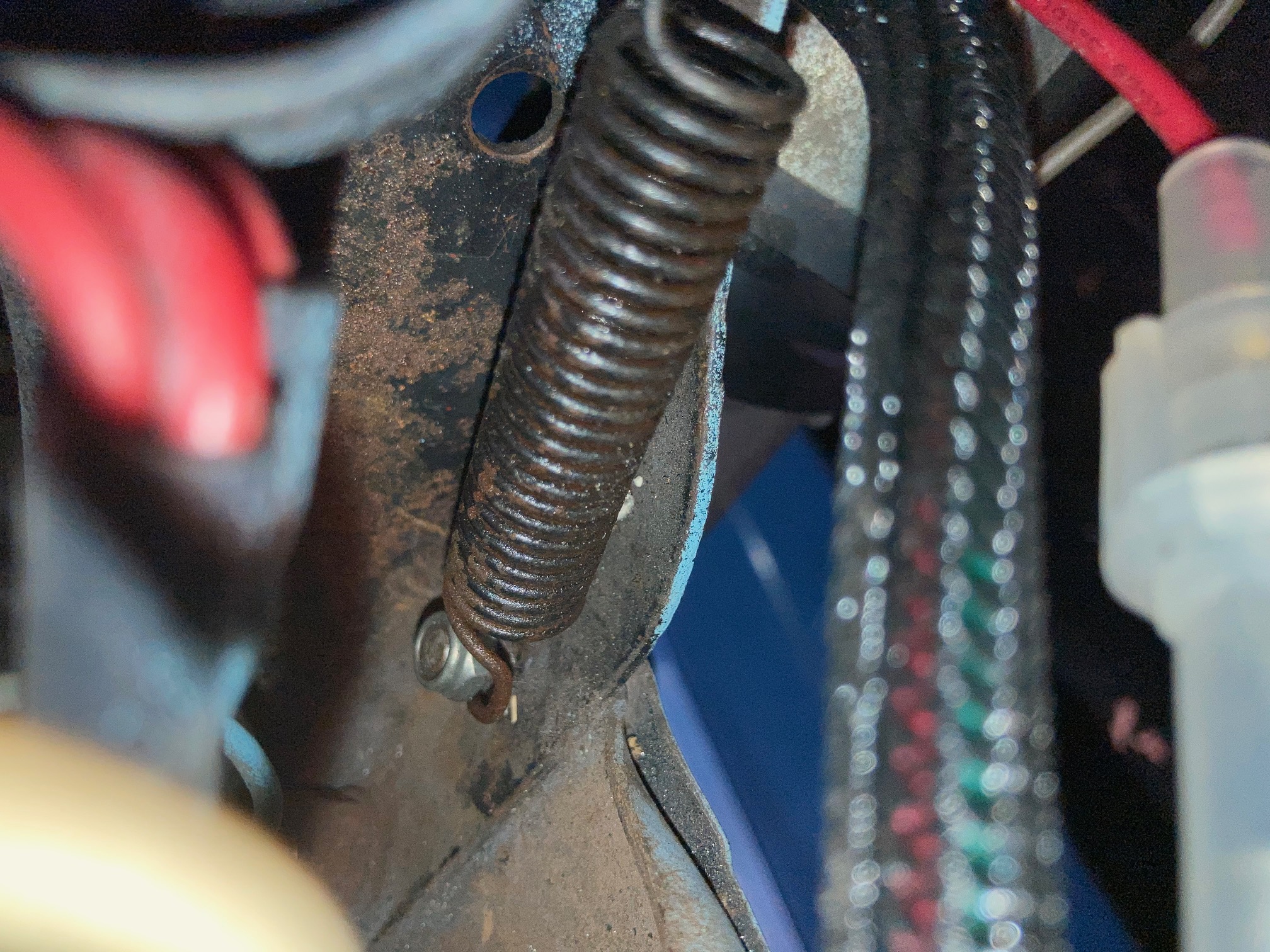

Ok, help please!
Trying to fit brake pedal return spring. I found the remains of original one on the clevis rod pin and replaced with one from a spare pedal box.
Just can't work out where the other end attaches.Image

Posted: Tue Jul 06, 2021 4:56 pm
by Brett027
I'd be interested in that one too. It's somewhere in bottom of dash I think, but mine is not right either currently.
Posted: Tue Jul 06, 2021 5:42 pm

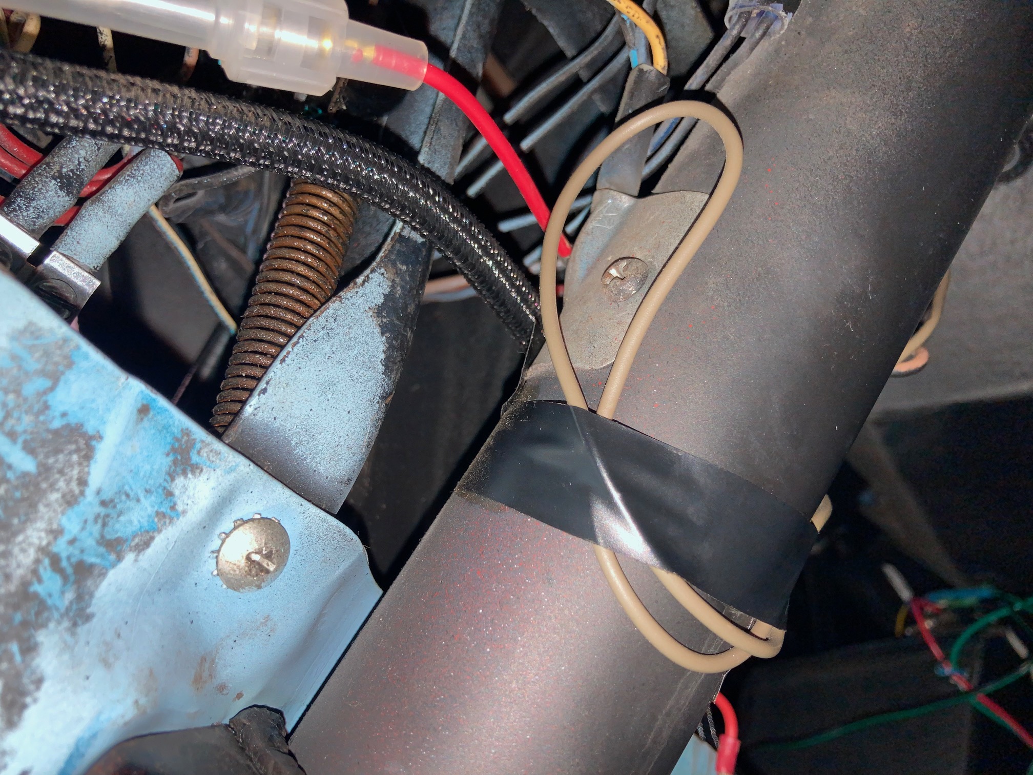

by Rev Tex
Hi,
Not sure if a manual sedan is the same, but mine attaches to a bolt on the bottom of the dash. I've attached photos.
Looks like the same bolt that secures a cross member.
Iain

Posted: Tue Jul 06, 2021 6:14 pm
Rev Tex wrote:Hi,
Iain
That is just what I was looking for, and makes sense. Much appreciated Iain.
Clay
Posted: Tue Jul 06, 2021 6:39 pm
by Brett027
Yeah that's where mine is too but I'll have to sort it out a bit more. When I push the pedal, the spring is scraping on the dash. Longer bolt to lift it a bit may be the fix for mine.
