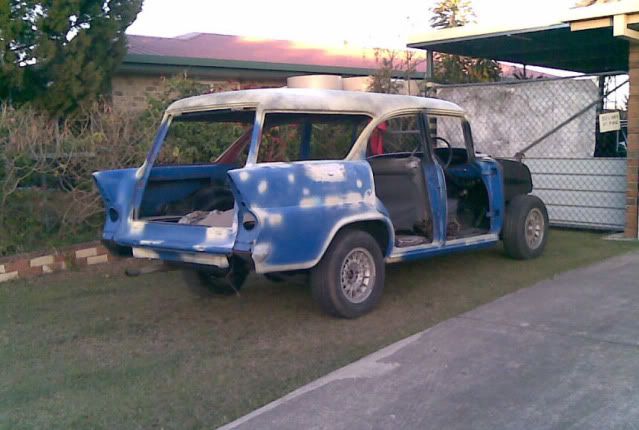

Back on the wagon rebuild. :D :D
Getting the body ready is taking a lot longer than expected. :cry:
Mostly getting rid on small dents that I keep finding.
I think I have them all now, but I've only done the frame.
Still need to do the doors, guards, bonnet and tailgate panels. :shock: :shock: :shock:
Sand, check, hammer, fill and repeat.
Over and over and over again.:shock: :shock:
Also thought I'd throw up a pic of the front windscreen area that I have been working on.
Cut most of it out, Rust..............
Welded in new sections but didn't make them exactly to shape.
So have been molding the area with fiberglass and fiber filler to get the right shape.
Almost right, just need to do final checks.

Was hoping to get undercoat over the rest of the body today.
Still going with body preparation. :evil: :evil: :( :(
So many little things to get right. :cry: :cry:
Thanks Tim, I hadn't even filed the filler back in the previous photo. Have now done the final preparation for the front window sections.
Also started to clean up the rear bumper bar. :D
Will do the rest during breaks, waiting for something to dry or set. :(
A bit of pitting on these, but they will be OK.

Still working on the rebuild / resto /custom /strip down....
Each time I think I'm ready, I find something else.
All the dash removed, so can undercoat the whole lot in one go.
Took a while to get some off, and then back behind the dash so it can be started and driven.

Ready to get the rest of the body sanded back smooth..........
Feel so much better knowing that it has some skin over it at last.
8) 8)
Still some more work to get everything straight.
Sand, check, fill, paint. Sand, check, fill, paint etc, etc.
