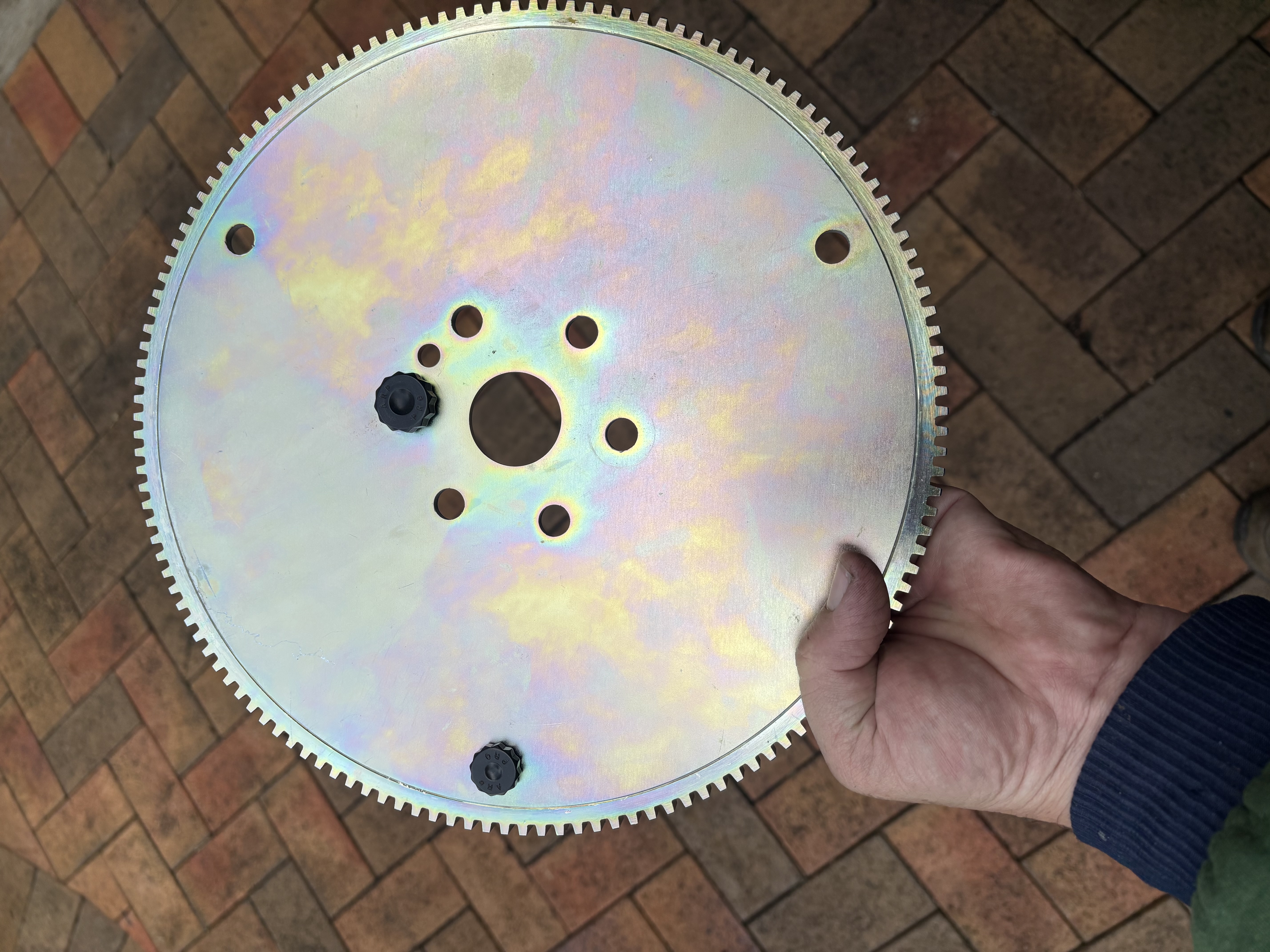

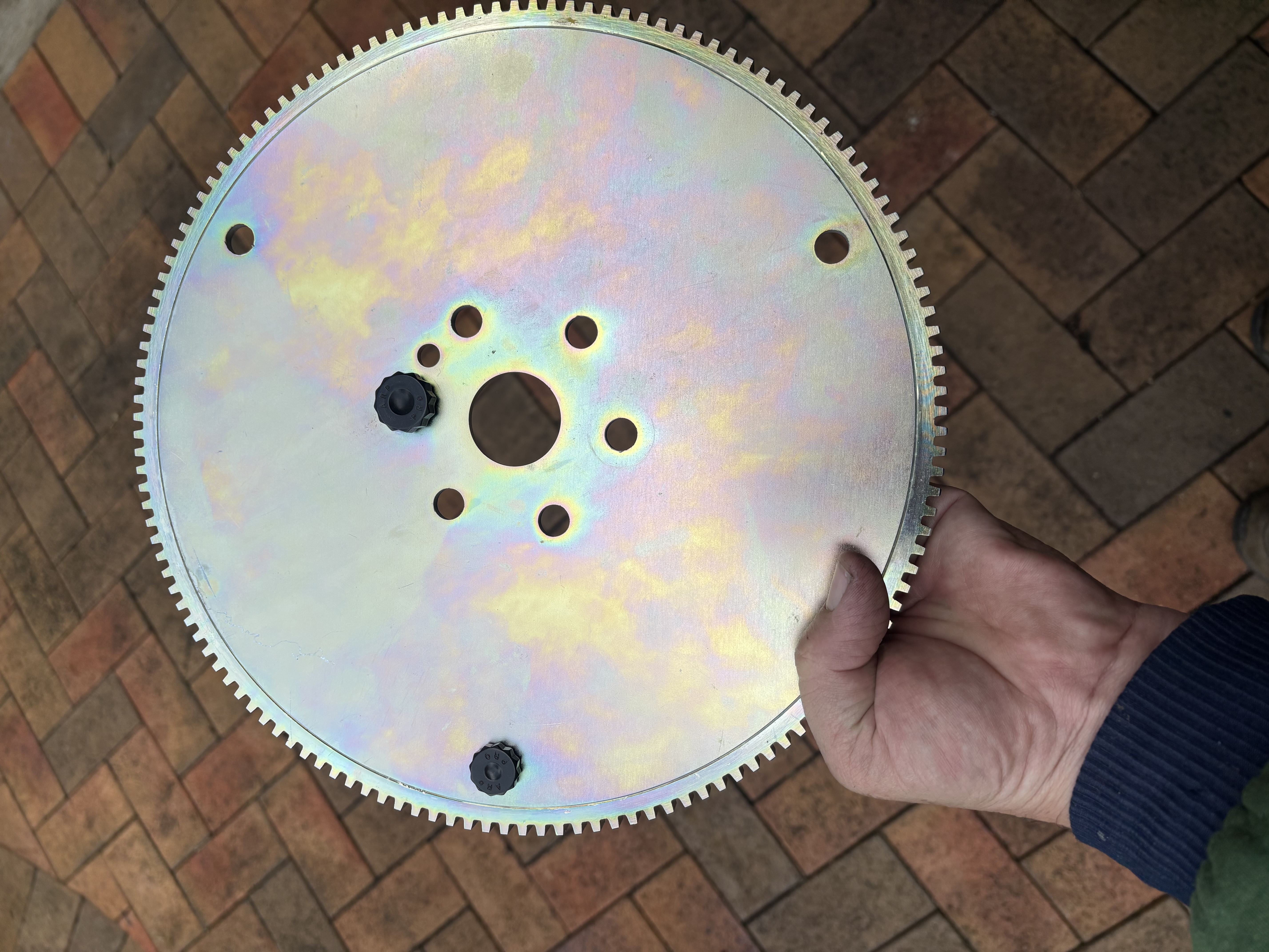

Spigot bush showed up, so got ready to put flexplate on. Bolts are ARP 200-2902,7/16 UNF with a fancy big head on them. Checked the instructions, and they get red loctite, a smear of lubricant under the head and leaned on to 85ftlb. The instructions also have a warning to make sure the flexplate holes are chamfered as the bolt head has a radius. Checked, and they are right. Time to bevel the holes, bevan.
Interesting that their torque converter bolts (shown in the wrong side of the flexplate below) are the same thread but smaller head and not chamfered.

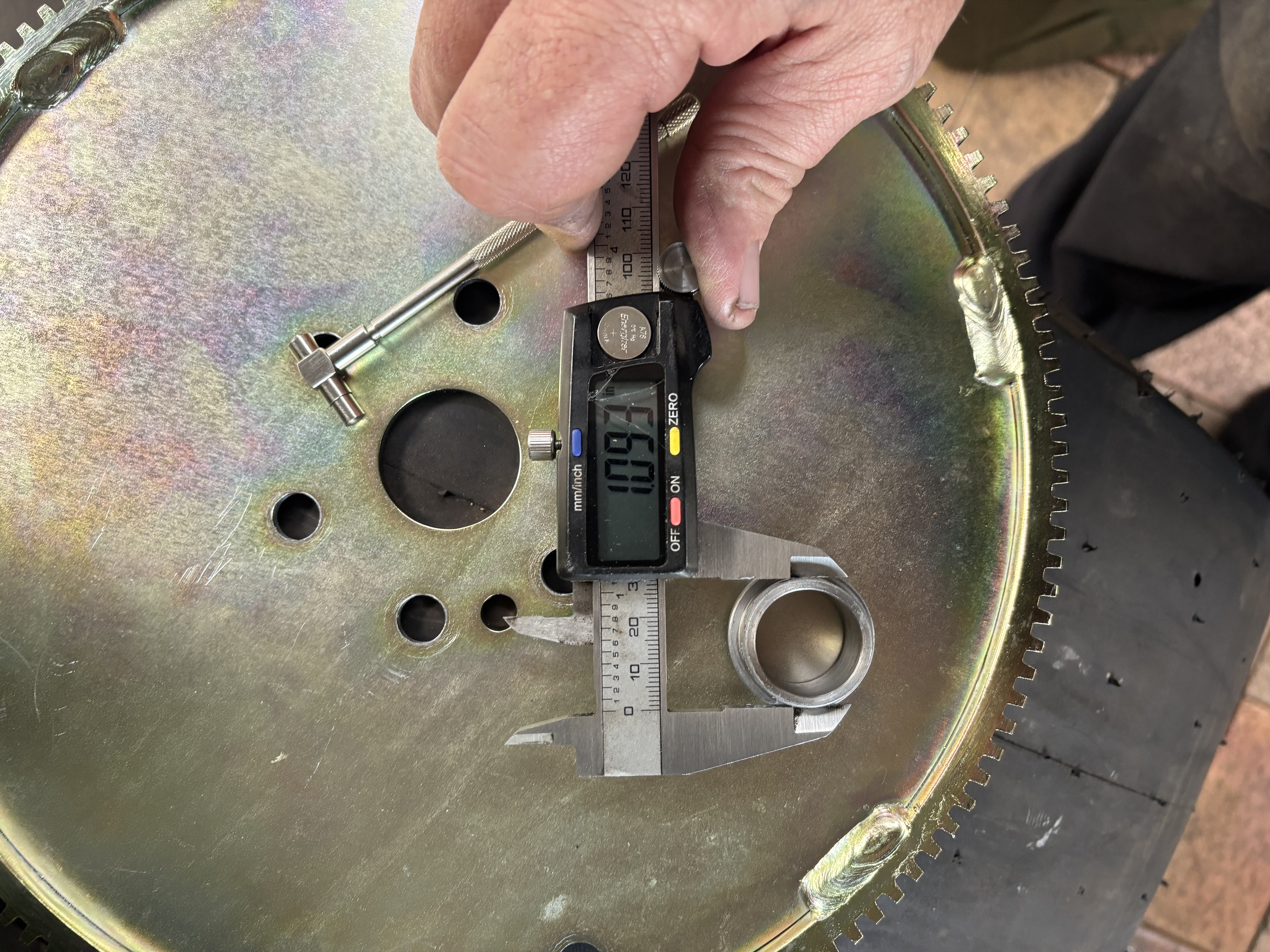

Checked the spigot bush on the flexplate, all good. Greased the spigot and went to fit into the crank, and no joy. Murphy struck again. Spigot is 1.093” according to my well-abused verniers. Crank bore is somewhere between 1.077” and 1.084”.
I don’t trust my bore gauge, as it lost its little spring years ago. Will need to buy another one to measure the crank, then get the spigot machined to suit. Anyone interested in a small lathe job please?

Wondered if I got a dodgy spigot bush, or if the crank is not right (hoping the bush is crook so I can get another off the shelf). Red motor crank bore is not an easy number to find, but Dellow reckon that their bushes are 27.8mm OD:
https://dellowconversions.com.au/produc ... ot-bush-2/
That converts to 1.094" in old money... my AussieSpeed spigot bush is 1.093". Looks like the crank is the issue. Not keen on removing the crank, so skimming down the bush is the way to go.

I am fortunate to have met some truly incredible people in this hobby. A phone call, a connection made. A top fuel team, madly prepping for the Winternationals in a fortnight’s time, stopped what they were doing and machines down the spigot bush. Truly grateful.
