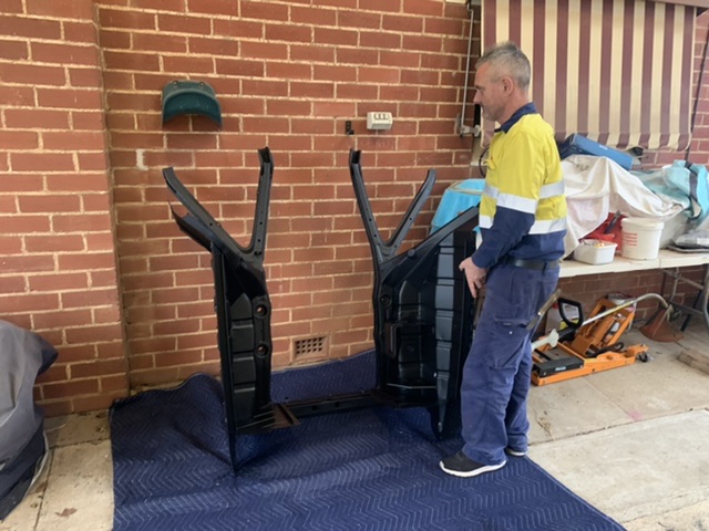

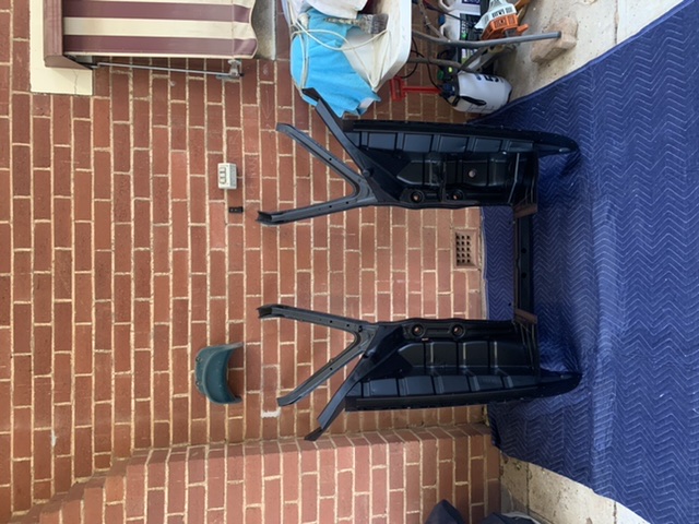

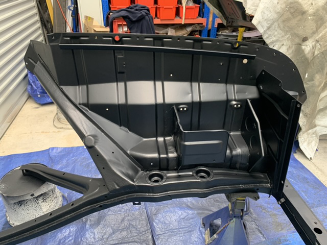

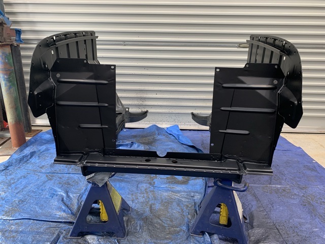

Well I had a few beers and a night off last night.
Y frames finally out of the shed!
The final coat in GMH black certainly made it look the goods.
But geez that Nitro paint is bloody toxic, glad I had a good mask
Drew
Posts: 11639
Re: FB Standard Wagon
Top work mate
Posts: 2700
Don't forget to treat the inside especially since you had it in the tank to strip it down.
Great work Drew.

EK283 wrote: Sat Aug 14, 2021 7:21 am Don't forget to treat the inside especially since you had it in the tank to strip it down.
Great work Drew.
Nah mate I haven’t forgotten.
Penetrol for the win.
Drew

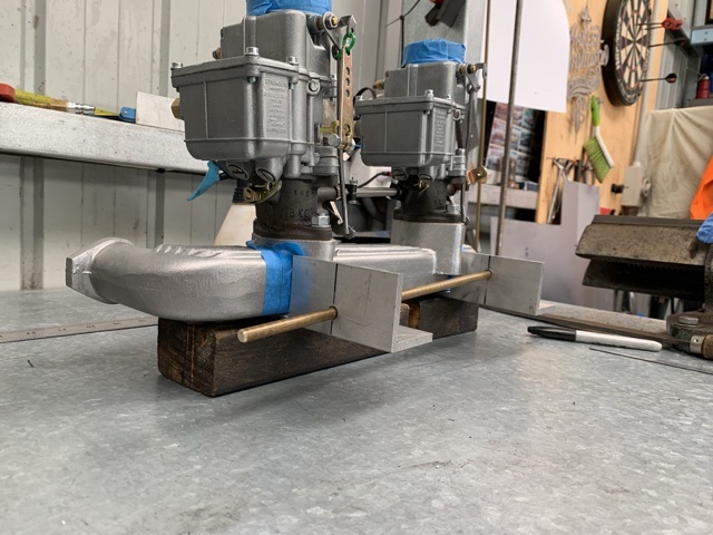

So I am at the point of prepping the firewall to refit y frames and I need to be thinking ahead to an accelerator cable set up for the twin carbies.
The twin carbies have a Center throttle shaft which I have read that is unreliable as it can become loose and the carbies go out of sync.
My FIRESTREAK manifold does not have external lugs for an external common throttle shaft so I am planning on planning on how to get it made to suit my needs
It’s a shame to modify this manifold but it is all I have got to work with.
Any suggestions on how to attack this job will be appreciated
*photos of brass bar is a dummy up to give me ideas only*
Drew

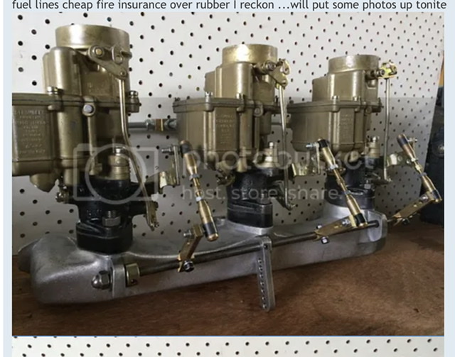

This photo of triples has the linkage style that I hope to achieve
Drew
Posts: 2523
Hi Drew, I haven't done this job yet myself, but have a set of twins to go on next car so have an interest. Would it be possible to use to the outside carburettor mounting bolts with a bracket that fits against the manifold? Also, I'm thinking there is no reason not to thread a hole or two into the manifold to use as bracket fasteners.
I will watch with interest😀
