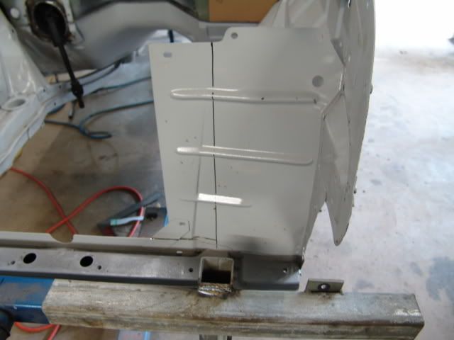

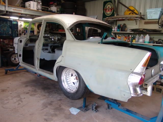

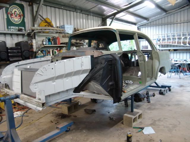

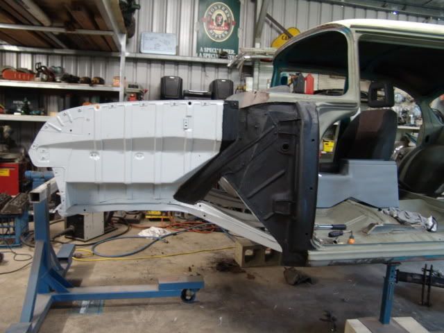

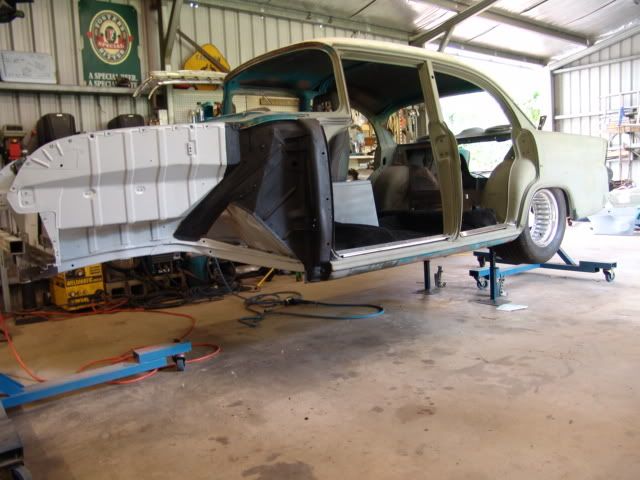

Bit more done, rust on front is repaired and back in place. Give everything a good coat of fishoil and then a few coats of underbody deadner before and after assembly. Next is to trim the front for the Aussie desert cooler radiator. Got an idea for the firewall too :wink: .

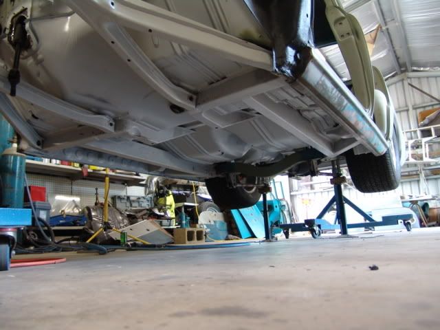

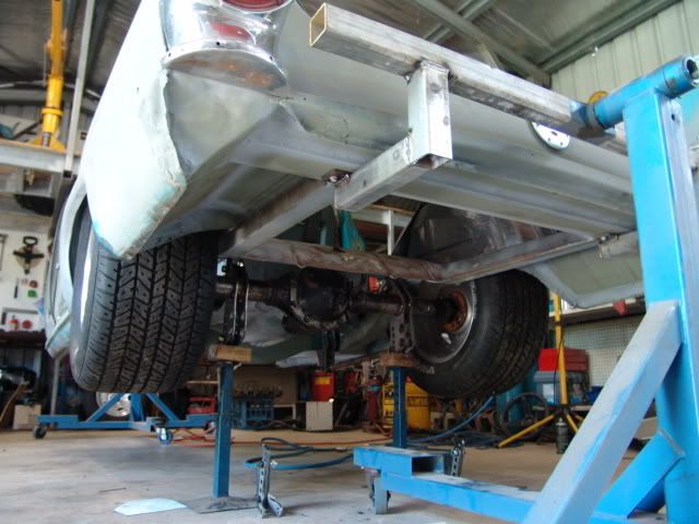

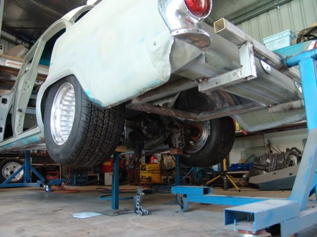

Trial fit of diff with wheels bolted to check width and position Coilover shock mounts (sitting on the floor), also measuring for the Watts link, thanks for the comments guys re: watts link vs Panard, help me make my mind up .... all fits good so far :D .
Now that the front is back on I can also fab the front chassis members.......

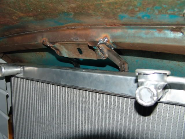

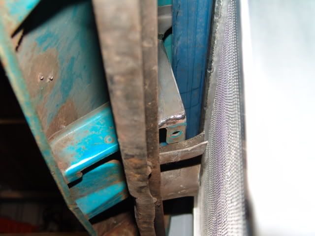

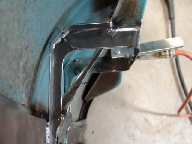

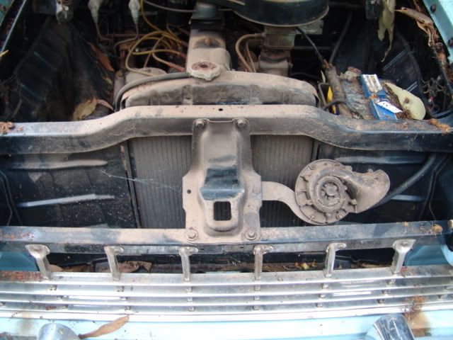

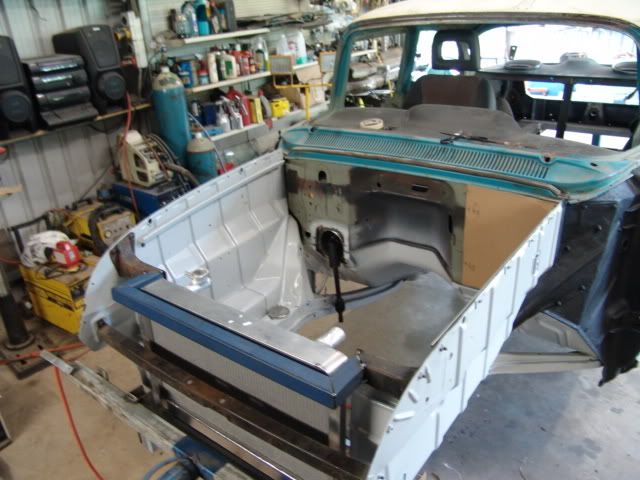

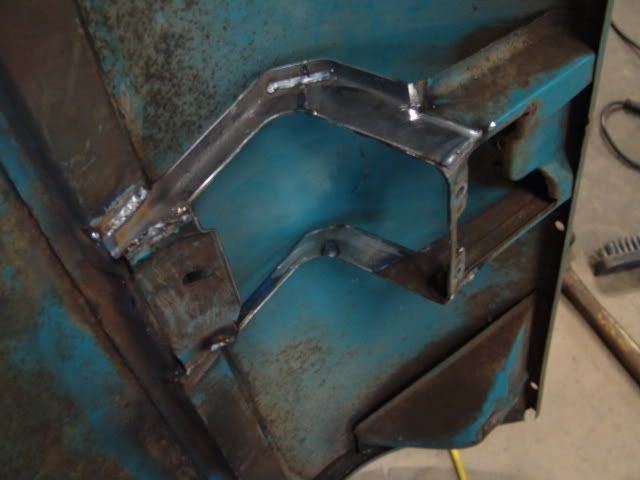

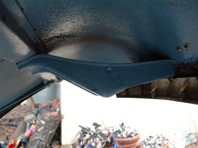

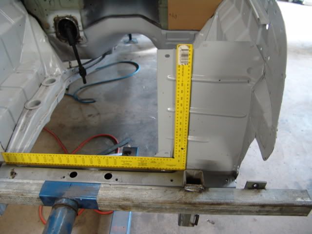

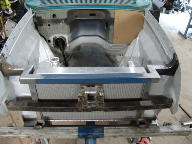

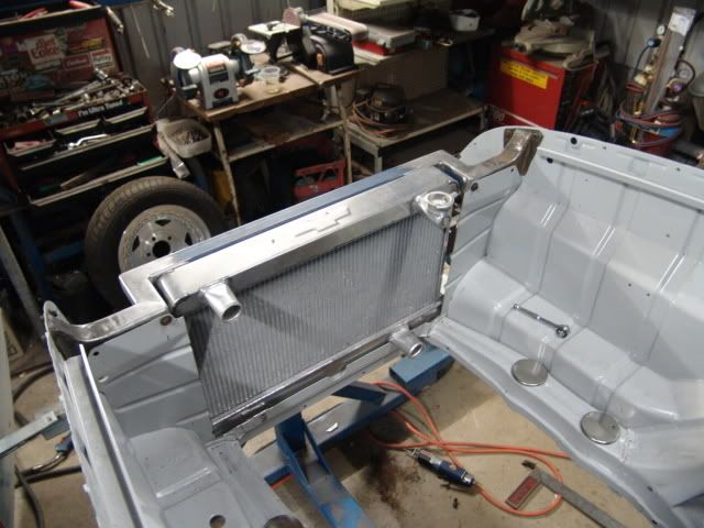

Billy Blackarrow, I have done the radiator set up today and very happy with the result (after some %$&*^%#!!). I have gained 90mm and can still get the A/C condensor in, the thermos sit in the engine bay and there is now plenty of room for them. I had to do some cutting and shutting on the bonnet (latch brace) and Bonnet catch to get it all to work as per original design ..... but it works and come out ok, I will probably plate off the "new" bonnet latch bracket (not sure yet).
Original plan was to put radiator behind the brace ....... not so good for room :cry:
Thought I would try it at the front, had to deal with bonnet latch, etc........
"Original" bonnet brace:
Cut out most of brace but left enough to hold its original shape, then fabed new sections and welded in before cutting out the last bits of the old brace.
Trial fit to see it it all clears:
"original setup":
"new setup"
Under bonnet shot to show clearance:
