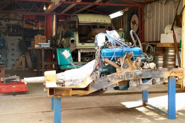

Hi Guys, just a bit more...I fully appreciate anything to do with a Chrysler motor is a bit ho-hum for FB-EK people, however since this baby will end up in our FB, I will continue. Besides you wont see it until you pop the bonnet...
Here we have the Chrysler small block 360 in a test bed, we want to establish the basics before we trick it up. The compression is good, the previous owners have added a performance dizzy and coil. BONUS.
Starts well, smoke due to a squirt of oil in the cylinders, it soon disappeared... Boy, the sound file was supurb!

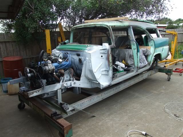

The plan is to make it street legal. We have a team with a good history of getting custom cars registered and on the road. I hope this will go well, but nothing is guaranteed of course. :? none the less we will keep plugging away.....cheers.

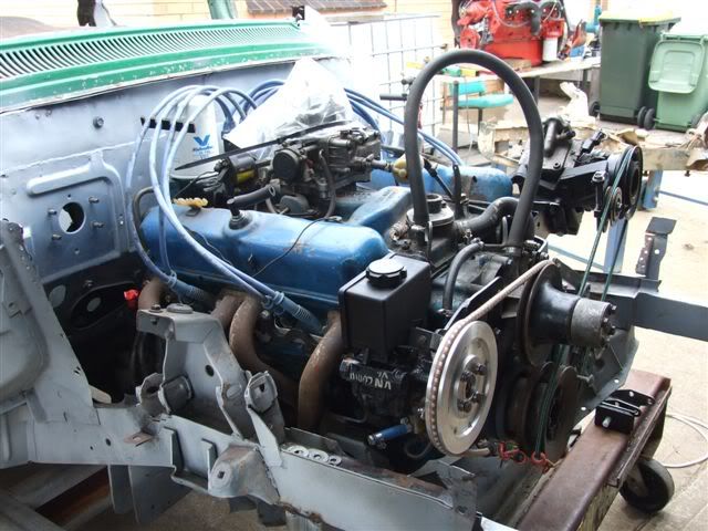

Hi again, here is an update... I promise it will look like an FB when it's finished... :?
We had to design and make all the brackets and pulleys to hang all the bits and peices off the front of the Chrysler 360 motor. We have a Commodore powersteering pump, Magna Airconditioning, and moved the alternator to a new location.
At the same time try and engineer a connection between the chrysler heater and Magna aircon...piece of art that was :lol:

Are the guards coming down to line up with the rest of the body? Trev 8) .
Have a closer look Trev they look like they line up now. I could be wrong :?
Post by mrs ratbox »
think trev means the plenum area, will be interesting to see how they deal with that
