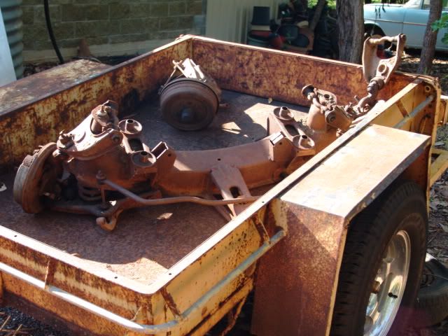

I have finally got hold of a HR frontend, thanks to Ian Campbell (Classic Holden Club NT). Image

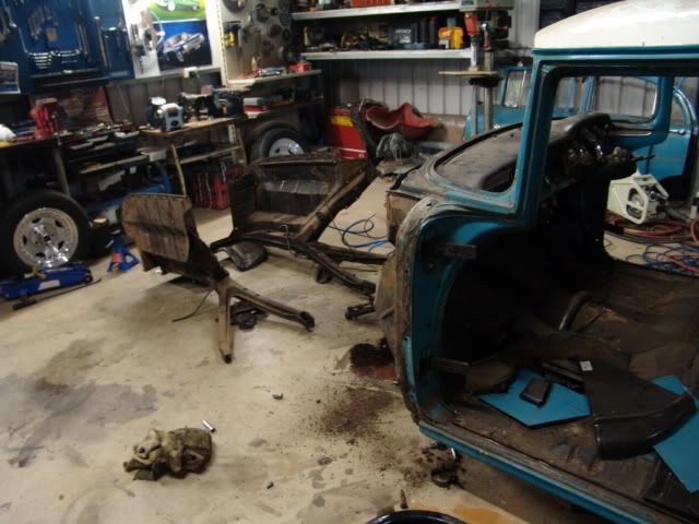

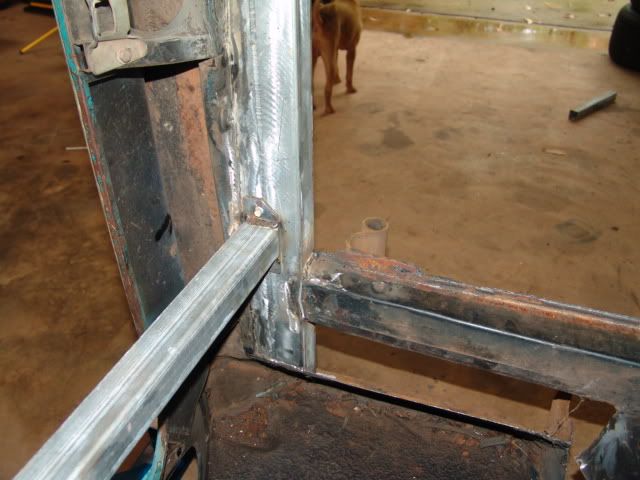

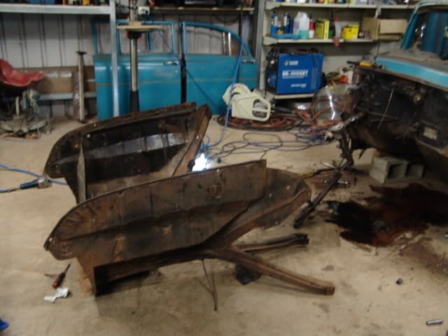

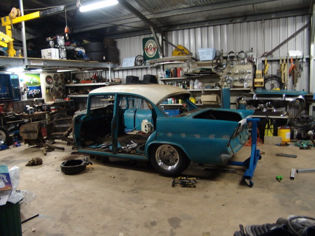

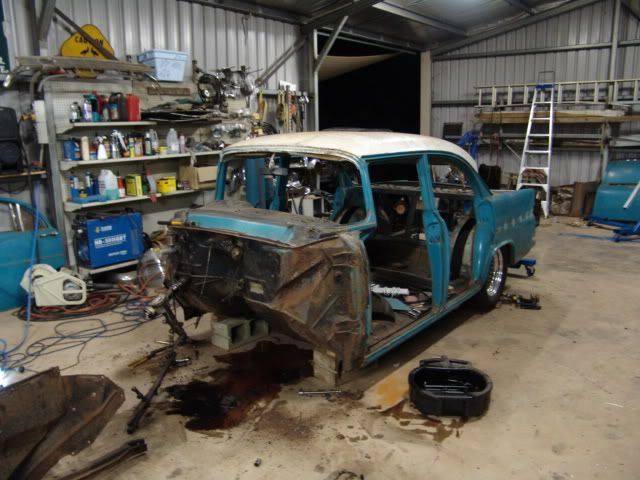

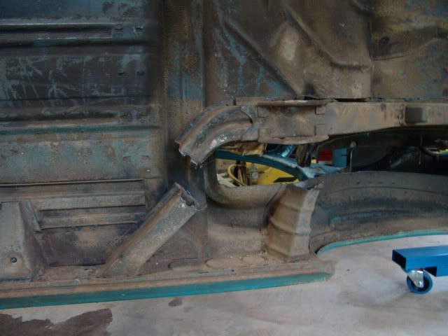

Final strip now that tubbing is finished and rear chassis rails are welded back in place (220mm narrower).
When the remaining bits are stripped it will be set up on the rotisserie for FINAL ROASTING!!
:D :D :D
I left the motor/trans and complete front end in place while the rear end was tubbed 220mm........... Things should move a lot quicker (wishful thinking!!) now that the rear end is squared up and welded back together so it is not like a LIMP NOODLE!! :shock: :shock:

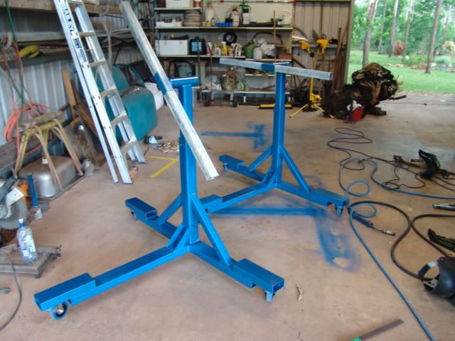

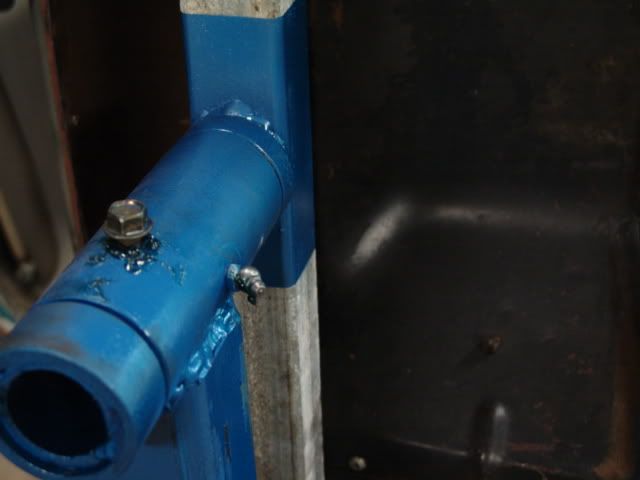

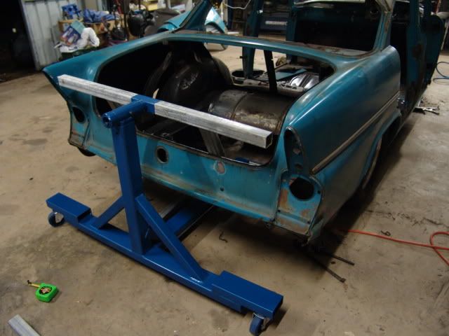

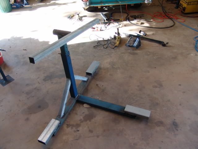

Here is a pic of the completed rotisseries ....... they are indexed to lock at 45 degree intervals, I also made the centre section adjustable for height so it will fit any car and you can set it at the height you are comfortable with. :D :wink:
I painted them with good old Hammer tone. Rotators are fitted with grease nipples for easy rotation when loaded. :wink:

Here is a pic of the lower rotisserie at the back .... just have to make the brackets to secure it, raise it, and of we go! :D :D :D
Will be pre-fitting 4 link and air suspension while she is on the rotisserie as it will be easier to do the welding rather than overhead.....

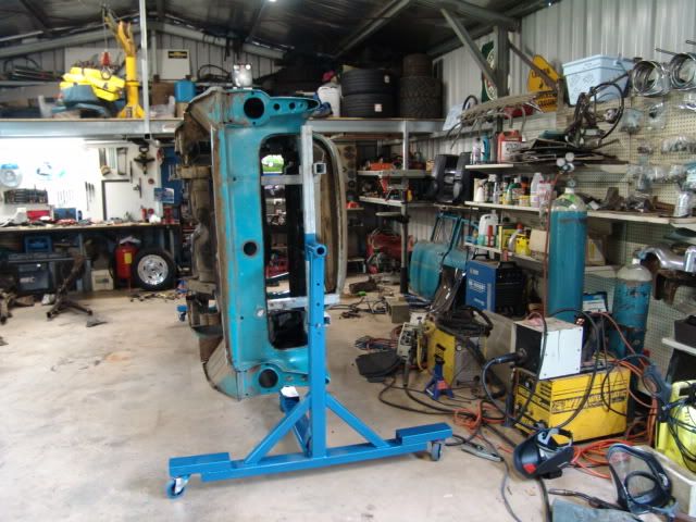

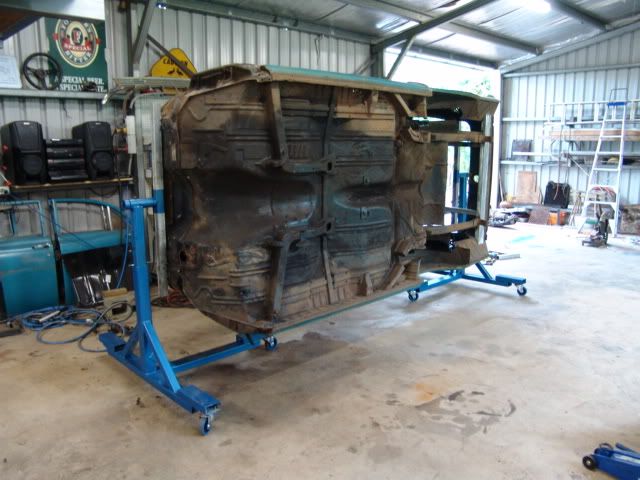

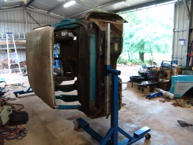

She up on the rotisserie...........YEHAA!!! works like a bought one too!! The front is attached to the original bonnet hinge mounting points and the rear is fixed to the "new" cross member.......here are some pics.
This will make the under body mods soooooo much easier!! and setting up the 4 link and air bags should be reasonably easy.... (wishful thinking or a load of Bull s__t!) 8) 8)
Rear mounts -
Front mounts -
Grease nipples on rotators to make it easier to turn -

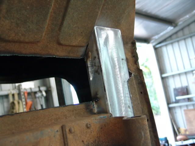

The old part of the rear sub chassis will be removed from the still and floor, a new section will be made and welded in further forward so it all lines up as per stock (just will end up longer) to make it look "original" with a difference!
This is the under side of the section added in to help beef up the rear end and will eventually (hopefully) assist in setting up and mounting the Alloy fuel tank, this will be fully welded into place. There are other cross members and a full CRS chassis kit going in to make sure the blown SB doesn't twist the body!
