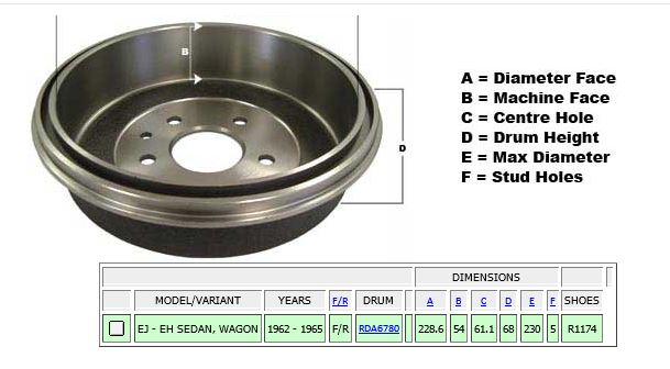

Here you go Clay, I Knew I had something. This was from RDA and is their current drawing for an EJ/EH drum.

According to my Gregory's they are both 1-3/4" which is 44mm as I measured today.
Re: New Brake Drums ?
Posted: Sat Feb 04, 2017 9:53 pm
by Craig Allardyce
Yep your right. Apologies as I got confused with some of the info I got from RDA as one of their quoted drums had a 54mm machine surface to take 2" shoes. I never did work out that anomaly but I think it had something to do with a generic drum they made for trailers that matched EJ/EH dimensions somewhat. Its a totally flat faced drum!

This might also help. Note EJ/EH commercials had a wider shoe.
