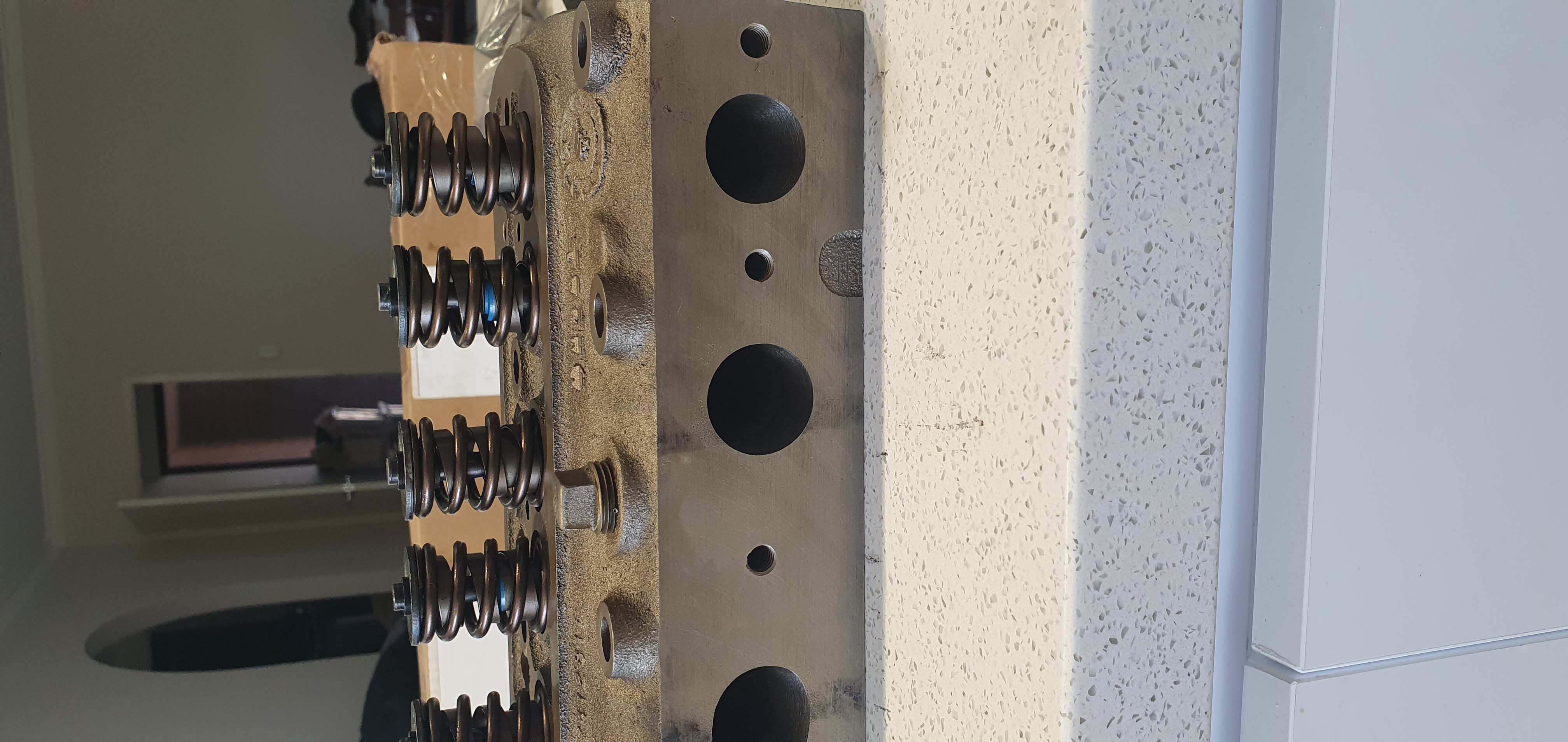

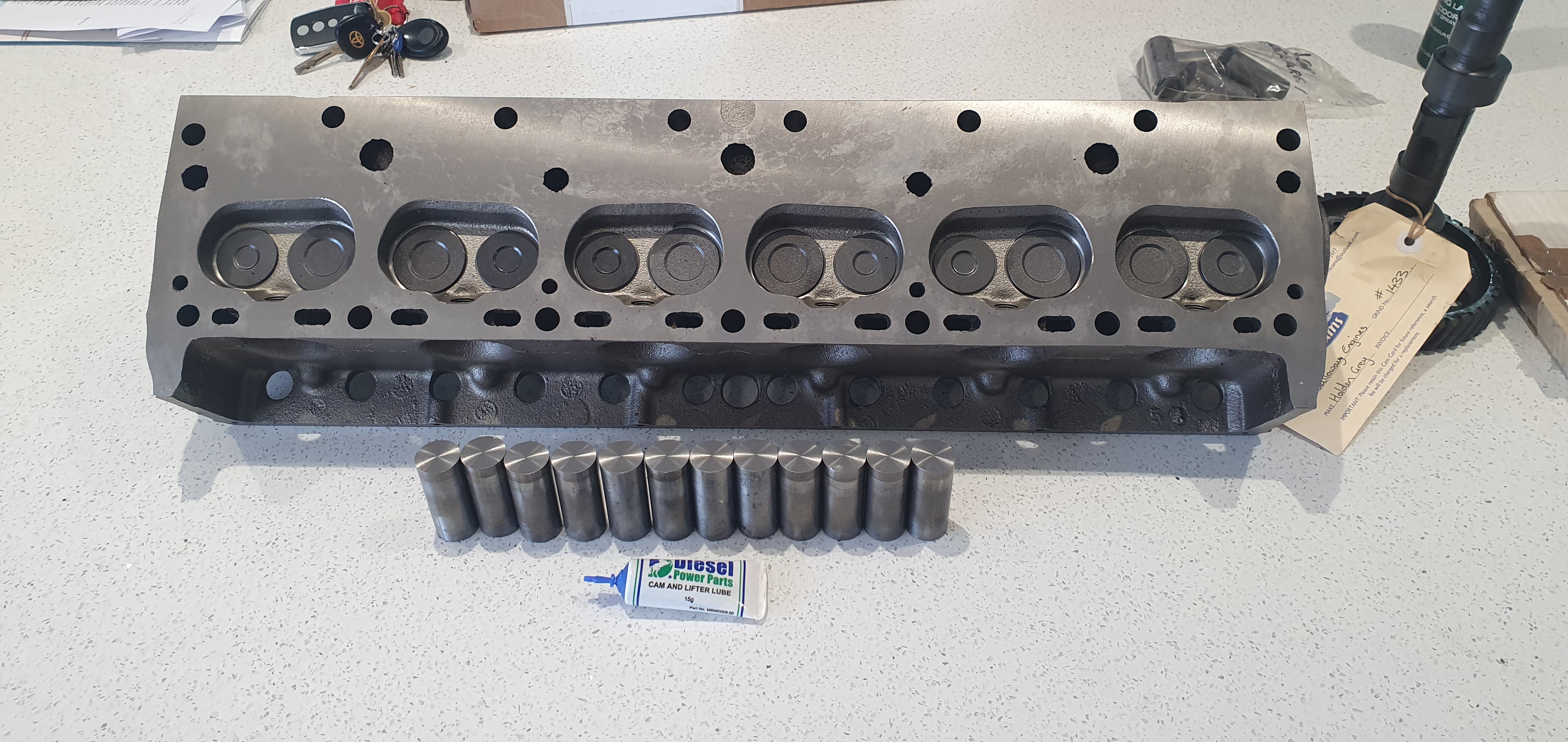

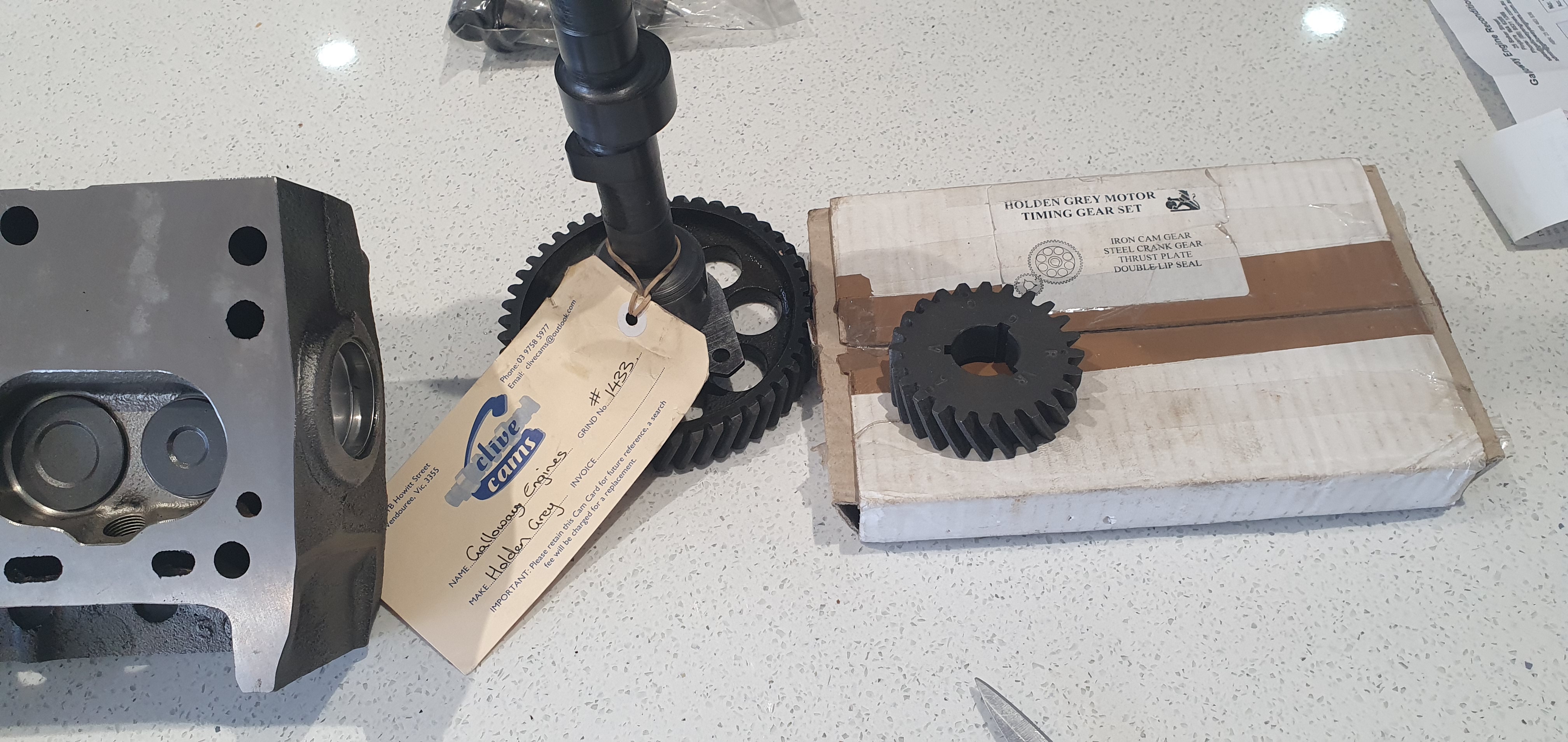

Hi guys
I went and picked up some motivation from Galloway Engines this morning.
Mild performance EJ Head, Red Motor valves, hardened seats back cut valves, throated etc..
The head has been machined down nearly to the Thumbprint.
The pistons are 40 thousands in the hole, I would love to zero deck the block.
Re-faced lifters.
Clives 1433 Cam.
I was getting a 842?? or something from Crow Cams but they no longer do reprints due to quality of regrind Stock.
I was going to advance the Crow Cam to smooth the idle and move the power range down.
Now I have to research this Clives Cam.
Now I just need to sort out the bottom end.
The bottom end is just getting rings bearings, maybe replacement standard pistons.
Oil pump still scratching head.
Re-faced lifters.
Clives 1433 Cam.

- 20260515_104554.jpg (2.08 MiB) Viewed 5801 times
- 20260515_104611.jpg (1.88 MiB) Viewed 5801 times
- 20260515_104627.jpg (1.75 MiB) Viewed 5801 times
- 20260515_104728.jpg (2.08 MiB) Viewed 5801 times
- 20260515_104839.jpg (1.55 MiB) Viewed 5801 times
