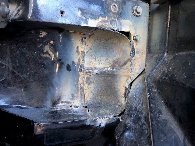

And so after another blunder highlighting my social media ineptness (I really should be getting my kids to do this shit), its back to posting this stuff in the forum where it is supposed to be ( my apologies to all)....after finally securing the services of someone who can weld properly, we made a start on getting the webers to fit.
Being in a tight spot with some complex shapes (and limited Sheetmetal tooling available), old mate came up with an ingenious solution... enter one quarter piece of a 2kg gas bottle
firewall mod.jpg (100.73 KiB) Viewed 5257 times
I know this mod wont impress everyone, but once tacked in a trial fit of the carbs had me grinning :D :thumbsup:

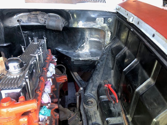

firewall mod1.jpg (104 KiB) Viewed 5257 times
firewall mod2.jpg (100.31 KiB) Viewed 5257 times
until it was time to trial fit bonnet :( :thumbsdown:

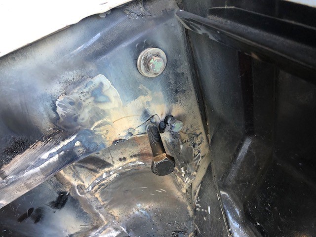

so hinge and gas strut mods now added to workscope
firewall mod3.jpg (98.66 KiB) Viewed 5257 times
firewall mod4jpg.jpg (98.03 KiB) Viewed 5257 times

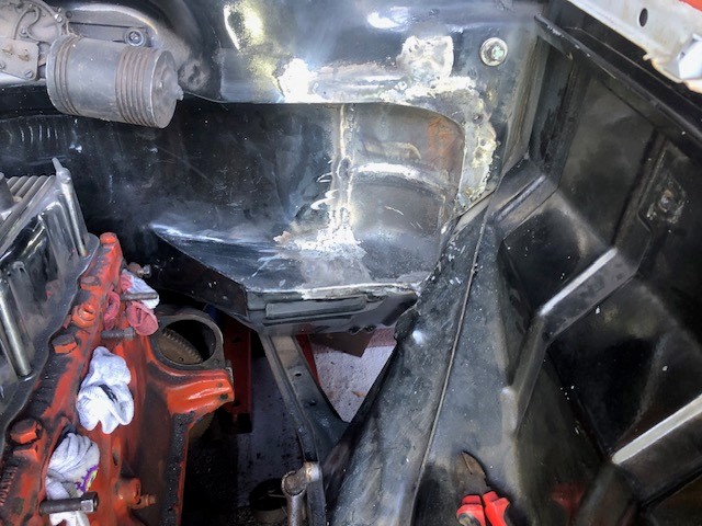

and then after a long absence of the welder, he returned to close up (some of the holes)
firewall mod5.jpg (97.19 KiB) Viewed 5257 times

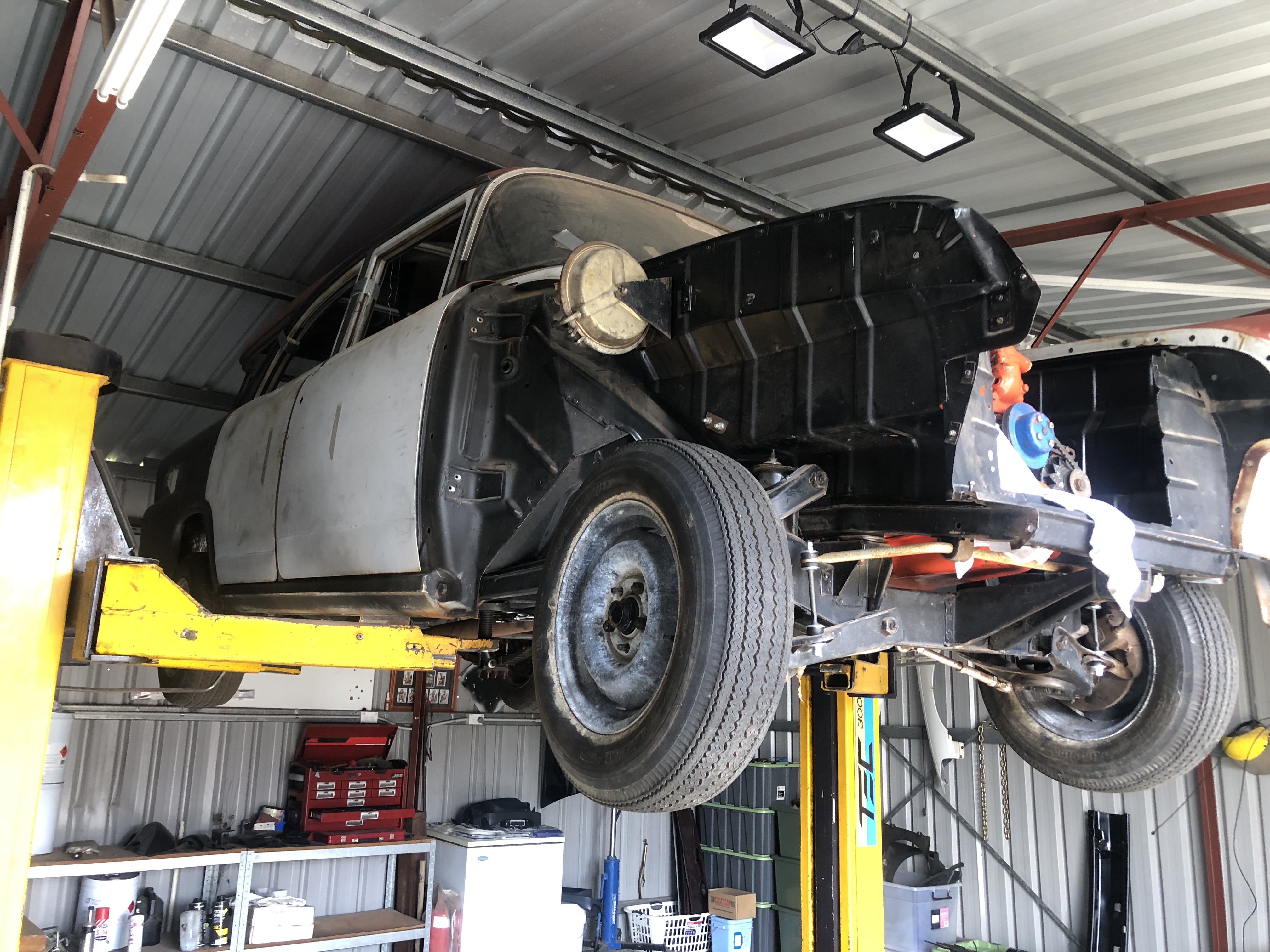

After another period of little progress have managed to achieve a few little bits n pieces so we could move to the wiring- battery relocated, new starter, dizzy, coil and a set of Bangin headlights. Wiring harness removed from car. Also got the handbrake sorted with a stand-off pulley mod. New exhaust system fitted. A good mate offered the use of his hoist, so off we went…
while we’ve got the hoist I’m hoping to get the brakes sorted- can anyone help with pics or advice on best routing for front brake lines with booster relocation as pictured? Also like to wire in triple gauges and tacho while we’re at it- the high volume oil pump looks really close to the oil px sw- what’s the go with an adaptor so we can use idiot light and pressure gauge? Not much room to screw one in it seems? All help greatly appreciated as always!
Thanks guys,
Melly

What master cylinder you using ? Run from master to booster then booster to the distribution block on the subframe for the fronts and straight from the master to the rear if you can.
Oil pressure adapters are available just about anywhere, Veales, Auto One, REPCO etc. I have one on the rattler to run idiot light switch and gauge

download/file.php?id=17573
This one Blacky- PBR there’s some details back a bit in here, original drums on back. So plan is boosted front only, from MC front port out into the guard then from booster I’d like to know what route people have taken back thru the engine bay to get to the LHS? Some pics would be handy so I can get an idea of where to actually position them?
Cheers melly
Re: Melly's EK wag find
Posted: Fri Oct 18, 2024 6:32 am
Booster down to front subframe, to original location of tee-piece. Keep this line as close to the inner guard as possible, and clamp it about every 8" or so. Use two-way tee-piece to split. One (short) line to RHS front subframe into the original "flexible pipe meets steel line" joining bracket. Second (long) steel line across the bottom of the radiator, picking up the bendy retaining clips along the way. Finish this line at the LHS front subframe into the original "flexible pipe meets steel line" joining bracket.

Thanks Harv/ Blacky that makes more sense I wasn’t even looking for attach points across the front. I could do with another car close by that I could use as a reference.
