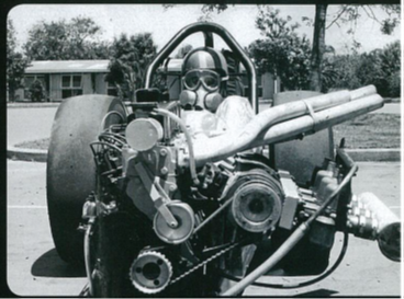

With apologies to Brett and Neil... a little closer to the matter:
Cliff Kiss.png (236.31 KiB) Viewed 1905 times
Cliff Kiss, and his Norman-blown red motor rail. This is the mental picture I am aiming for with this project.

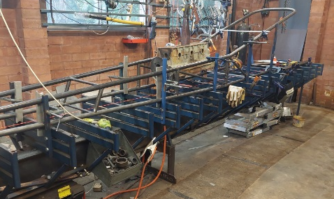

Flexplate ordered and on it's way. Manual valve body has arrived, as has flexplate shield. Have to pick up the ballistic blanket this weekend.
'course, a transmission to put all that on would be handy. Need to organise a day trip down south to Brett's place to pick it up.
Chassis is coming together nicely. Builder needs to measure me up to set the distances for the shoulder hoops. Grey motor dummy block in place (should look familiar Mark - with thanks :D ).
