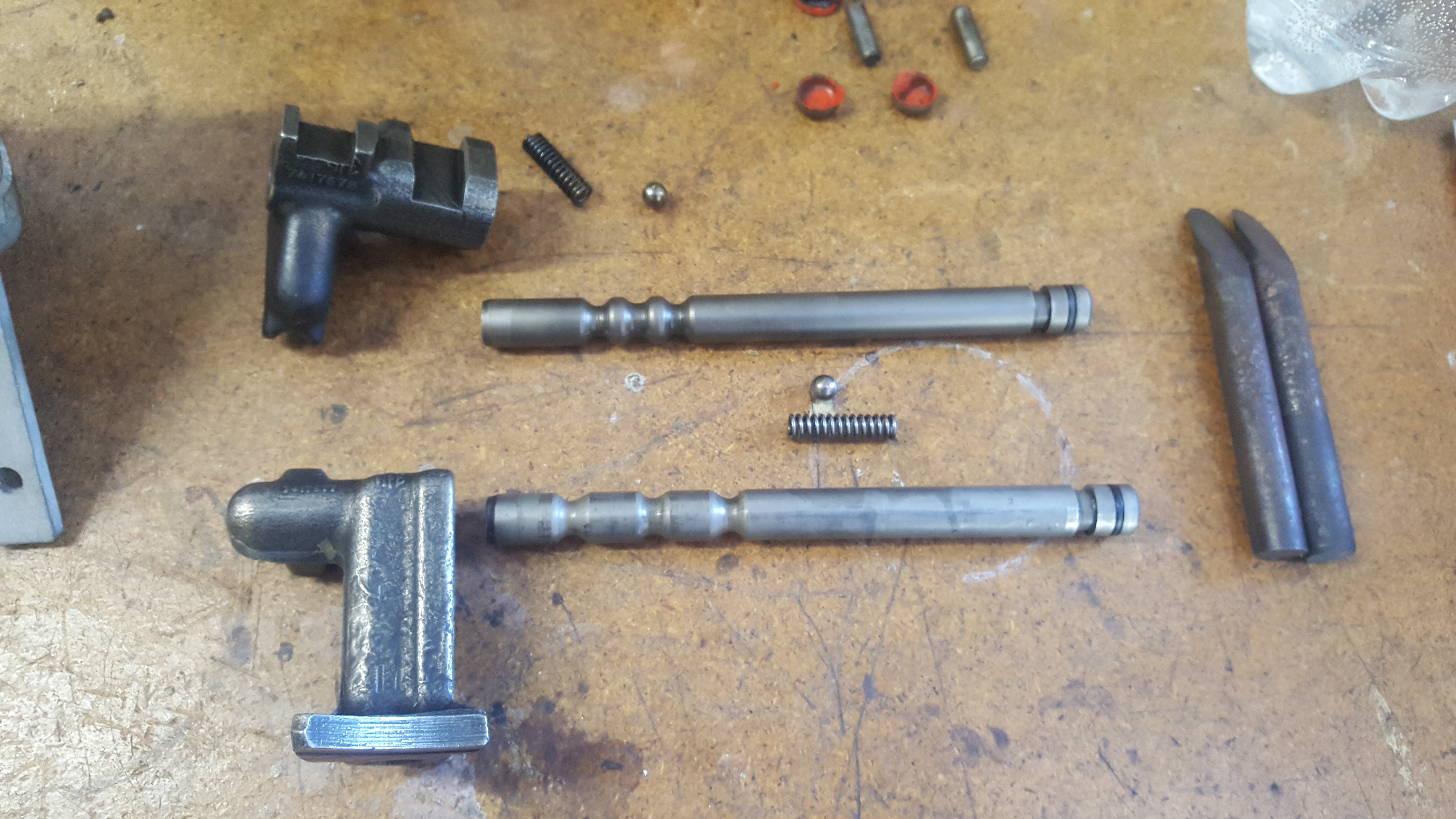

Thanks for the offer Blacky, it's the side cover I'm working on though, these are the springs that sit in the shifter yokes, was wanting to put new ones in to get rid of slop, probably all the old ones in boxes have lost their tension unfortunately.

you could drop a washer or two on top of the springs

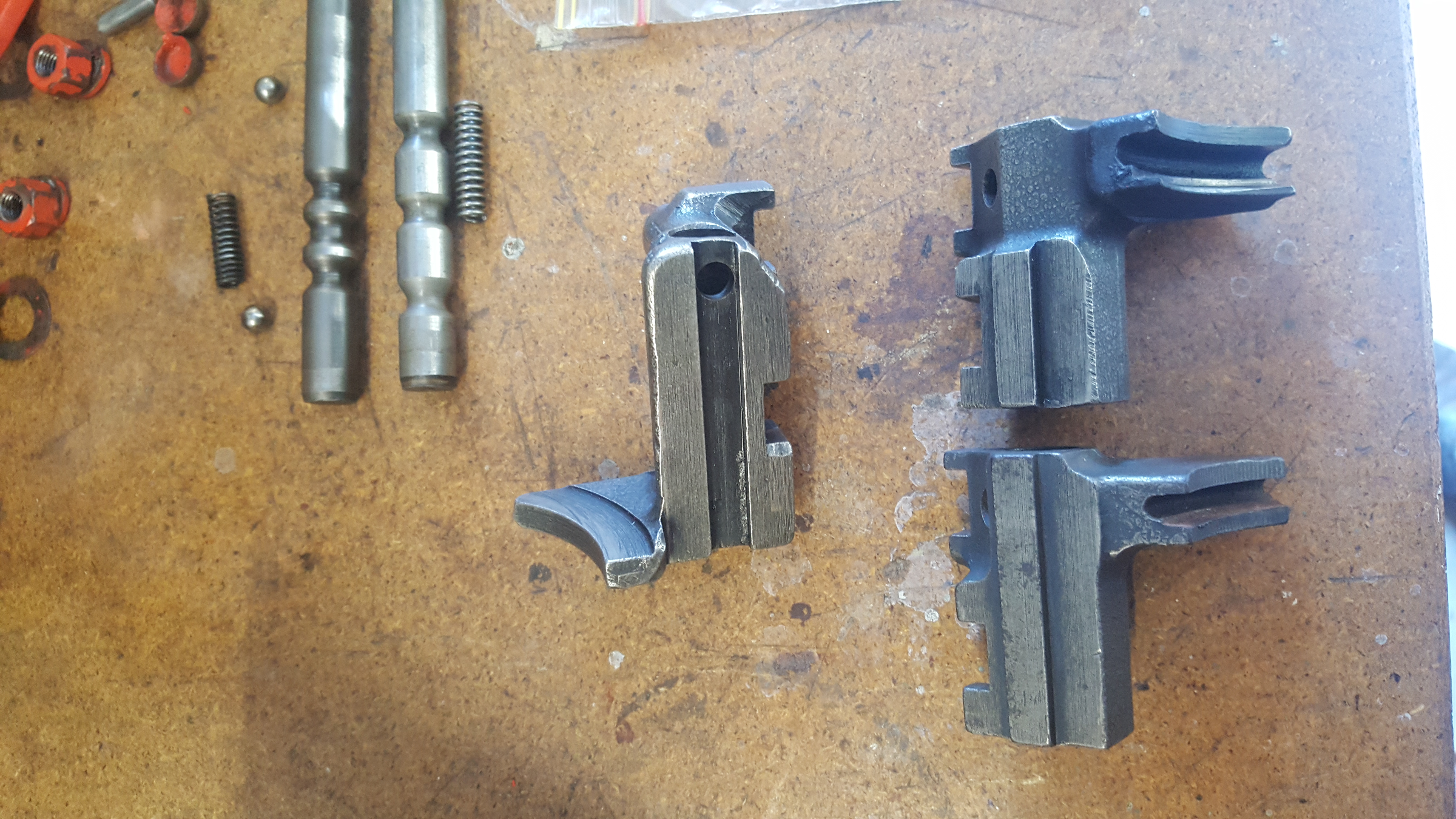

I could experiment with washers, these new springs would have perfect tension if they fit though, grrr.
The side cover, and shifter levers appart from the little internal lever are all new old stock so they are great.
I checked Rob's suggestions, the shiftrr shafts look great, the new ball ball bearings move freely in tracks and fit well, move though yokes fine too.
Might be off the mark here, as I have been known to make some bad decisions at times, but could the yoke bores be widened by 1/16 inch for the springs, or would I create further issues with that, maybe that causes issues with the ball bearing. Anyone want to hazard a guess on that?

That's bizzare Rob, both had the same idea. I didn't see your response until I posted, lol. I like the idea of boring it out 1/16, logically the ball is a loose fit so shouldn't be effected.

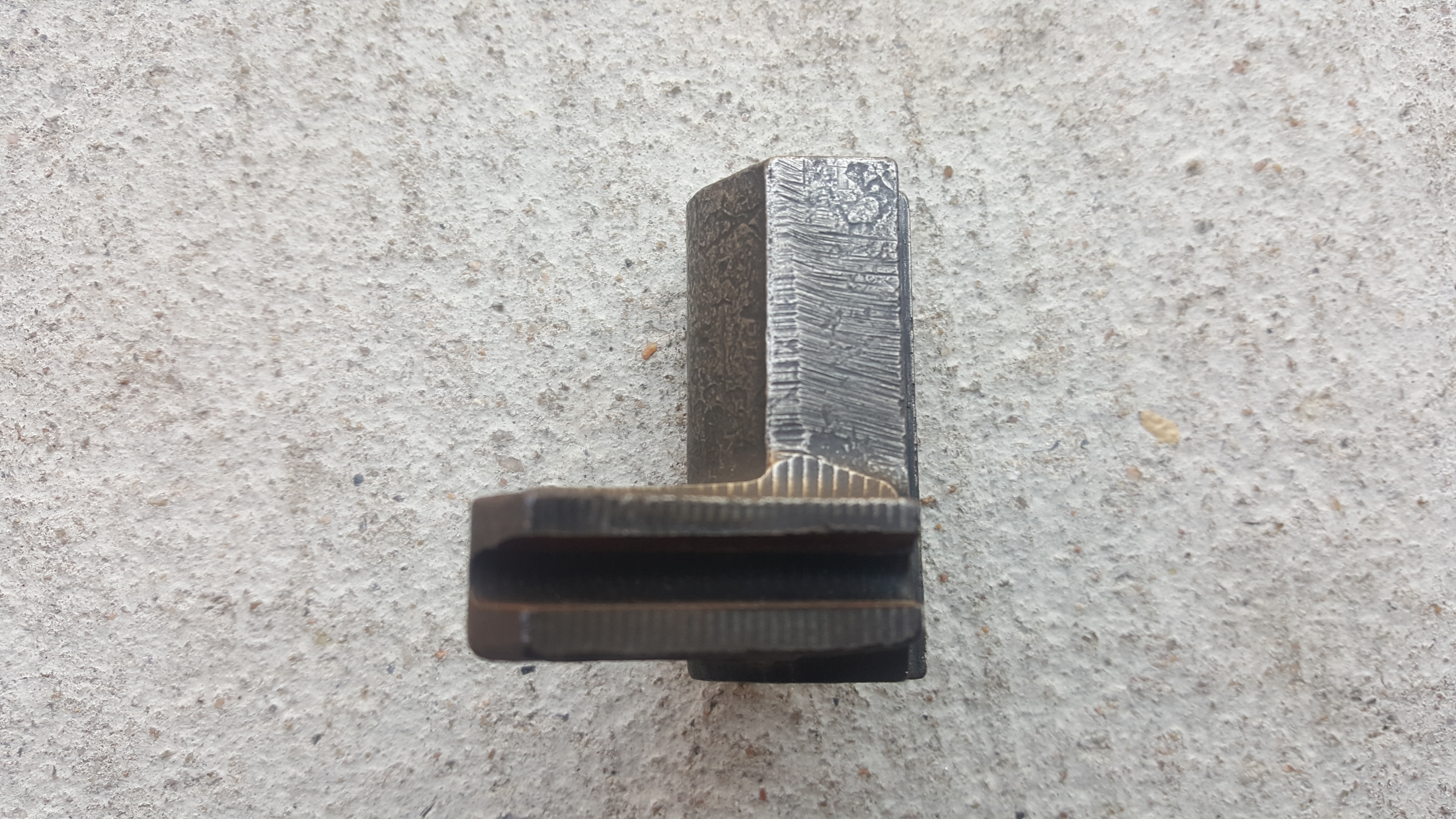

This yoke came with the new old stock bits I bought, going by part number is from a later model not sure what, that also is 1/4 inch bore. Not sure if that will work with EJ box so might skip using that I think.

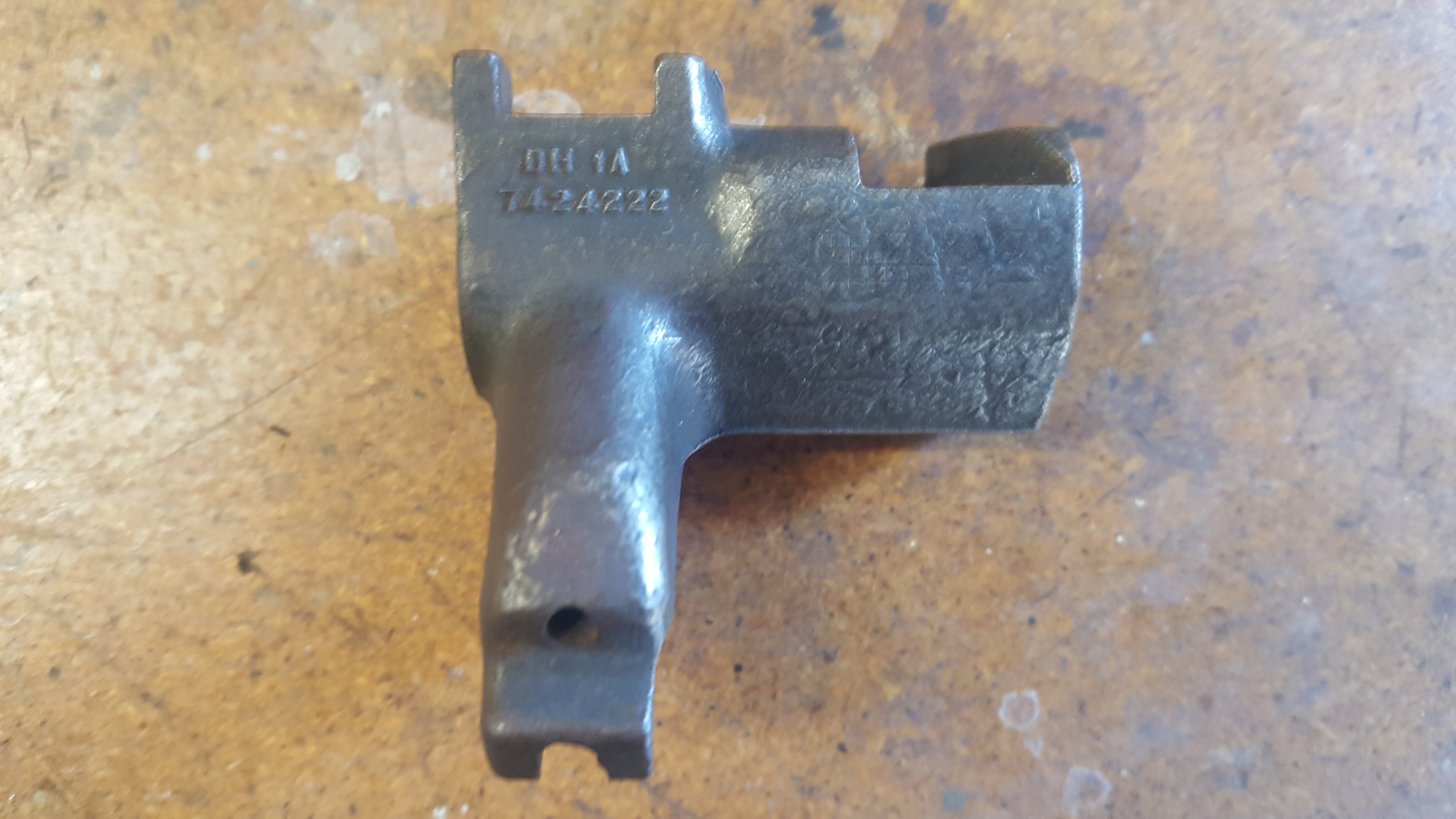

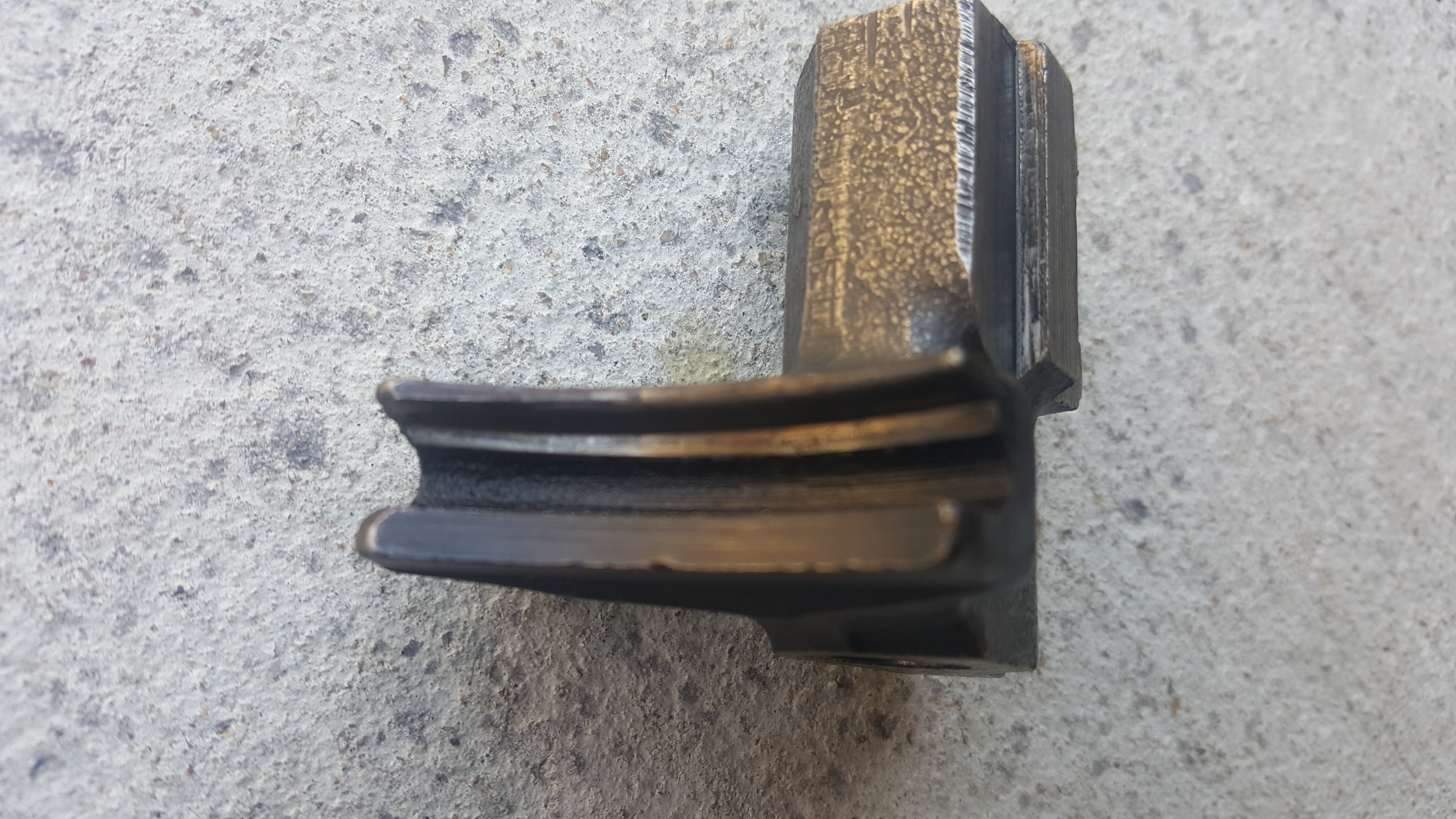

Having said that looking at the 2 together, this highlights an issue. See the wear on the old one, when I sit it on the hub there is so much movement, compared to the newer one.

There's your problem there . . .
Your "other yoke" looks like the groove is worn out too.
Fractions of an inch: The detent ball in my 7431970 kit is 11/32" diameter. Your yokes take a 9/32" ball, which is less than 5/16". Drilling the bore out to take the bigger spring is a no-go.

Rob, I am thinking I need to stick with the 1/4 bore, and the old springs are not the issue, the yoke is. The new one I was thinking had no signs of wear and was a snug fit on hub. See this other photo of the flip side which is a much better design as is a better fit to the other yoke.
