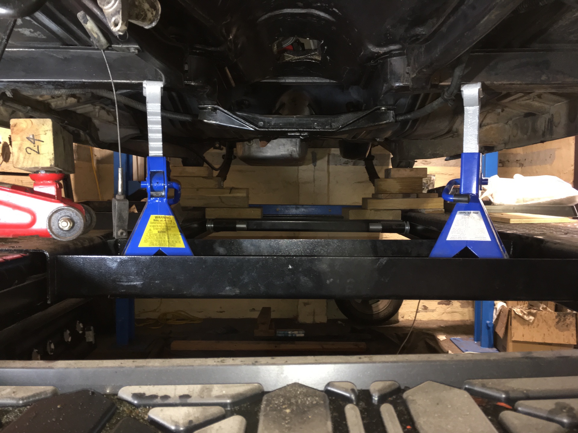

Some of the cleaning efforts
Working back to front. Lot of elbow grease to clean off that grease. And a few cans of SCA degreaser

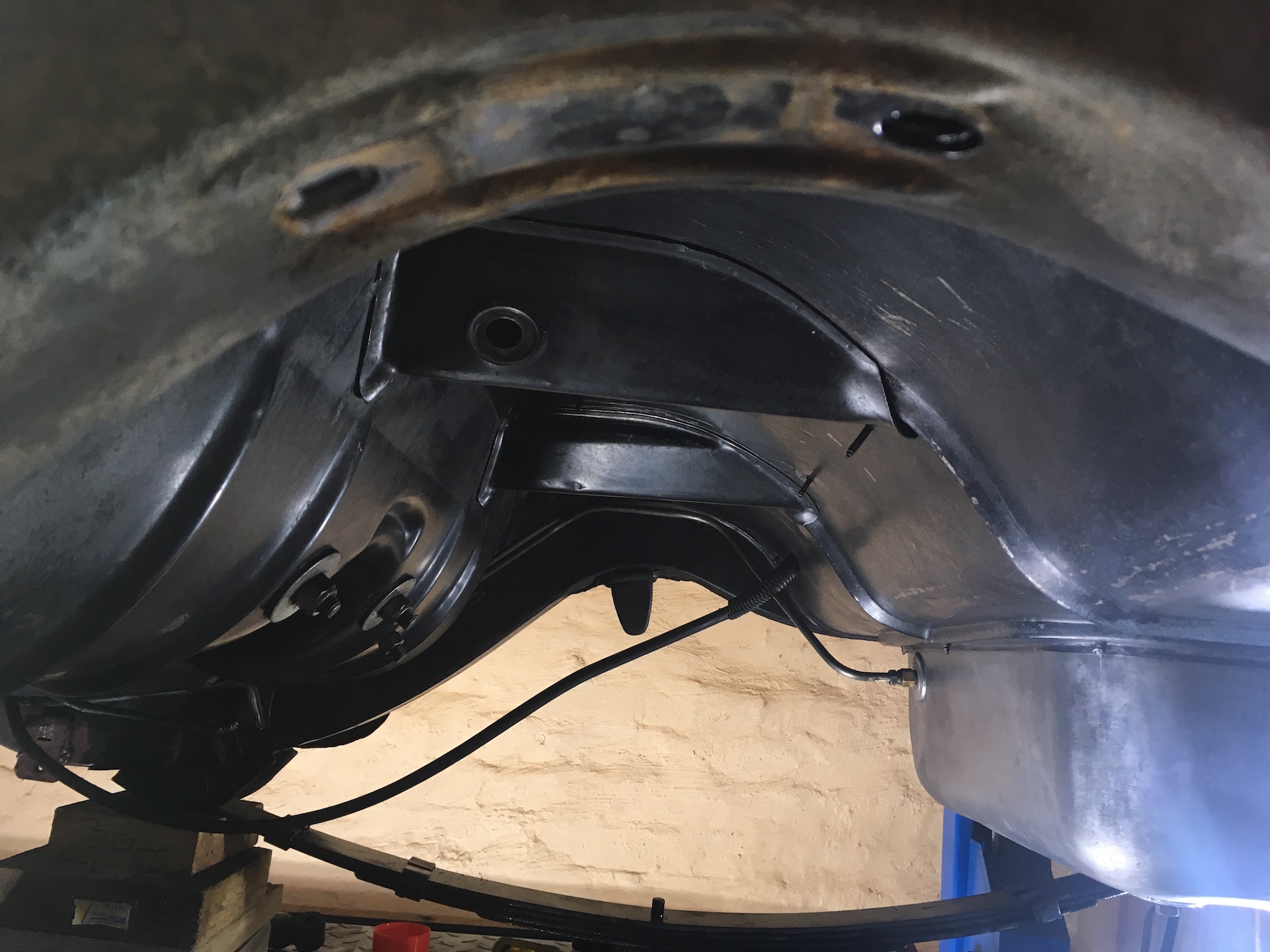

Wheel arches are a pain and this is where the platform of the hoist is not your friend

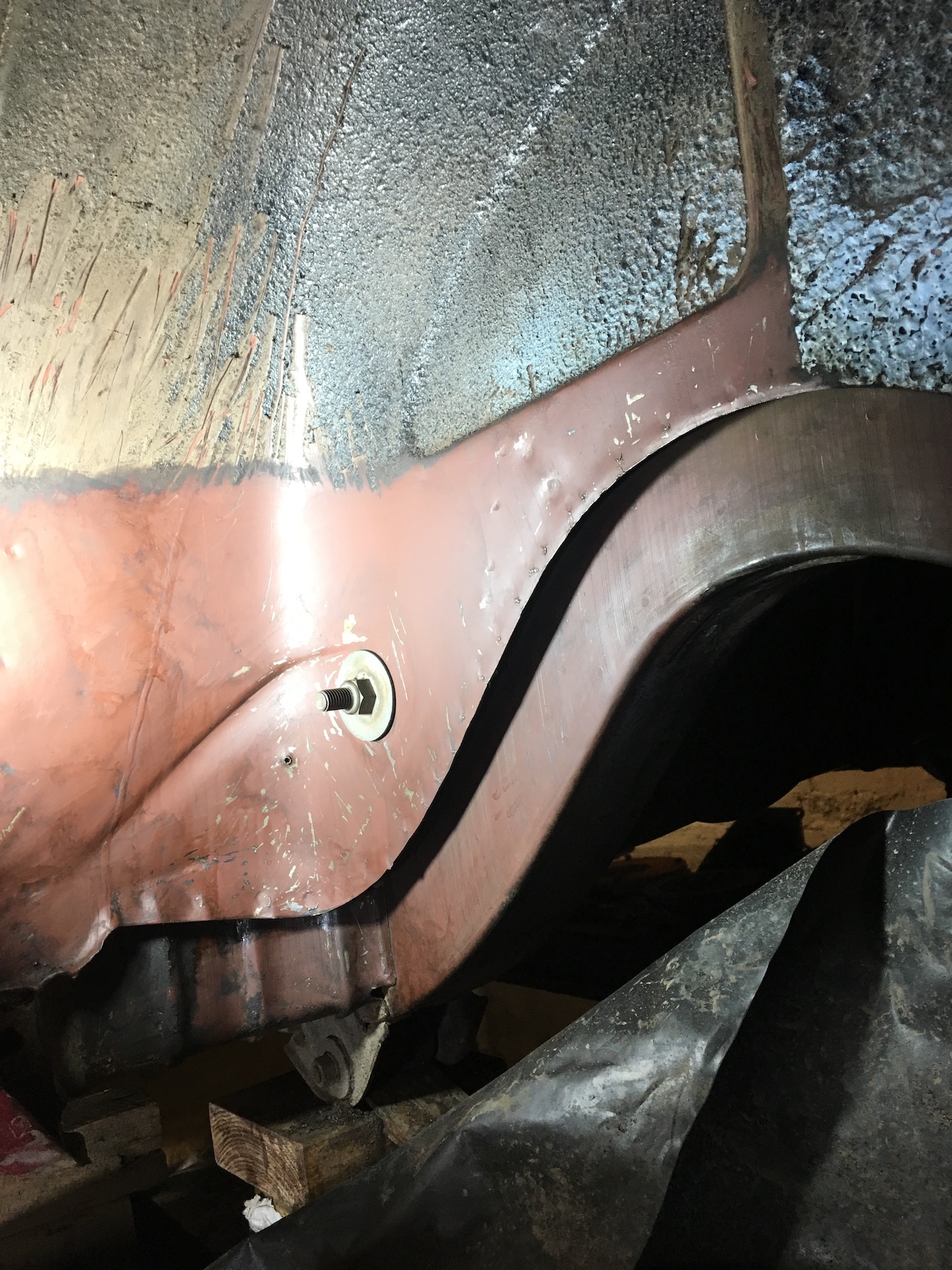

Looking from the engine bay to the back

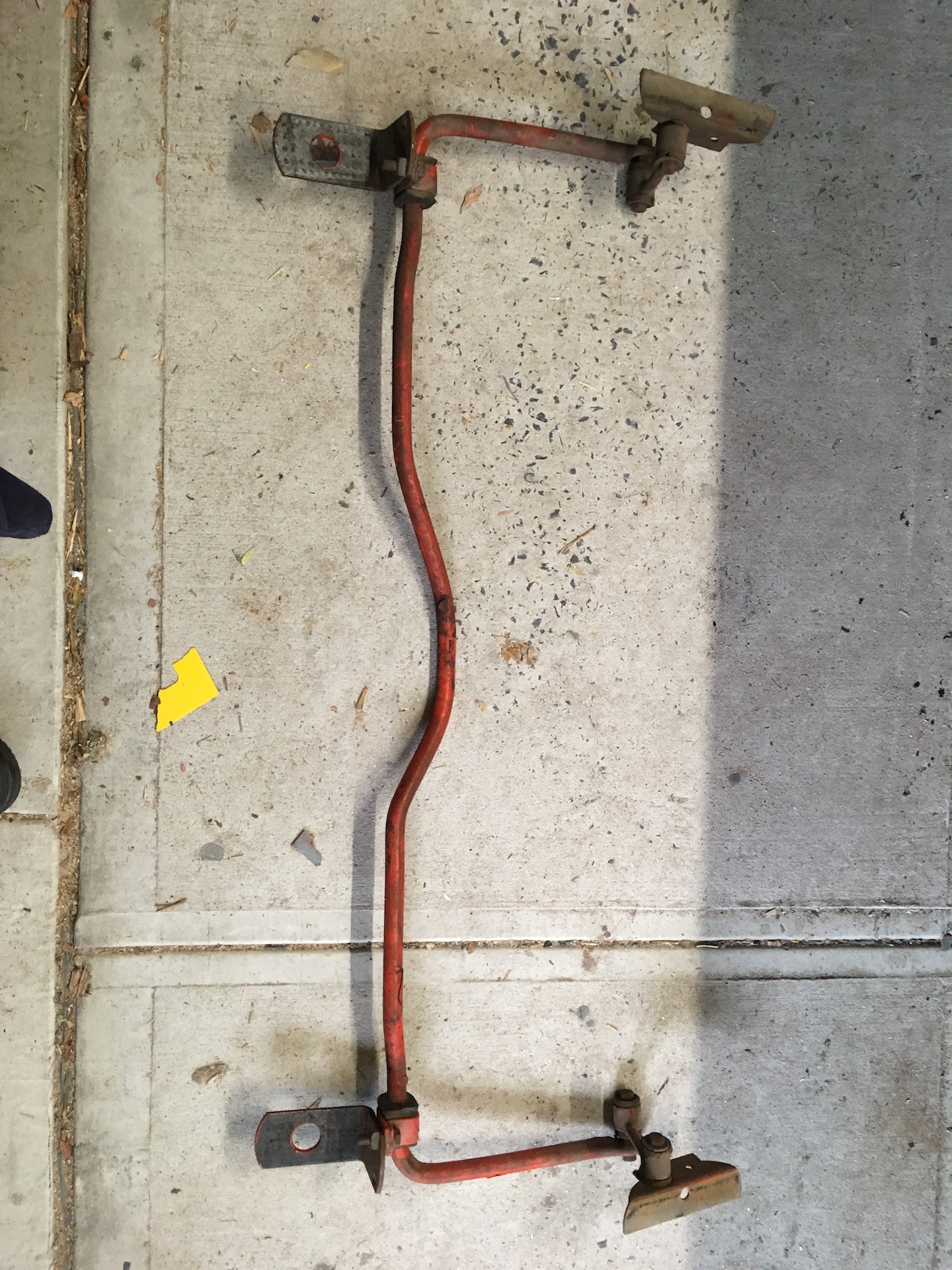

K-mac sway bar out. Removing the plastic dip coating, new bushes and a coat of black.

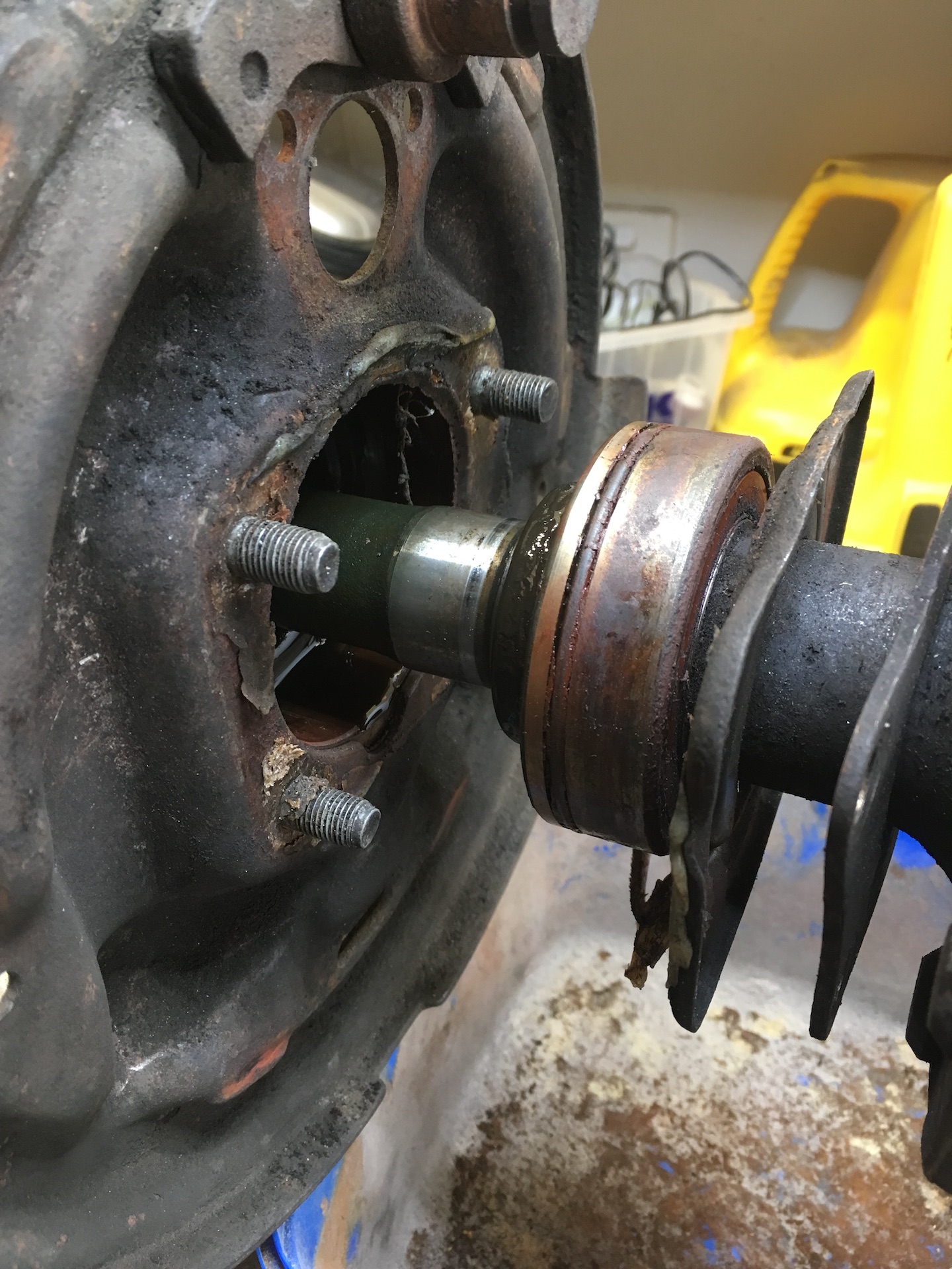

Axles out. Those bearings look a bit rough but weren’t noisy.
. Is the orientation the right way round with the I ring on the inside? Note to self, take them out when the diff is still bolted to the car!

by ardiesse
Rear wheel bearings - yes, they've been installed backwards. O-ring on the outside is the normal way. But don't change them just for the sake of correct installation.
When you take the pinion flange off, you'll probably be surprised by the amount of wear where the lip of the seal bears on the flange. You might have to chase up a less-worn pinion flange, and that's about where it becomes a job for a diff specialist.
Re: Ol' Rusty - FB/EK Sedan
Posted: Thu Nov 12, 2020 8:38 pm
by funkyscooter
Thanks for the tip Rob. Didn’t get a picture with the flange out. But don’t think it was worn and the new seal was a snug fit.
Figured the bearings were the wrong way round. Read that the o ring is to seal water and dirt out, not oil in. Is that true? Anyway decided to leave well enough alone for now.
