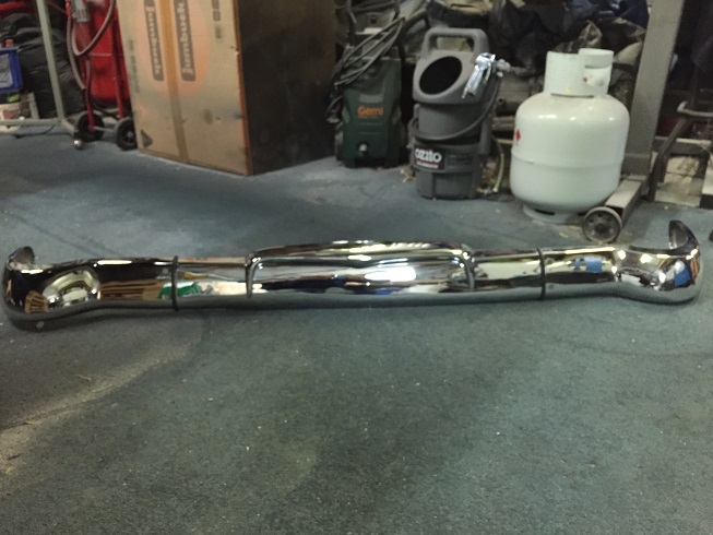

The change to a rear FC sedan bumper, which has been done before a number of times, but I do not like the over ridders.
Clay scored the bumperettes for his ute.
I looked at Neil’s rear bumper on Frank but not sure on the painted finish.
There are spray on chrome like Hydrochrome and Exteme Hyrochrome out of the UK but for $600 + shipping maybe a little expensive just to try.
https://www.youtube.com/watch?v=A6kypid0XG0

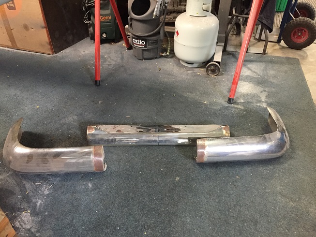

Purchased this one from Cary, one of our club members and straightened it.
FC Bumper 1.JPG (115.46 KiB) Viewed 1348 times
FC Bumper 2.JPG (102.12 KiB) Viewed 1348 times
I did consider a single piece bumper but the re-chrome cost sky rocketed to a quote of $1,300 +
Straighten and narrowed it, to tuck the ends in closer to the body and then chromed.
I lowered the number plate surround, to remove the gap between the top of the bumper and the bottom on the surround. Normally you would see the body but as I intend to use the narrow number plates I wanted to clean this up.
rear bumper.JPG (106.22 KiB) Viewed 1348 times
I will still use the domed bolts to attach the bumper and Anne-Marie like’s bling and the chrome bumpers hits to spot.

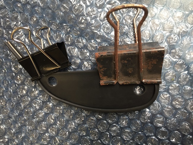

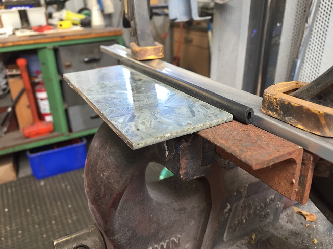

Did not like the joining faces on the rear bumper so made a couple of gaskets.
Needed to slice the rubber from one section into a ¾ curve and glue to the flat section.
Needs a little tweaking but happy so far.

Lots more time spent that I anticipate to modify the bumpers. A lot of weld, grind, re-weld, file and hand sanding.
But as we know with chrome you only get a good result if the substrate is smooth.

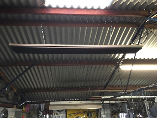

A little cold in Adelaide today so I cleaned off the heaters and set them going.
Running cost is around 50 cents an hour so fairly inexpensive.

Radiant heaters are a great idea.

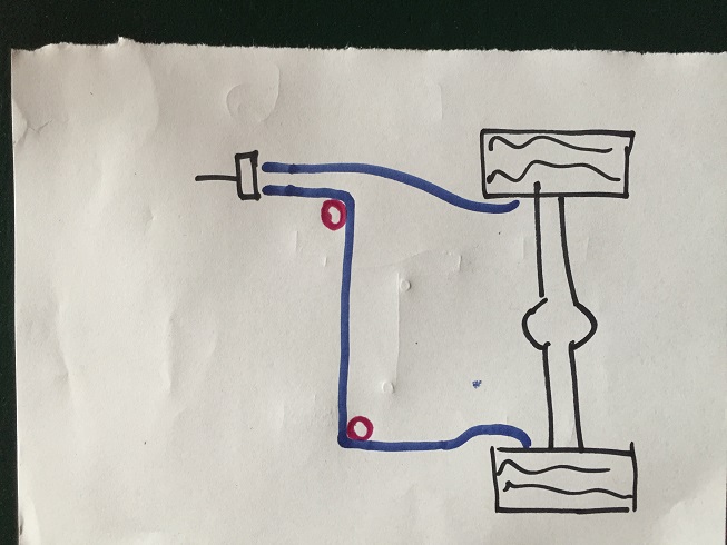

I do not like to look of the standard diagonal cross wire for the hand brake so this is what I’m currently working on.
Transfer the chalk drawing on the bench to paper.
I will use a pair of the pivot wheels from the firewall and mount these through the floor in the tub.

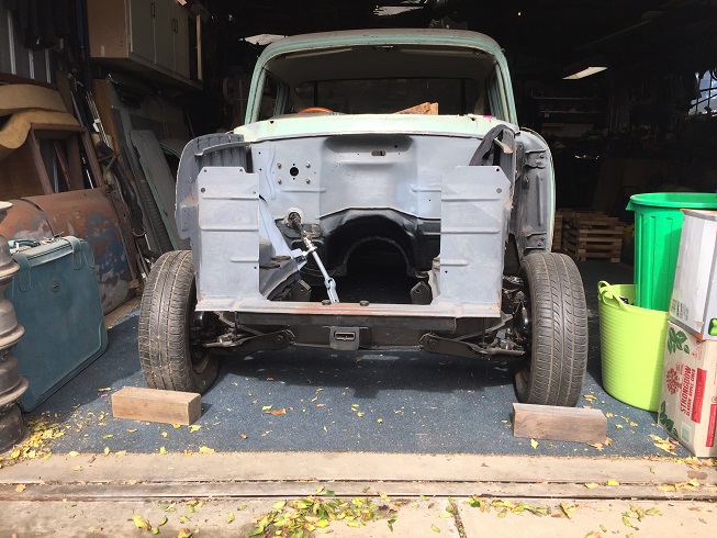

Mechanical upgrades started with HR disc front end and narrowed commodore, rear mounted steering rack.
It has 202 and trimatic auto so Anne-Marie is OK with this. I do have a small SC14 super charger which may or may not be added.
I have done the reverse leaf changes on the HR rear and lower springs in the front. I will see how it sits once all the drive train it in but I want it low.

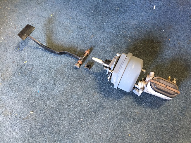

For the brake system, I’m using Gemini booster on the PBR dual master cylinder.
Modified a HQ brake pedal to clear the steering column as I moved the booster across and had the front calipers rebuilt.
brake set up 1.JPG (205.9 KiB) Viewed 1249 times

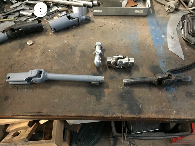

The steering linkages are VL top to VK bottom with Borgrson style uni joint for support.
Steering 3.JPG (144.45 KiB) Viewed 1249 times
Steering 4.JPG (130.16 KiB) Viewed 1249 times
