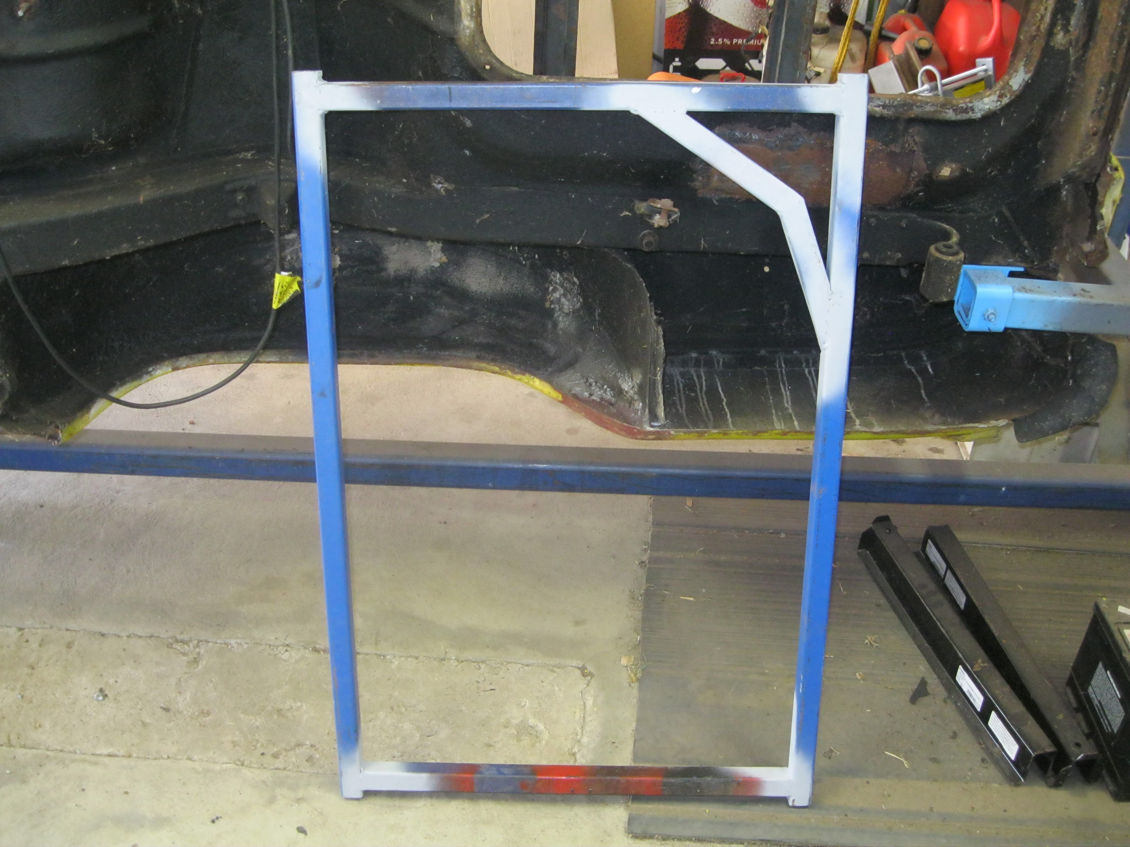

The best way most fit the commodore tanks is to cut out the floor area, make a frame that goes around the shape of the top of the tank and yes used straps.
The VN VP tanks being steel are the best because you can move the filler necks which I've done on both of mine, buy cutting the floor the tank moves up and doesn't hang low.
I can post some photos if anybody interested.

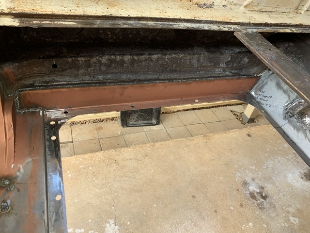

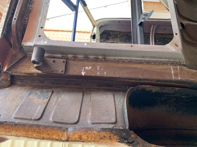

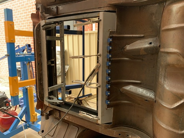

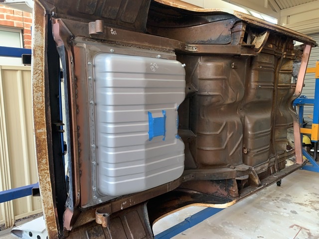

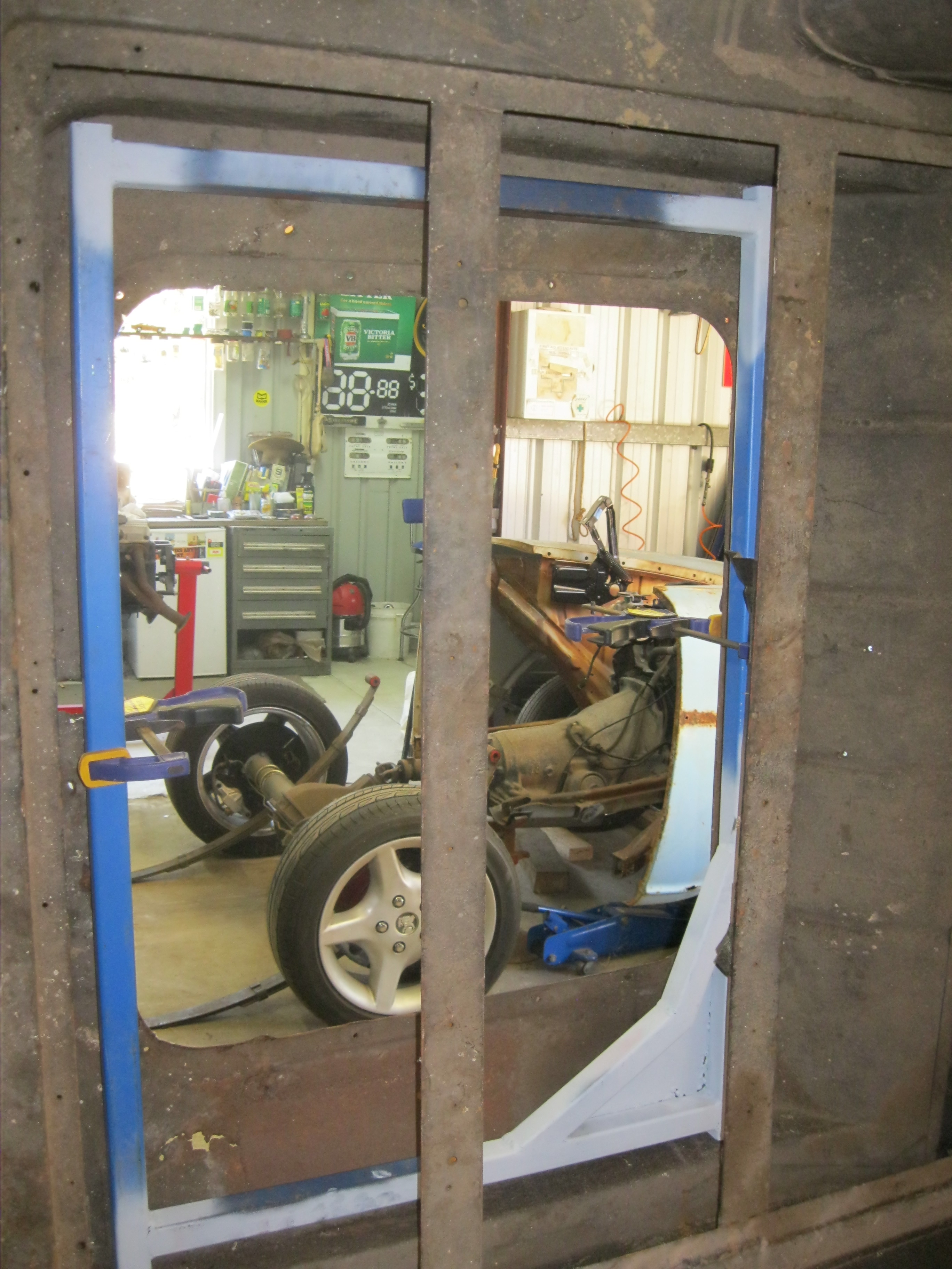

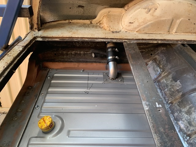

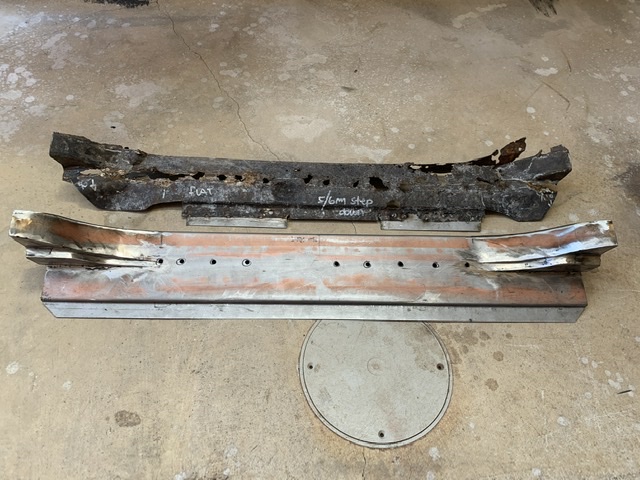

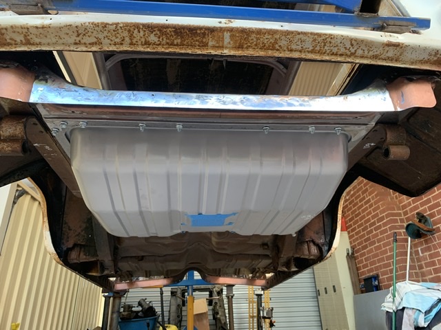

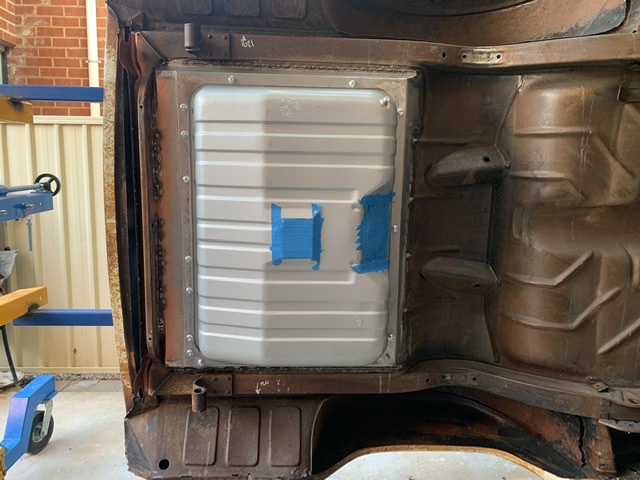

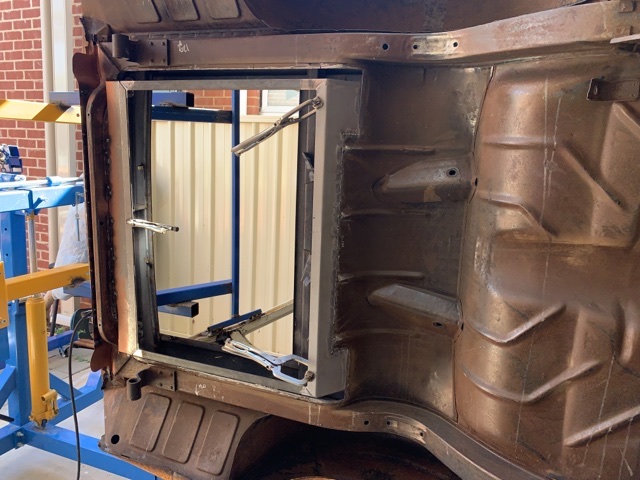

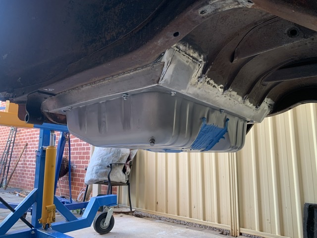

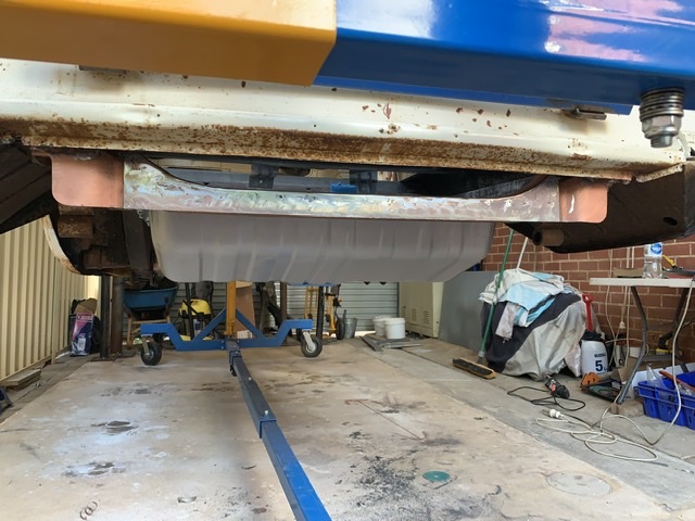

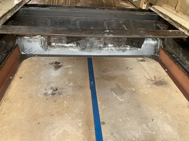

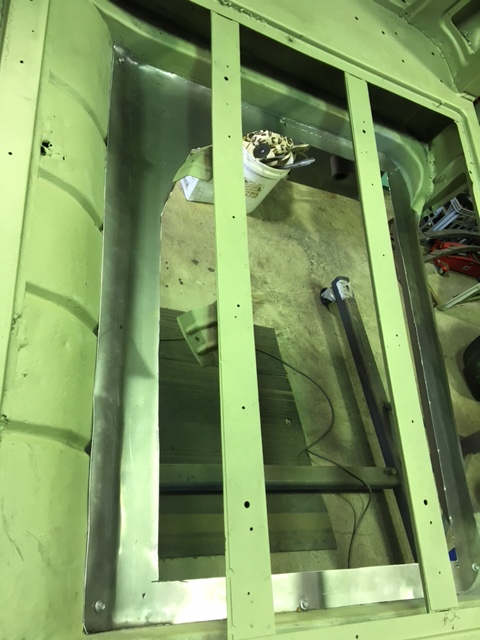

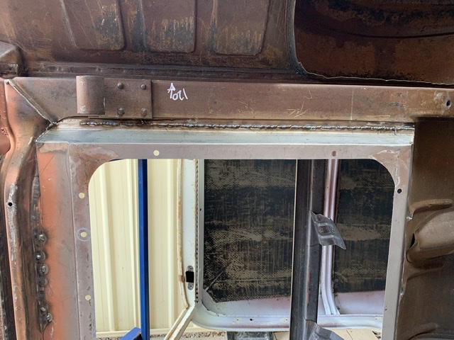

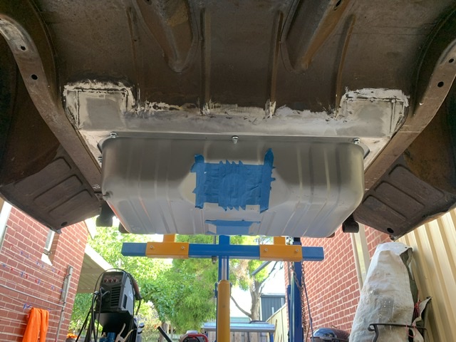

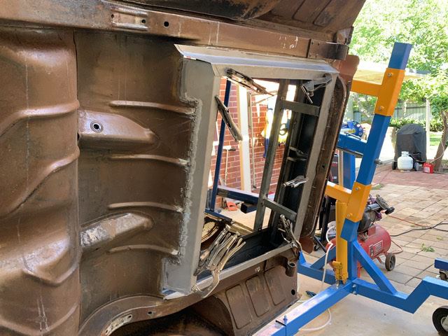

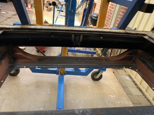

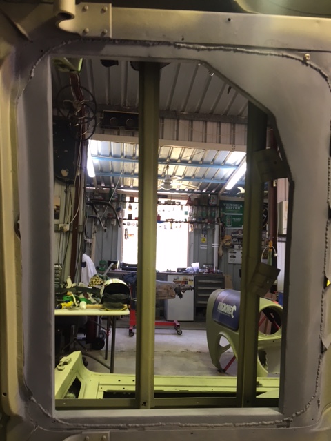

Anyway here are some photos of how I and others have done the commodore tank mod.
Frame to fit around the tank top
New floor surround
Welded in
Tank sitting in place
Straps fitted

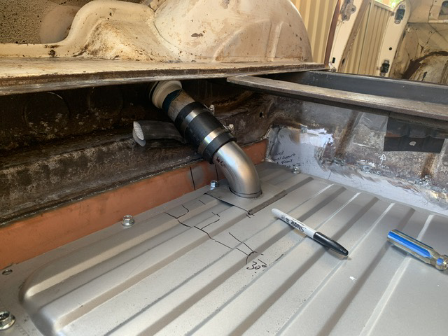

Filler neck moved to suit the Ute

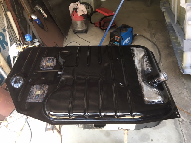

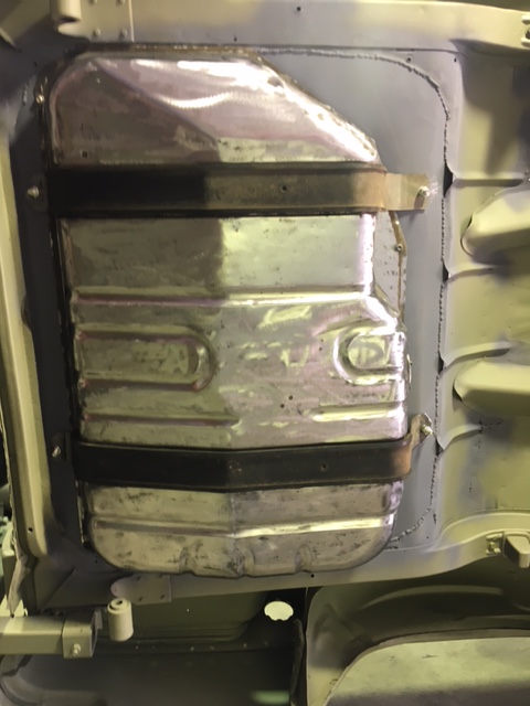

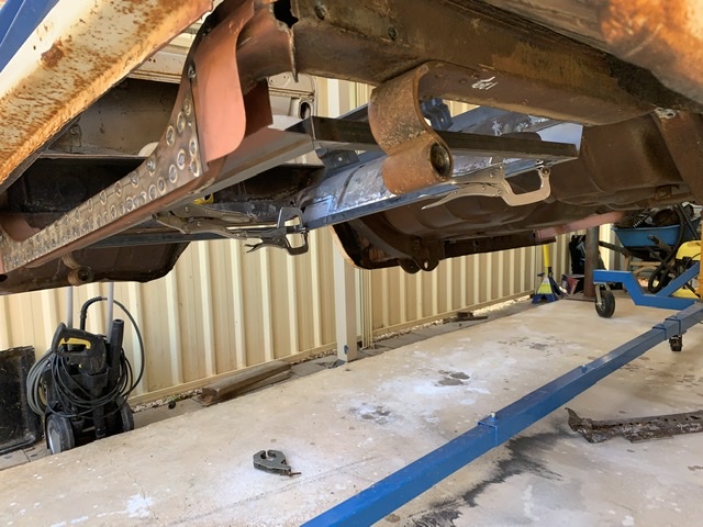

Here is a few photos of the mustang tank install that I am working on...
Drew
FbSTDwagon
Posts: 790
Re: FUEL TANK REPLACEMENT
Post by FbSTDwagon »

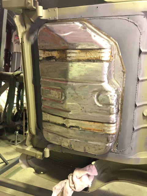

And some more pics
Drew
FbSTDwagon
Posts: 790

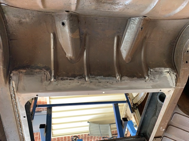

More
Drew
FbSTDwagon
Posts: 790
Filler neck dummy up
Drew
Posts: 2586
Great job Drew,
Very well done indeed.
Posts: 11307
Nice work mate. Thanks for posting.
