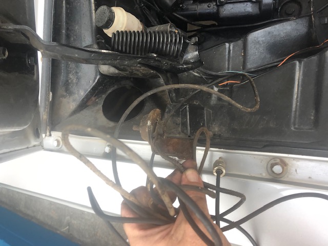

Posts: 5654
Re: Harv's HR Holden Premier wagon
Yesterdays find.
What do you do if your aerial is not working (say it will only find Radio National :mrgreen: )? You put another one into the guard on the opposite side of the car. This leaves you with a dead aerial. What to do with the old dead one? You leave the old bayonet connection flopping around under the dash. That leaves you with about 6' of coax cable, and the aerial gutter mount bit under the bonnet. Just stuff those down the hole between the inner and outer guards (the round hole to the back of the photo below). Of course, being a caring person you don't want the car to rust, so you apply fishoil into that cavity... the coax and gutter mount may bang around a bit, but they will never rust.
Nice to have only one aerial again.

Such care to detail... fishoil... might have been a lot worse without it... at least the aerial lead is dead...... what's in the hole on the other side?
