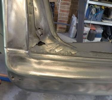

Bottom of the A pillar wasn't great, not as bad as the passenger side and at least I salvaged the bolt hole.
RH A Pillar fixed.JPG (34.92 KiB) Viewed 1146 times
Still have to address a few small areas in the dogleg and then tackle the rear quarter mess.

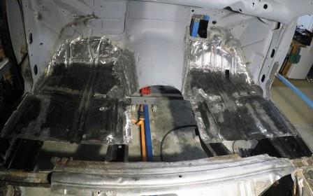

The rear qtr panel has scared me off for now so got onto to the lack of flooring...
No floor.JPG (40.11 KiB) Viewed 1068 times
Rares pans went into with some massaging. And I did KBS all the support structures.
Rares pans.JPG (41.01 KiB) Viewed 1068 times
Did some patchwork for the footwells. Beads aren't quite the same size and despite trying to creep up on my patch shapes still managed to get it wrong. So not perfect but finessing with heat, relief cuts and hammer it's good 'nuff. All be covered anyway.

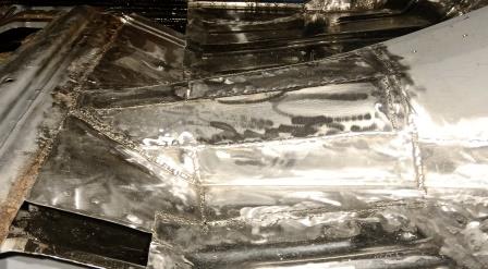

And the first bit of extending the tunnel. Not fully welded in yet but worked pretty well.

So the first bit of transmission tunnel went well. But after I added on the second bit I wasn't so sure...
Tunnel wrong angle.JPG (975.44 KiB) Viewed 977 times
The tail of it was kicked up at an angle to finish in the right spot at the crossmember. I had done the tunnel in two bits as my bender is only 300mm wide. And with hindsight I should have welded them together first before coz I obviously didn't get the right angle to start with. It looked like it only dipped 20mm at the join and I tried to convince myself there would be room for the Hydromatic (but I don't really know). In the end it bugged my so much I had to fix it.
Tunnel fix.jpg (23.68 KiB) Viewed 977 times
Pretty easy in the end. I just cut away the top panel from each side and cut the top panel where I had welded the two tunnel bits together. This let me push it up into the correct position and cut and butt it into place. Then shaped new side panels and welded them in. Lots of welding all up but better result.
tunnel sides.jpg (29.52 KiB) Viewed 977 times
tunnel finished.jpg (32.1 KiB) Viewed 977 times
