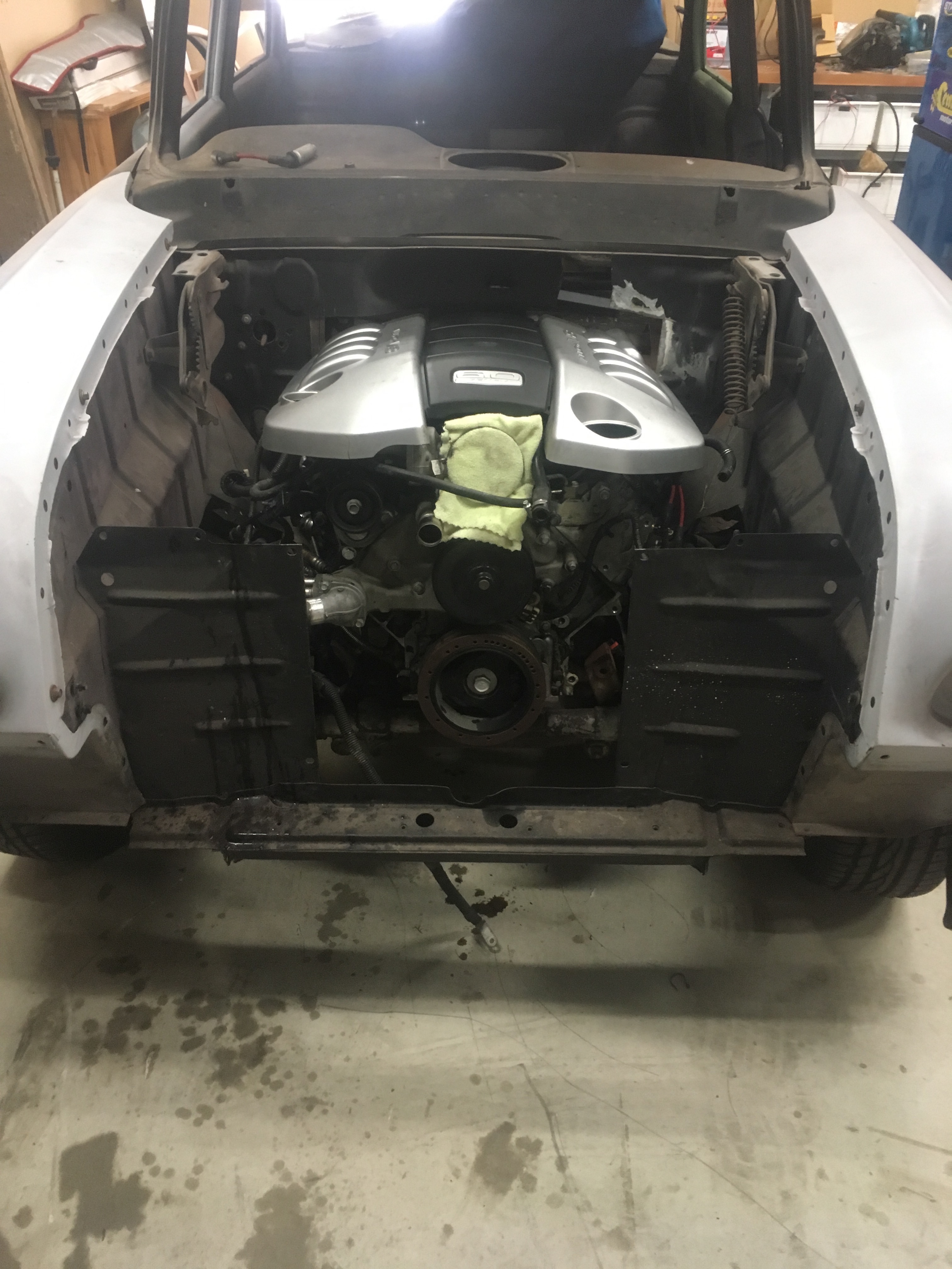

So i had to sit the motor in the engine bayImageImageImage
Sent from my LG-K500 using Tapatalk
Posts: 14334
Re: LS1EK
looks like theres plenty of room in there :thumbsup: :thumbsup:

if thats the finished height its sitting at there will be heaps of room to build a set of extractors / headers to fit inside the subframe :thumbsup:

CHOPPED wrote:if thats the finished height its sitting at there will be heaps of room to build a set of extractors / headers to fit inside the subframe Image
Cheers Chopped, i am thinking of going with the OEM headers first up as i am hoping to tyrno it once paased by the engineer so don't want to waste money making pipes that will be changed. If i don't turbo it Castlemain rodshop now do headers which fit inside the guards for $900 which i guess is reasonable as its at least a two day job to do a set of pipes.

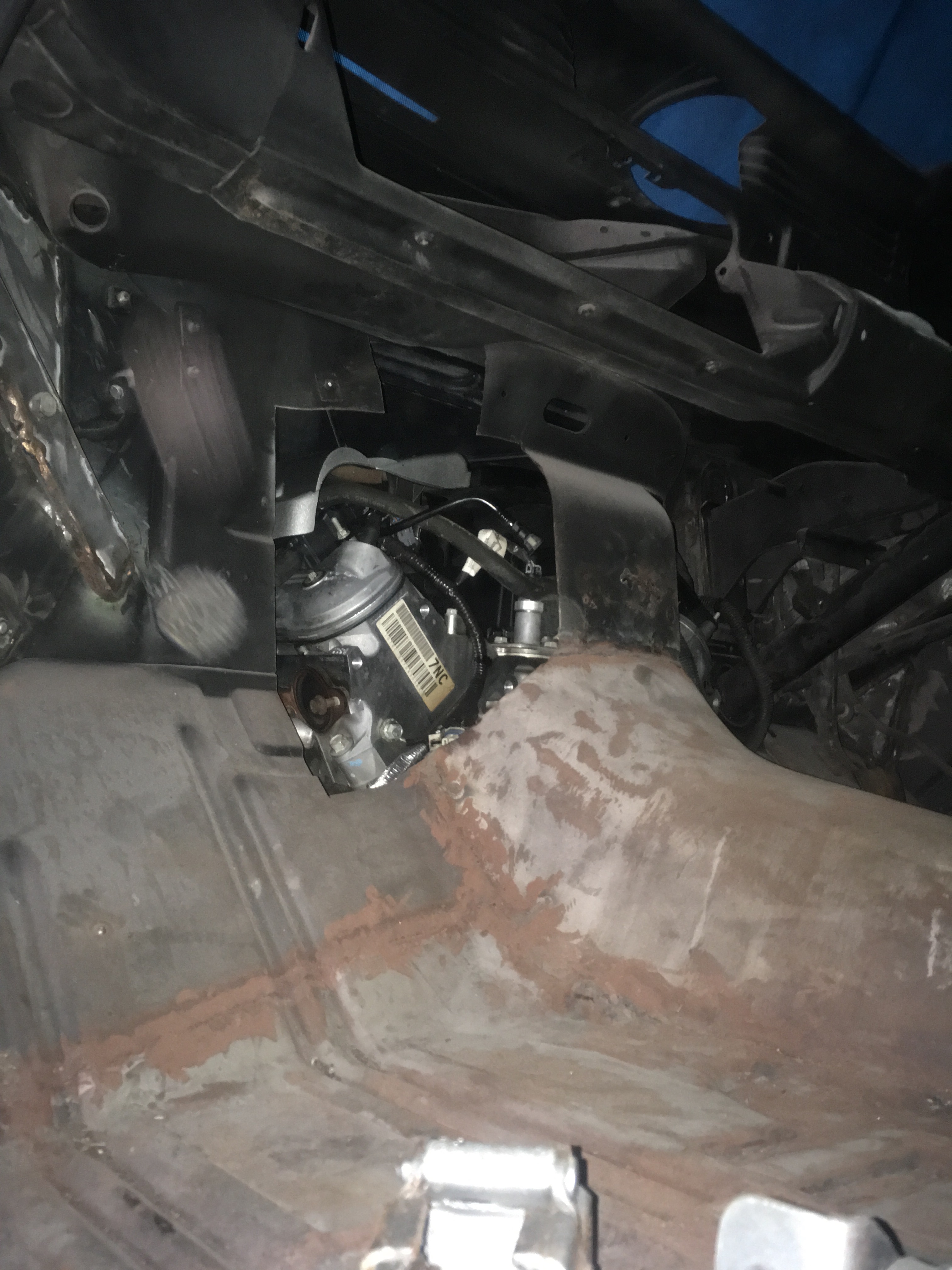

Yeah i have made a few sets before, getting lazy these days though and smarter especially if you buy them already done for under a grand. Its now in its final resting place, need a rear sump oil pan and might have to change the screw drivers over for bolts in the engine mounts Image ImageImage

mate you will never get that regoed with one phillips and one straight screwdriver
need to go the both as phillips :D

CHOPPED wrote:mate you will never get that regoed with one phillips and one straight screwdriver
Haha very funny, am tjinking the motor will need to be raiaed as it is very tight fit gor pipes, OEM headers don't even look like fitting.
