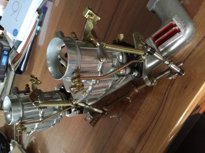

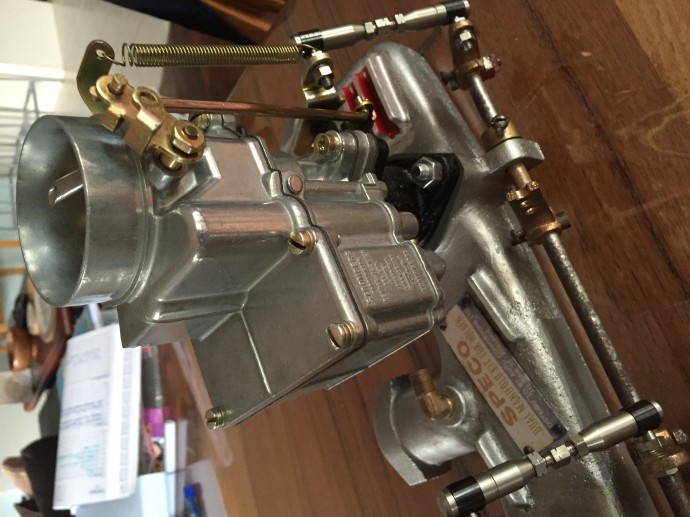

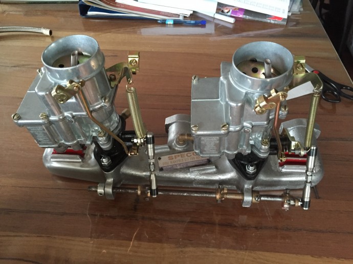

Got the twin strombergs fitted up to the Speco manifold this week - looking good
Only thing I'm not totally happy with is the bar and the brass linkages - the bar is an easy fix and will replace with a nice bit of stainless but what are the thoughts on the levers - as you can hopefully see form the pics the centre lever is broken at the top hole - do I need the top hole - can I just tidy up the centre lever and stay with the brass ones - the option is a redline set but they look a bit cheap and nasty - I also see that Stromberg have some die cast levers but they are used in different orientation to the old type so not sure they would work the same?
Any comments/advice welcomed.

Wally,
Those brass levers are worth keeping. The Redline ones are stamped steel, and allthough serviceable are pretty cheap. You can also get ones from the Sydney Carb Service Co made of brass with a wedge-clamping design... pricier but very neat and no slip.
Whether or not you need the top hole on that brass throttle lever depends on how you set up the rest of the linkage. Grey motor twins were not a factory fit, and need some modification to the throttle bars/linkage. Some people opt to replace everything with a cable, others modify the bars/linkage.
As a starting point, put your carbs somewhere secure, either on an engine or in a vice. Move the brass throttle lever from closed to Wide Open Throttle (WOT). Check that your linkage actually delivers WOT... some do not get the throttle plates fully open!
Once you are sure that the carbs get WOT, get your ruler out and again mover from closed to WOT. Measure how far the brass throttle lever needs to move. It looks like you have five different holes, so you will get five different distances - the holes closer to the rod move less.
Your task is then to connect one of those holes with a part of the GMH throttle bars/linkage that moves the same distance.
Lets start with the little lever that pokes through the firewall near the accelerator pedal. You could attach a cable to it, and get the cable to pull your brass throttle lever. On my FB sedan, that firewall lever moves only about 12mm at the tip. That is probably not enough for one of your brass lever holes. You could weld a bit more steel bar on the firewall lever to get more swing. Extending my firewall lever 40mm would give me 35mm of travel. Still not really much, but may be enough for one of your brass throttle lever holes.
Maybe instead you could connect to the bar that sticks out from the firewall over on the passenger side. This one swings a bit more - my FB sedan moves 35mm at the tip. You could weld (or bolt) a bit more steel bar on to this lever too to get more swing. Extending mine 100mm would give 50mm travel, a 200mm extension would give 70mm travel, and a whopping 300mm = 85mm travel. Note that this bar can extend more than the other one as there is nothing in the way.
Once you have found a part of the GMH throttle bars/linkage that moves the same distance, you connect it to your brass throttle lever. If it is a long way away, you use a cable. If it is close, you can move the brass throttle lever along the rod and use those ball-joint links similar to the ones on your carbs.

Thanks Harv - Hearing you loud and clear.
I'm going to replace the bar with a piece of stainless to make it nice and tidy up the broken end of that centre lever or maybe even swap it with the one on the left as that linkage attaches only half way down to match with the short lever on the right - that will give me a bit more leverage on that centre one for a start.
Whats the best way to secure the levers to the bar? might replace the screw bolts in the levers with stainless cap screws and nyloc nuts. Does it help to put a little lock tight on the shaft where the clamp goes over?
Re: WALLY'S EK
Best way to secure them is a very small tack weld. Need to be a better welder than me though... I'd end up with a big dob of pigeon crap. Weld it once everything is in place and tuned. The grub screws slip over time no matter how hard you tighten them.FJWALLY wrote:Whats the best way to secure the levers to the bar? might replace the screw bolts in the levers with stainless cap screws and nyloc nuts. Does it help to put a little lock tight on the shaft where the clamp goes over?

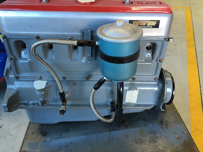

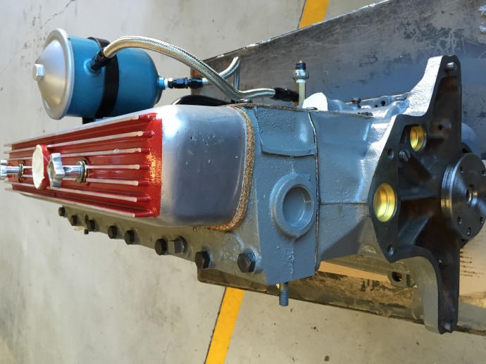

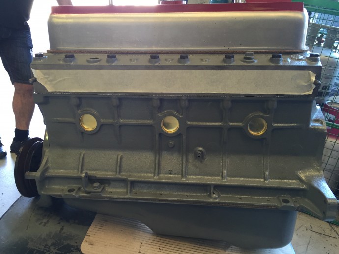

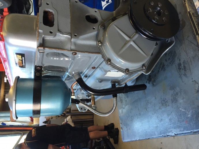

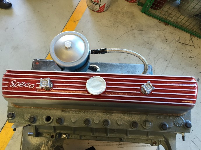

Motor is now done - very happy with the job thus far from Top Torque
+20 thou bore and pistons
All new bearings and re-surfaced journals
New lifters and springs but used same followers with a re-surface
Head and block were both in great shape as were crank and cam so just a tidy up and they went back in.
New valves with unleaded grind to suit.
had dizzy converted to electronic with a new coil/leads and plugs
Twin carbs and a set of pipes going on as well so it should run sweet.
Restored Remote oil filter fitted also.

G'day Wally, the motor looks great.
You might want to check the oil filter connections though. The return to the block should come from the centre port at the bottom of the filter housing not from the drain port where it is currently connected. As it is it won't filter any oil at all.
Re: WALLY'S EK
Hey Craig - thanks - I did question them about that this morning but they reckoned it was correct - When we get it back I'll get it swapped over - cheers
