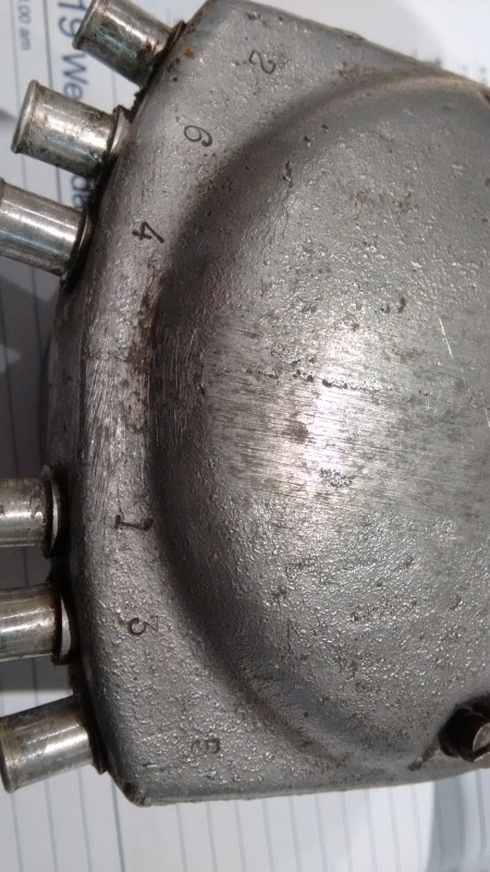

HI Harv,
I am looking at the picture of the 6cyl shielding hood on the first page, the firing order stamped on the shield would suggest this is from an anti clockwise sequence (looking from the top), am I reading that correct? I have just acquired the same hood and noticed mine is the same , left to right reads 2, 6, 4, 1, 3, 5

G'day Tom,
Cool find. Post some pictures if you can (we love pictures).
It's hard to tell the rotation from looking outside, as the shield may be wired differently inside. Easiest way is with a voltmeter/ohmmeter to see exactly which wires on the outside go to which posts on the inside of the cap.
Even if the shield is from an anticlockwise maggie, you could still run it on a clockwise maggie by just choosing the right cables in the right sequence (and ignoring the numbering on the outside).
You can even turn an anticlockwise maggie into a clockwise one - working my way through understanding the process as we speak. Re-setting the e-gap is (relatively) easy, though I still gotta understand the finessing that needs to be done on the points cam.

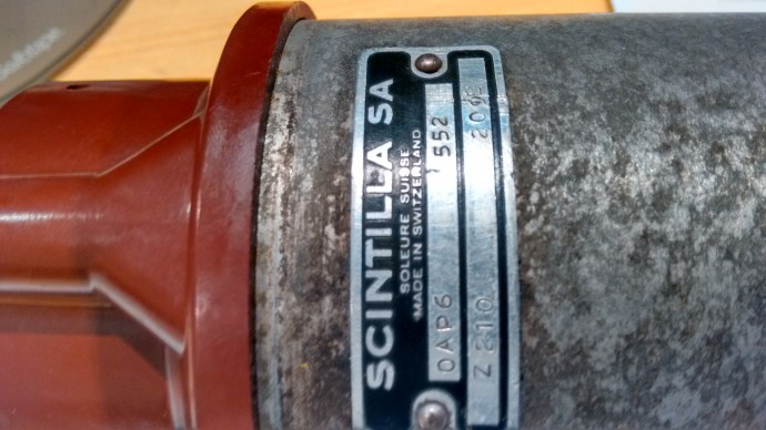

Re: Harv's grey motor magneto thread
Thanks for the reply Harv, a wealth of information. A few pics following
- IMG_20150821_082253191_HDR.jpg (70.24 KiB) Viewed 9457 times

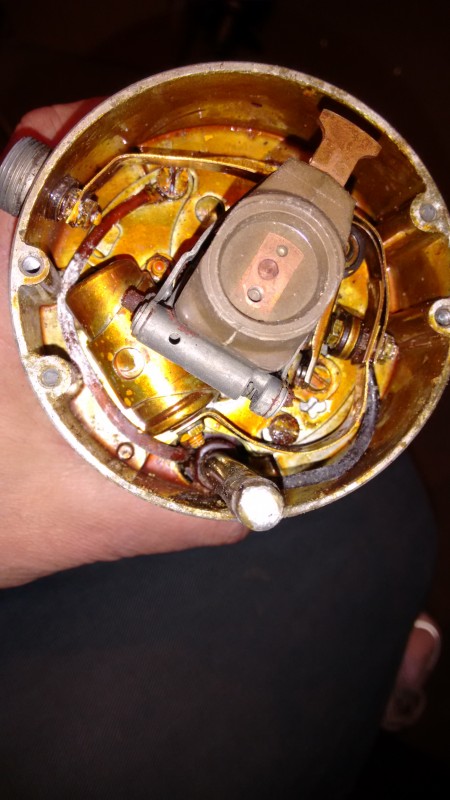

Maggie Internals
- IMG_20150821_074648715.jpg (84.72 KiB) Viewed 9458 times
shielding Hood
- IMG_20150821_081713021.jpg (110.67 KiB) Viewed 9474 times
