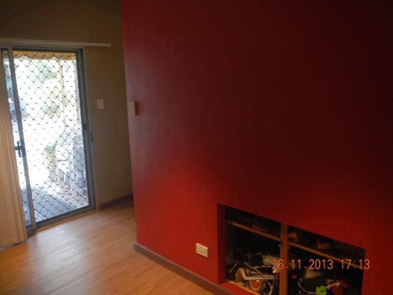

Well the lounge is finished. Apart from a few little things ie: vanish the Jarrah, and a few touch up bit of painting.... Anyway I hope you guys enjoyed the reno....

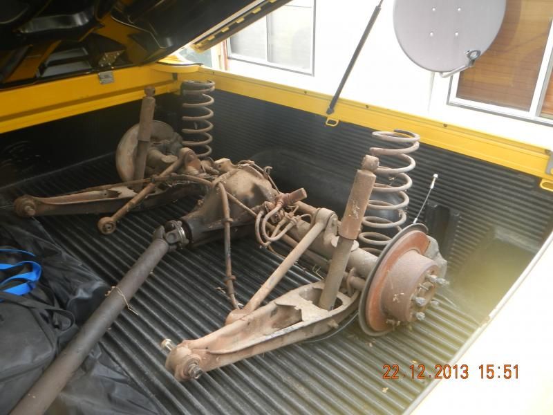

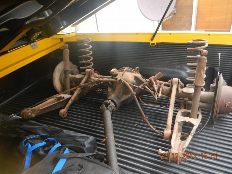

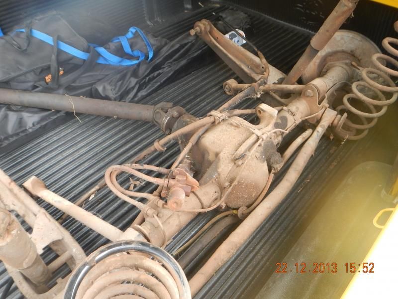

Well I picked up a complete Volvo 240 diff today. Will drop it off at Classic Olden tomorrow to have it set up for the EK.
Posts: 14242
Re: 1961 EK Holden Build....
sweet -how wide is it from wheel face to wheel face ???
GM_1961
Posts: 55
Joined: Sat Oct 12, 2013 7:47 pm
Location: Carine WA
Post by GM_1961 »
Blacky wrote:sweet -how wide is it from wheel face to wheel face ???
1406mm.......

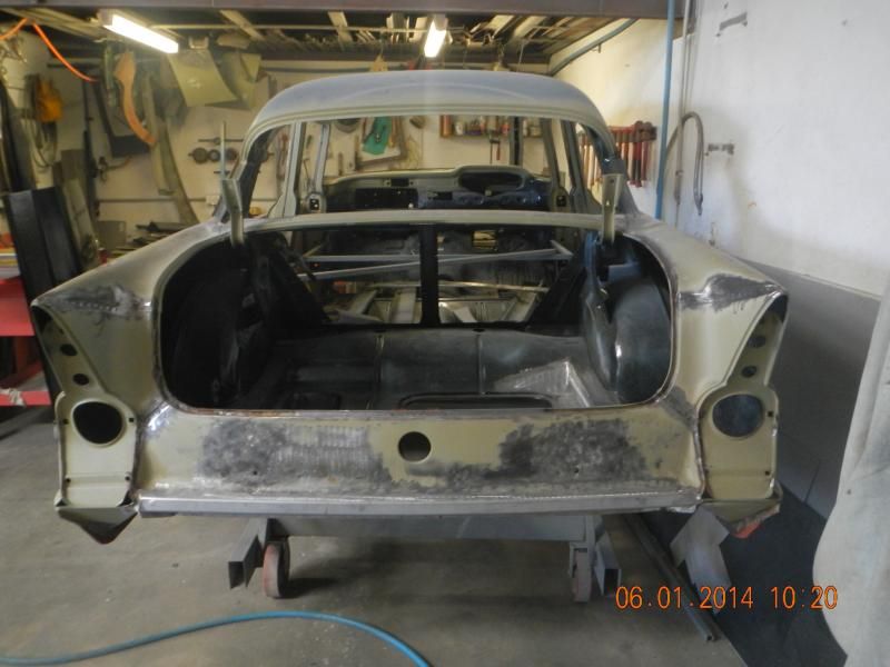

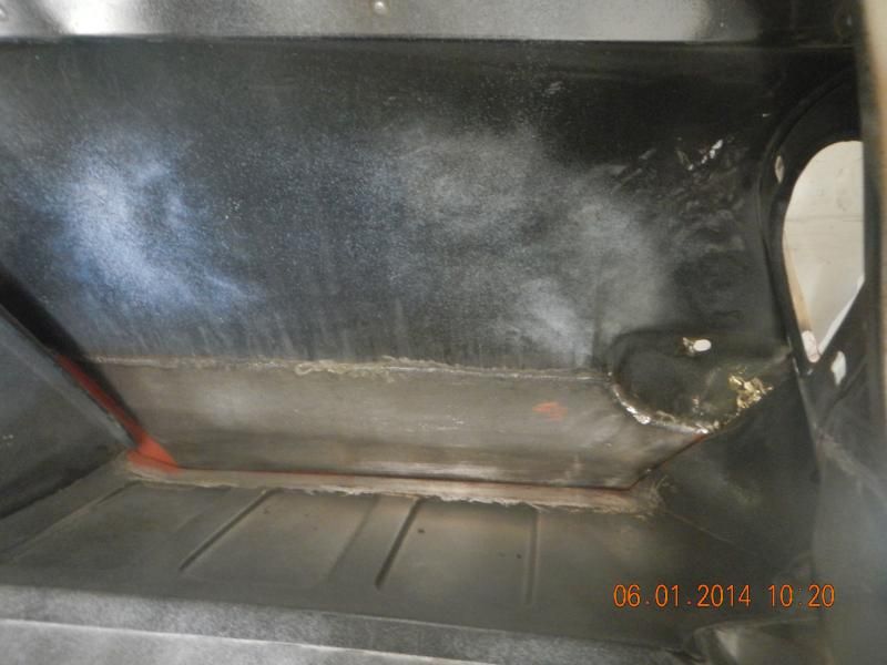

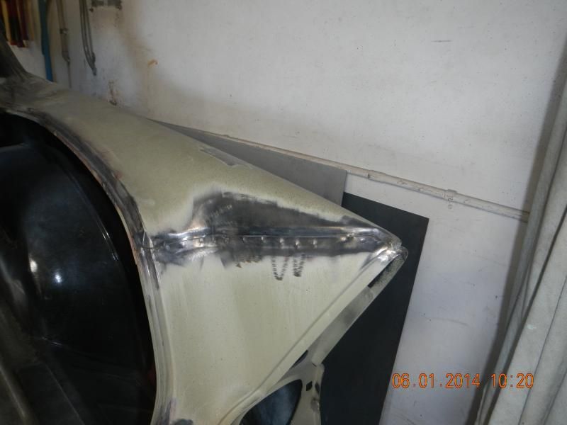

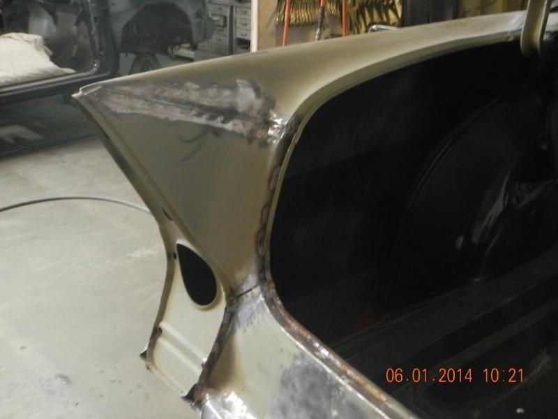

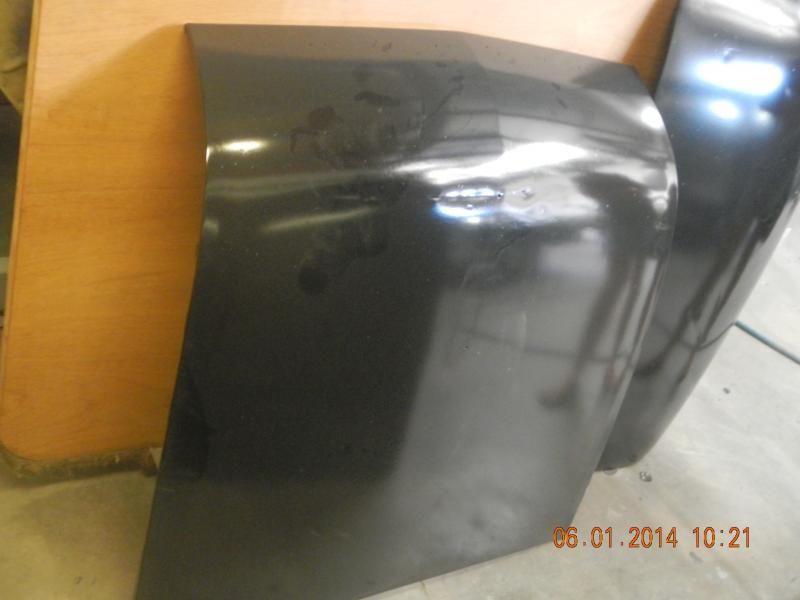

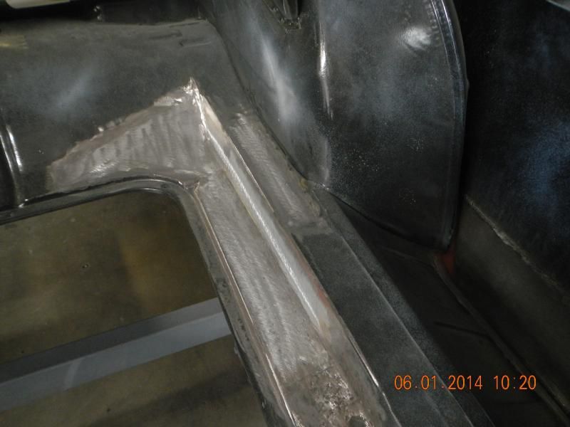

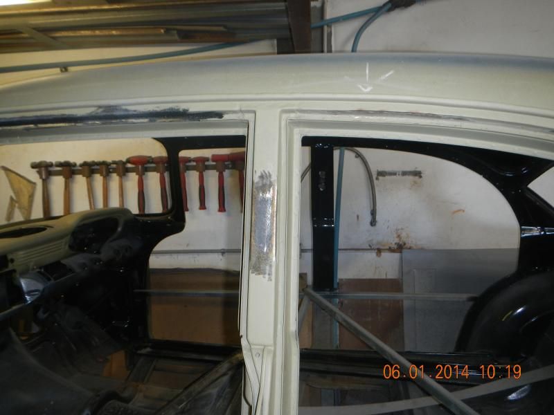

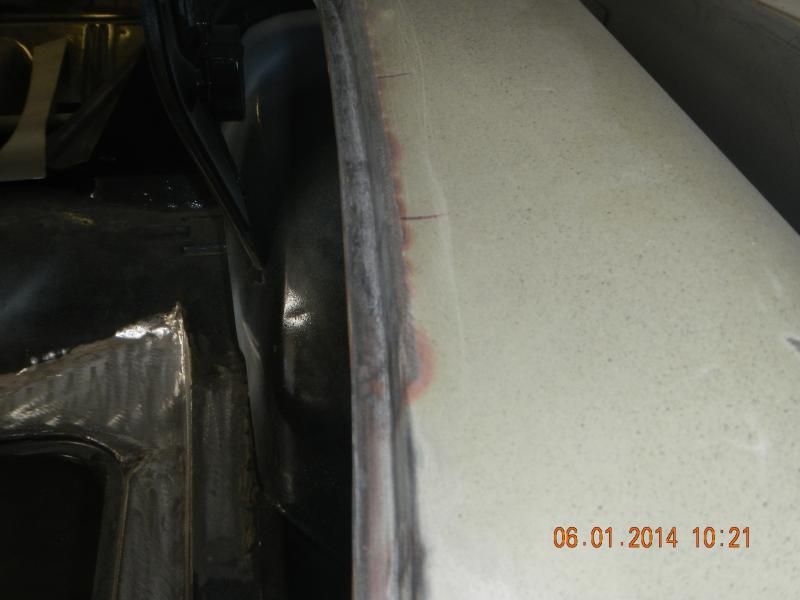

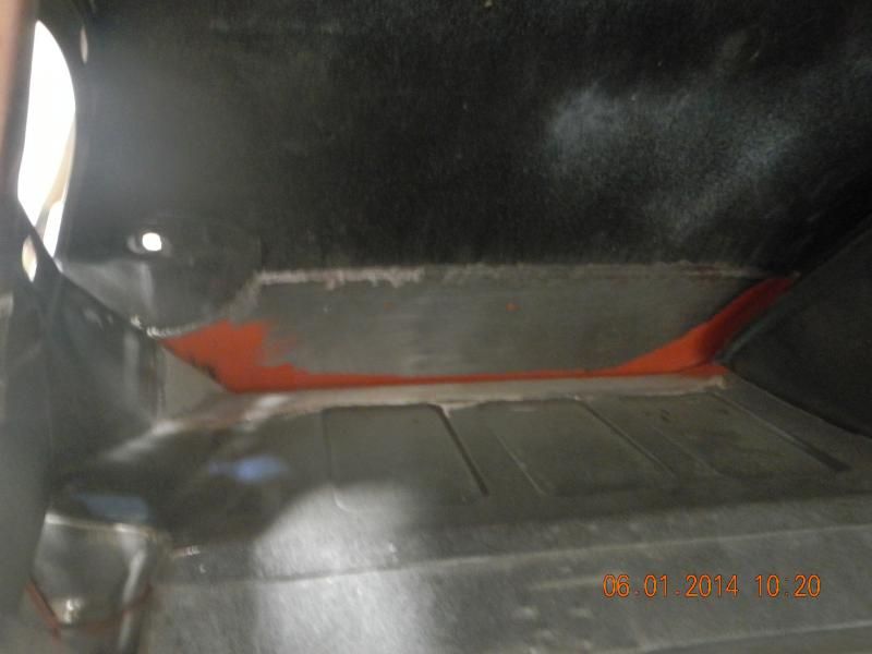

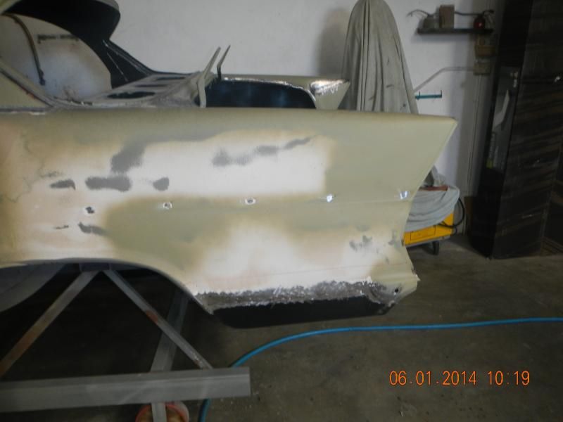

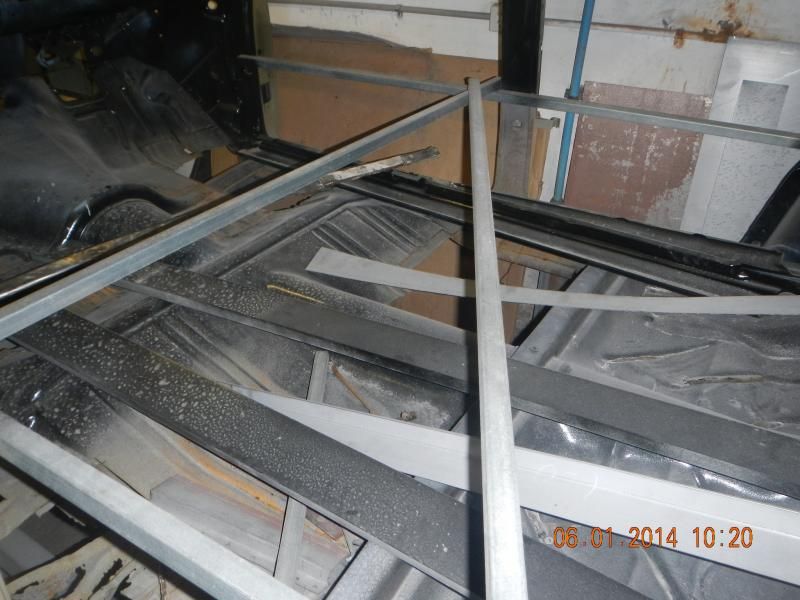

Went to see how everything was going with the rust removal and was surprised to see only the floor left to go....
Posts: 14242
Good stuff - looks like they have been getting stuck in :thumbsup:

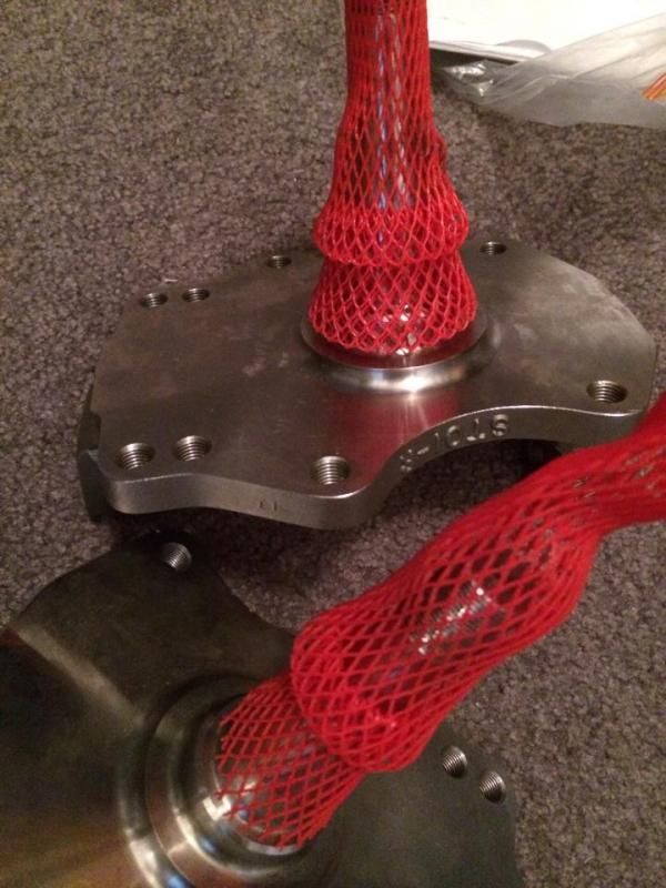

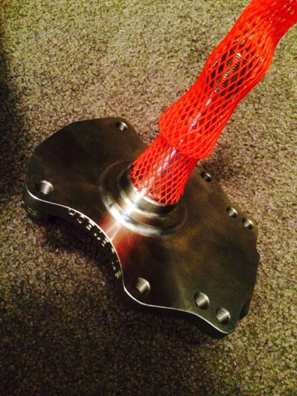

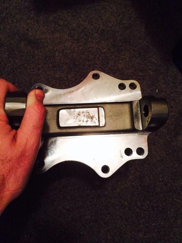

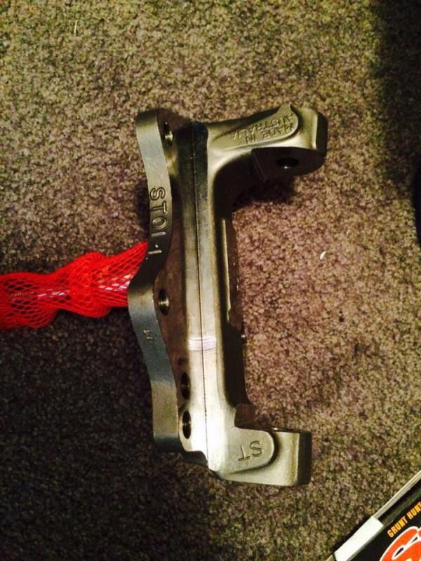

I just brought these HR/HK/HT/HG 2" drop stubs. Made by Stubtech. Part ‪#‎ST001‬.
http://www.stubtech.com.au/
I do have a question about them. These are designed to take HQ - WB disc brakes. Can I somehow get them to take Commodore stud axles and disc brakes?
O, I brought them privately, so the guy didn't know.
Posts: 14242
Why do you want to fit Commode brakes ? Why not run HQ/WB style ?

A wide range of brake combo's is the main reason. Plus I want Commodore stud patter all round for wide range of wheels as well.
Posts: 14242
You are going late model style with the build ? You cant get early style wheels in Commodore stud pattern, centreline, Weld , etc.

I changed the Commodore stud pattern on my V6 EK to HQ by offset drilling the axles and rotors in a mill and fitting oversize wheel studs, piece of cake

Thanks for that guys. I will use HQ disc and stud.
With the Volvo 240 diff the guy said early Holden rims will fit it. So dose that HQ rims will fit?
I'm hoping so, as I have put off getting it converted ATM because I was think a VN - VS diff would have been a better way to go.

Just one suggestion - whilst they're still welding stuff in....
Have you considered widening and making a deeper spare wheel well?..
I wished I'd done mine - there is no way the 14 x 7 Dragways and 205 tyres are going to fit mine...
There's heaps of room to widen it - the big flat section can be eaten into for width.
I haven't thought about depth yet... but am on the lookout for a larger well which can be migged in.
