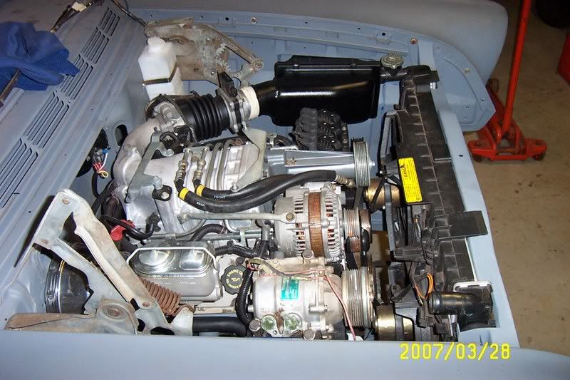

Ratbox,
There's not much room left in the engine bay alright, I was going to try to squeese in a battery also but got the shits and decided to put it in the boot.

Just a couple of more quick happy snaps.

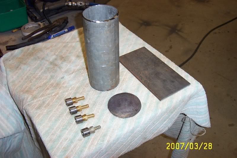

The next job - bits to make the surge tank.
I don't know how you guys squeeze V8's in these things.

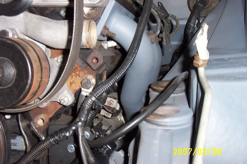

And for you greg, the extractors and the two 3inch high flow cat converters yet to be fitted. I'm going to do the full exhaust system myself out of 3inch pipe with mandrel bends.

Mal,
Thats what I like to see exhaust that breaths! Do the converters have oxygen sensors as well?

Greg,
The cats do have a place for oxygen sensors to go but I used the VT commodore ones and put them in the collector on the bottom of the extractors. How are you going to run your exhaust past this bloody great fuel tank that we've both used?

Mal,
Those are 3inch High flow cats, the screw fitting provision is for exhaust temperature sensor and not for the Oxygen sensors, they are a straight bolt on replacement for the Skyline and Sueby, they'll be the treat for your motor and nice job on the extractors, plenty of good progress there.

Hi John,
Thanks for the info on the cats, I thought the fitting provision looked a bit small for oxygen sensors.
