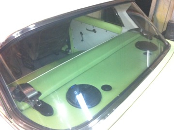

Ok, I know this is going to seem
A but humdrum as far as the build process goes, but here I go anyway. Picked up the re-upholstered back seat today from my motor trimmer, and it looks friggin awesome! Put it straight into the car and looked at it, sat on it and looked at it again. I can really appreciate the skill and patience that goes into motor trimming. Then I sat in the front and listened to the stereo for a while. Sounds excellent now with the back seat and all the windows and carpet in. Even has that new car smell. While I wait for the motor to come back from rebuild, however all I can do is sit in the
Drivers seat and make "broom broom" noises. Noting wrong with a grown man doing that, is there...?
