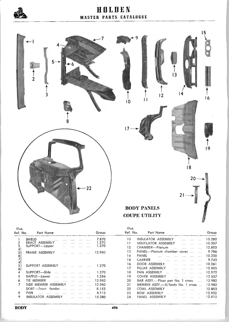

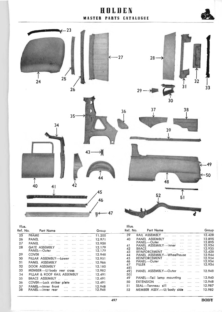

hey Danny... WOW!!!
thats some rust.
heres some pix from parts manual that might ??? help. good luck mate.
sam
sam
