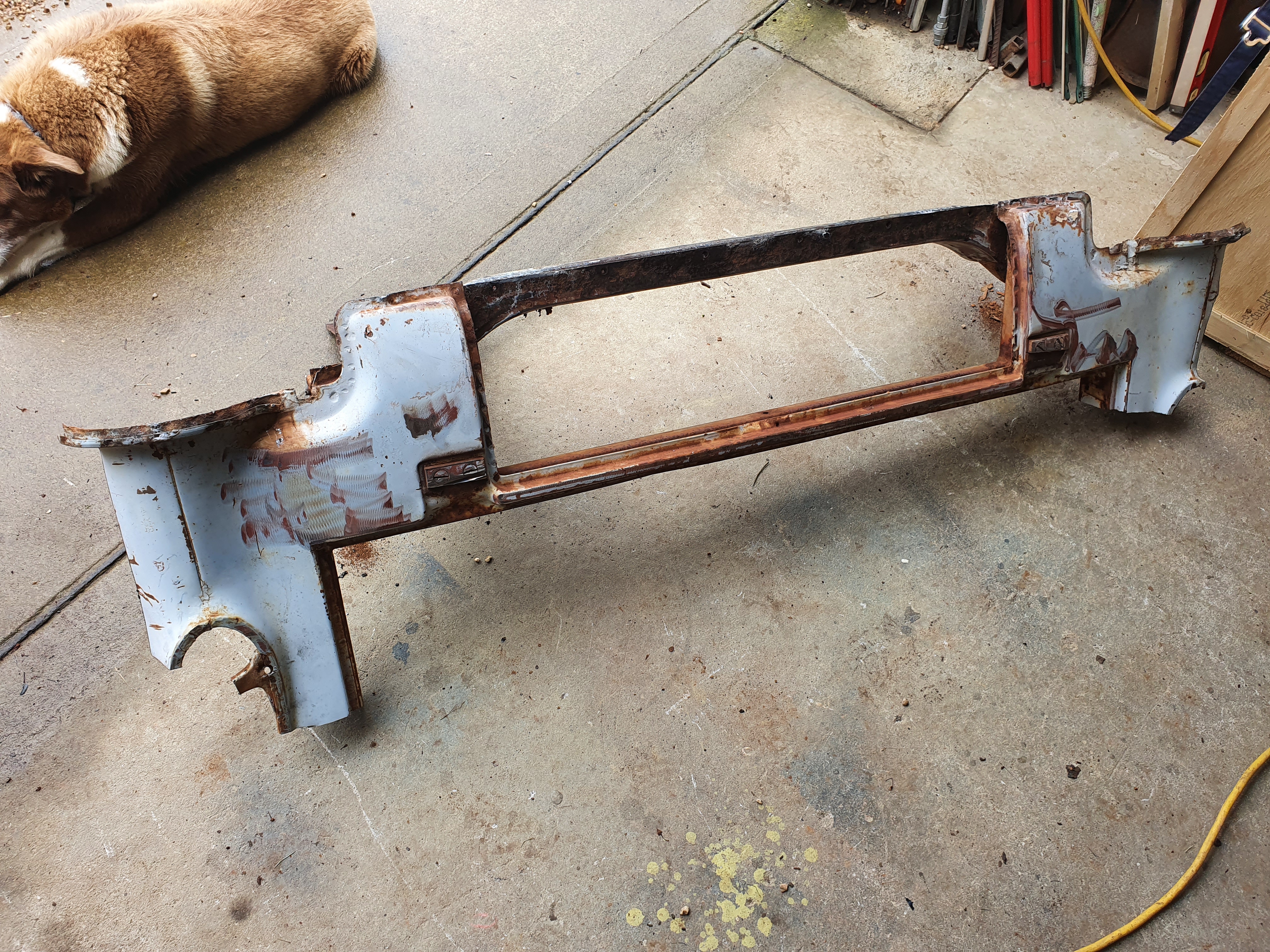

Doing some alignment work for right hand rail replacement. These pieces from old rusty FB ute and the panels and spare wheel bottom cross piece coming from the FC.
Looks better alreadyImageImage

Good stuff mate, are you going to go back to standard and fab up all the missing parts or fit a roll pan and do away with the spare wheel door ???
Posts: 2472
Re: Project 2.
Completely stock Blacky. Might be a few extra braces in the mix, but otherwise will look like it used to. That's the goal anyway...
