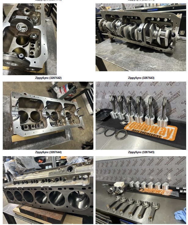

Getting close to having the FED motor here to play with. Final assembly, crating up and sending underway.
EKmart engine nearing completion.jpg (162.98 KiB) Viewed 8047 times

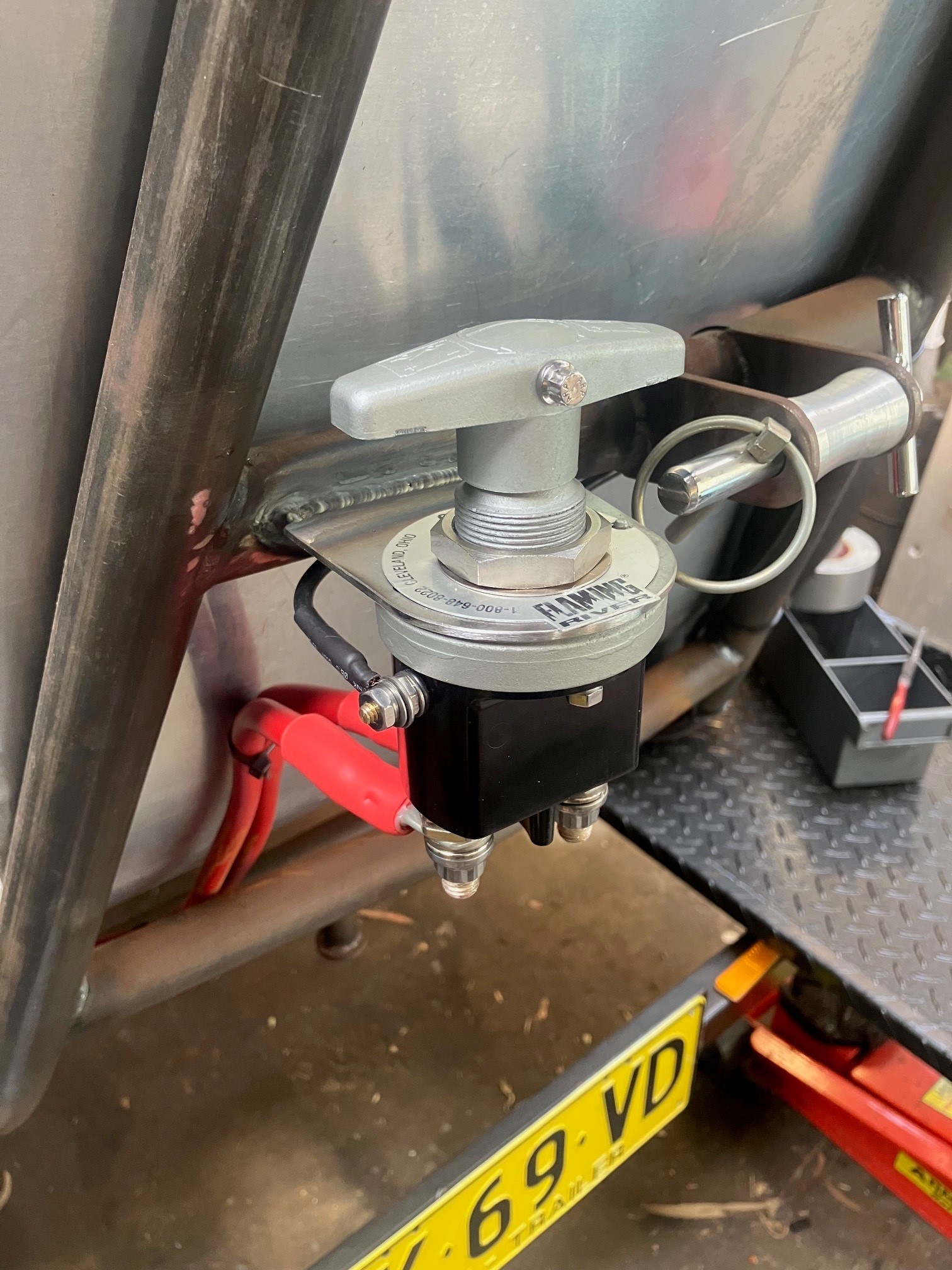

Magneto and battery kill switch bracket in and switch installed.
magneto and battery kill switch.jpg (660.12 KiB) Viewed 8047 times

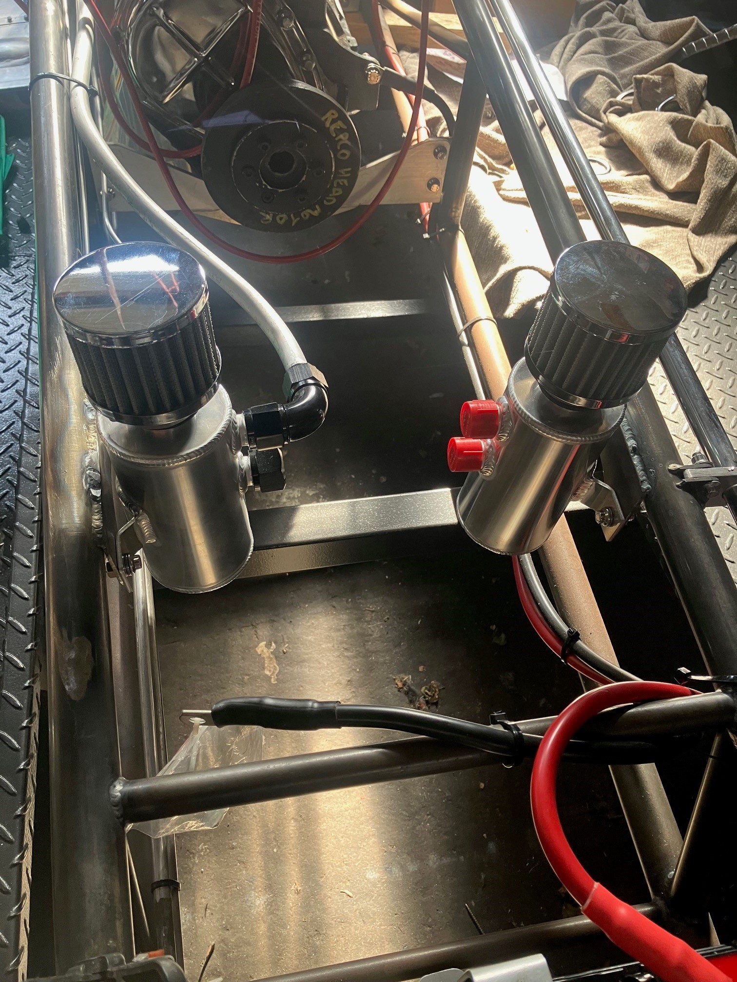

Catch can brackets in and catch cans mounted. Trans and sideplate one side, coolant the other.
Catch cans.jpg (772.35 KiB) Viewed 8047 times

Motor machine work all done, short motor assembled, and motor and Repco head all boxed up. Freight booked from WA to home, should have it by close of play Friday :ebiggrin:
Feels like four days to Christmas.
