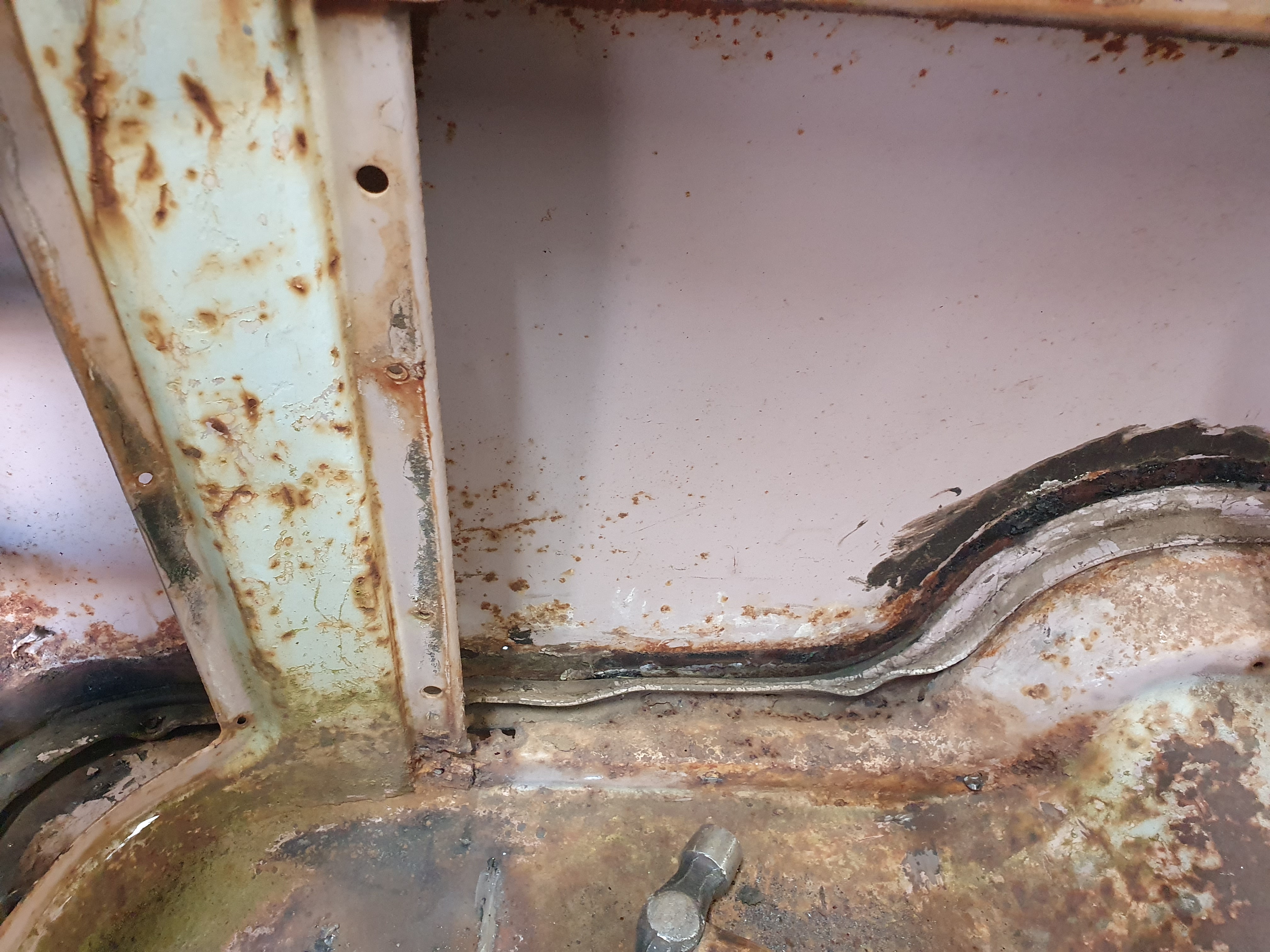

A little view of the inside of rear member rusty spring support. Unravelling the mysteries of Holden's one rusty piece at a timeImageImageImage

After a complete vivisection of 'old rusty' today, it seems that the only bits coming off the upturned FC rear are going to be the panels between the tail lights around the spare wheel door. Pleasant surprise with the condition of the rails and fuel tank surround off 'old rusty' - plenty good enough to go into this job.

What have ute restorers done about the rubber spacer that goes between the back rear quarter panel and the floor section behind the tail lights?
You know the one- its covered in tar and encourages rust😉.
Posts: 11647
Re: Project 2.
Just left it as it was fairly good. I did mastic up any vent to below floor, and mastic tonneau panels prior to screwing down.

Posts: 5737
Re: Project 2.
Errol62 wrote: Tue Sep 21, 2021 2:31 pmJust left it as it was fairly good. I did mastic up any vent to below floor, and mastic tonneau panels prior to screwing down.
Me too. Made sure the two drain tubes that run through the underfloor space were clear though.
Posts: 2530
Re: Project 2.
Thanks Clay, Harv. It's going to get a bit tricky with that rubber. I'm going to have to take it out as there will be lots of welding going on. Presume it was put on before quarter panel was attached.
