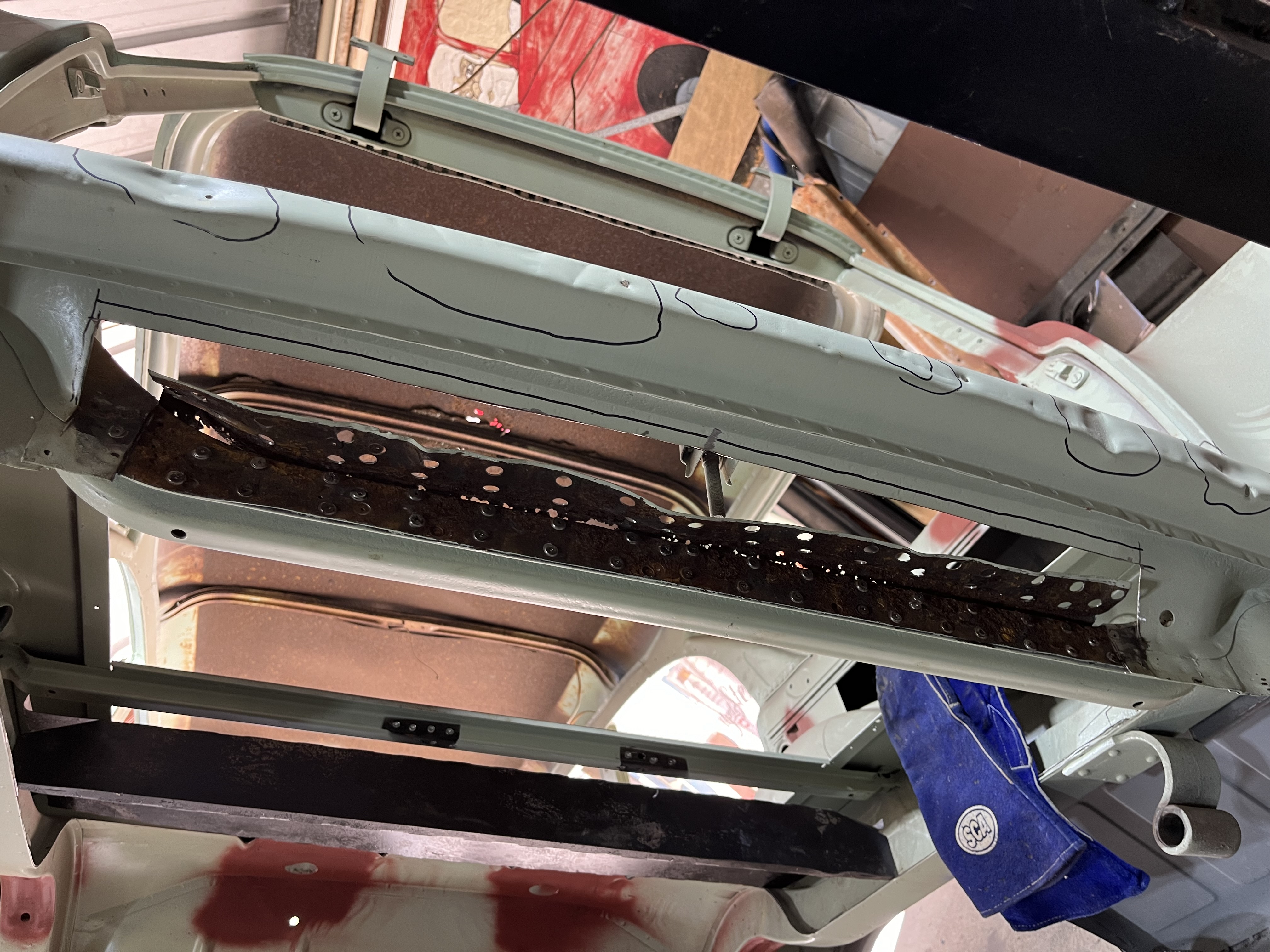

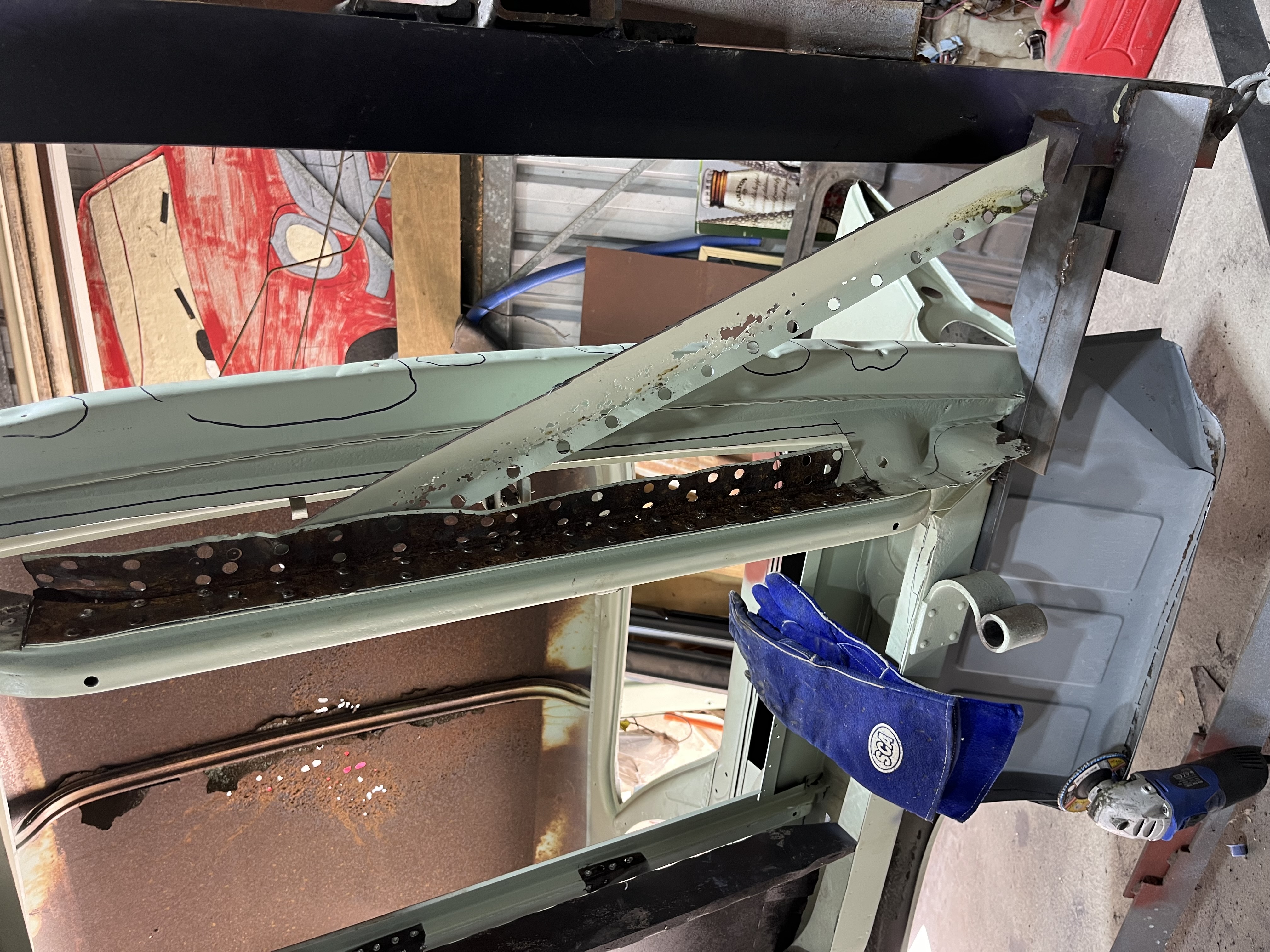

Posted: Sun Apr 14, 2024 9:58 am
by FireKraka
Yesterday I got into the rear piece I had started, found that there is actually three pieces one on top of each other and they had spot welded all three at once, so once I removed the top one I had to redrill the same spot welds, I’ve made up the two pieces but they have to wait till next time.
