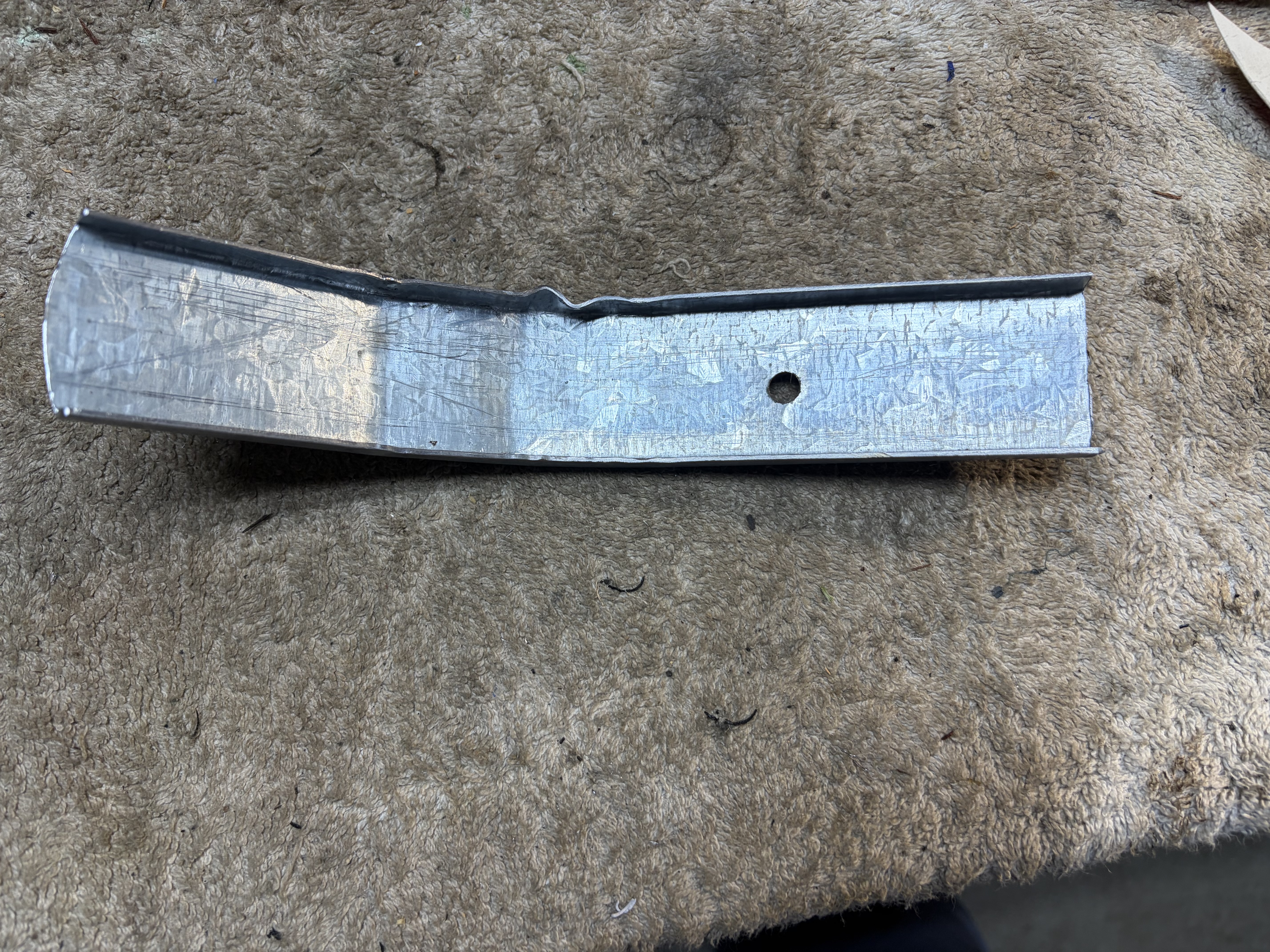

Have a spare sedan wheel clamp which I had considered trying to modify but thought I’d have a go at knocking something up that might be similar to the original style as I didn’t fancy paying $300+ on flea bay for an original one. Started this a couple months ago but it stalled until I bought my MIG welder. So time to try and multi task in making this and fluffing around learning to do panel work all the time avoiding other jobs around the house that are probably a higher priority :roll:
Made up a cardboard template as below.

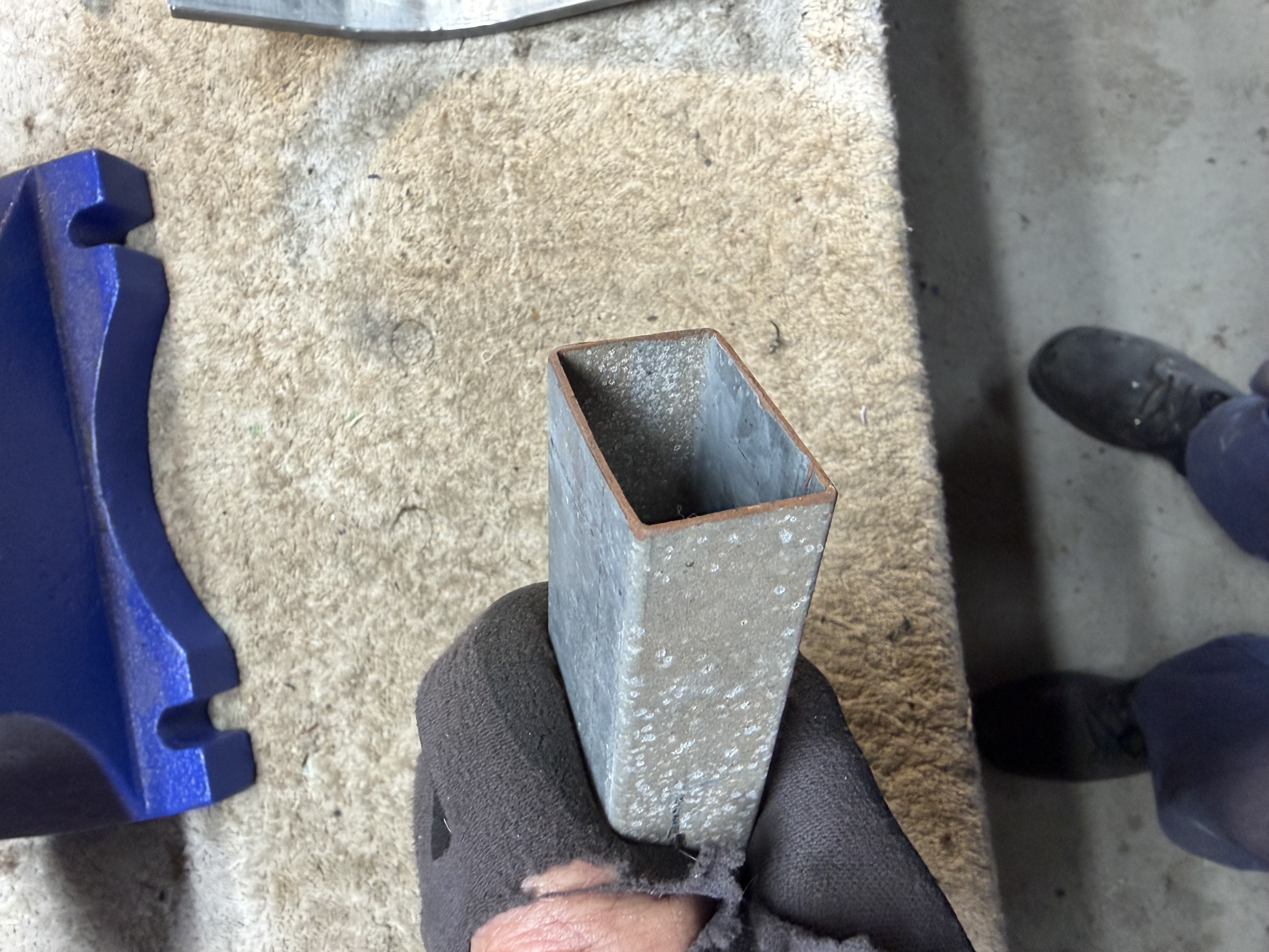

Cut a piece of RHS steel (fence rail) 38mm x 25mm. My piece is 1.2mm, ideally a piece in the same dimension but 1.6mm would probably be better.
Drilled a hole and finished the ends, then had a go at bending the piece into a curve using the vice. A hydraulic press would be better but I don’t have one. Used some pipe and a socket.
The steel had a bit of a lobster back so use a formed block of timber to try and smooth the curve out, with some success. Used the anvil to flatten the side pieces.
Made up a retaining bolt with a crush tube & spacers as well as tacking the side pieces where I had made a relief cut. Threw some paint on it and it looks like this.
