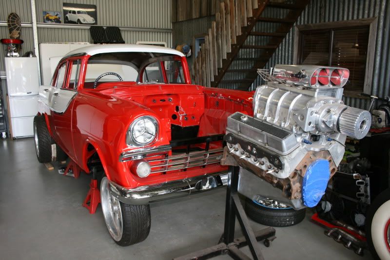

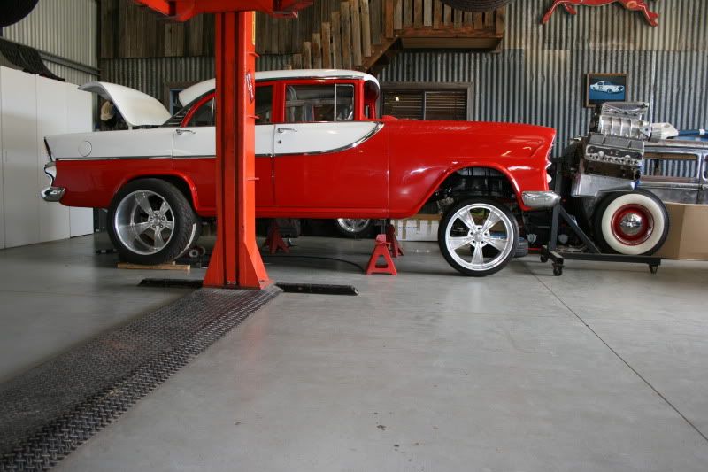

Had a change of direction, thought I'd turn her into a Gasser. :lol: :lol: :lol:
Your thoughts?
I love this motor, think it suits the FB perfectly
my70wg
Posts: 982
Location: dapto
Re: Helenor
Post by my70wg »
i like it!!!
do it
aidan...
i'll get there....
Posts: 13866
Re: Helenor
HMMMMMMM - an FB donk ????
shmeagain
Posts: 402
Location: lismore nsw
Re: Helenor
Post by shmeagain »
ITS SHMEAGAIN The back wheels are to small an the front is to low :lol: :lol: :lol: :lol: :lol: :lol: :lol: :lol: :lol: what are the wheels off
Harko
Posts: 2387
Location: Shellharbour
Re: Helenor
Post by Harko »
Must be great fun having a shed like that to play in scobb
SC00BB
Posts: 590
Re: Helenor
Post by SC00BB »
shmeagain wrote:ITS SHMEAGAIN The back wheels are to small an the front is to low :lol: :lol: :lol: :lol: :lol: :lol: :lol: :lol: :lol: what are the wheels off
The wheels are off a mates hotrod he is building, (the motor too) the rears are 18 inches wide!!!! :esurprised:
I would av driven it if I could av found the remote control :lol: :lol: :lol:

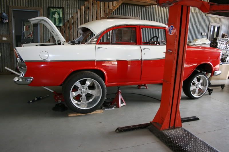

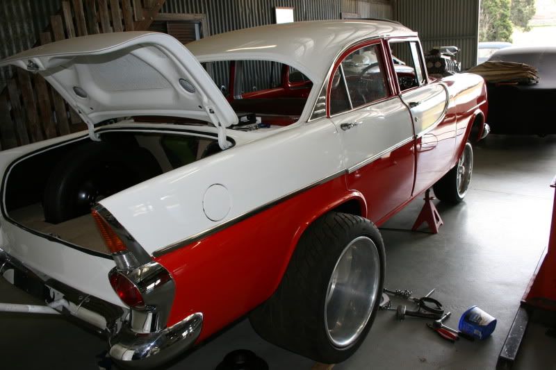

Okay back to reality

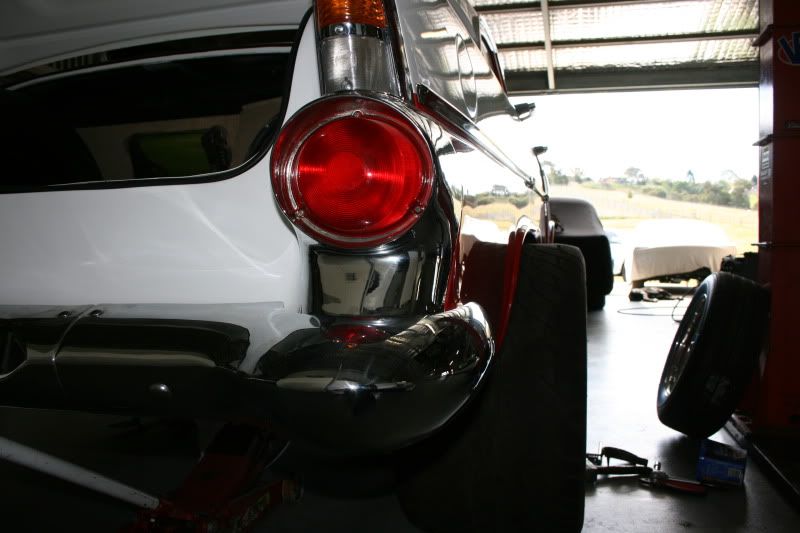

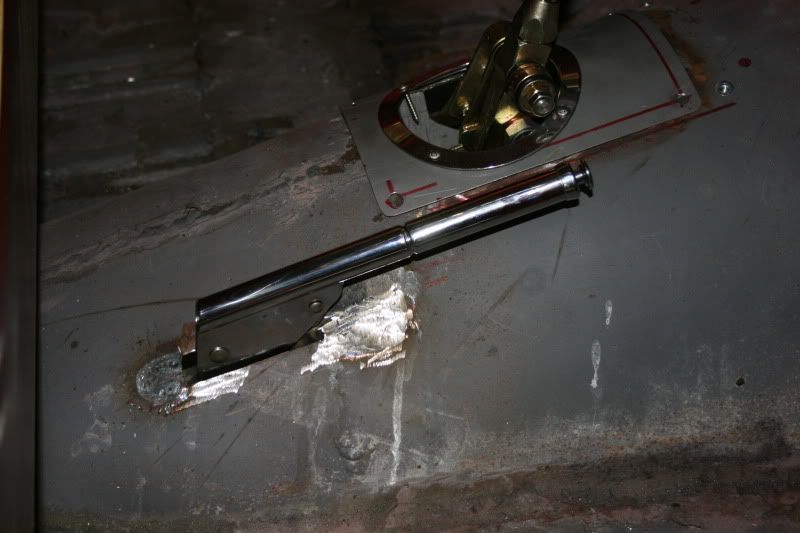

Handbrake fitted

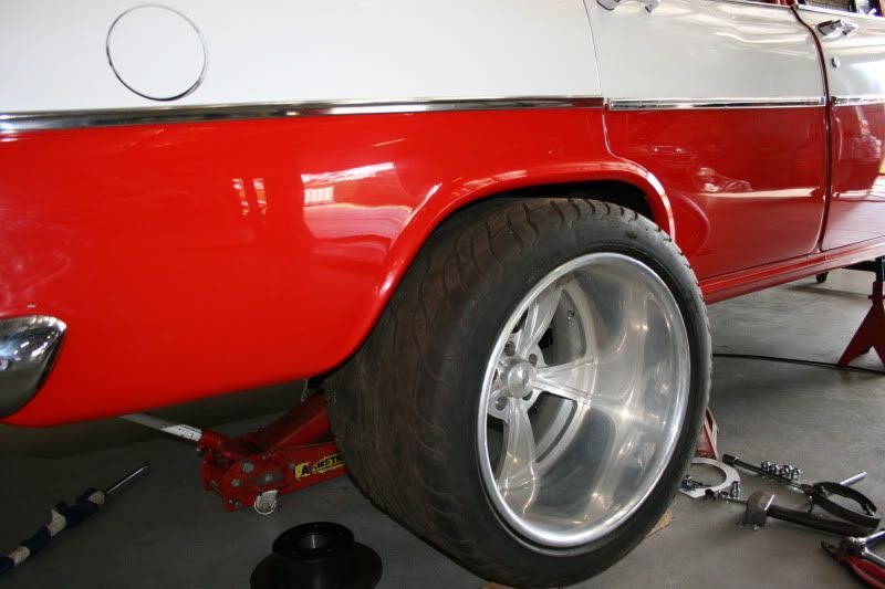

Cover fabricated for fuel filler
Did a check on the clearance of the rear calipers to the chassis rails and found they will just hit at full compression, so going to rotate the caliper down to get more clearance and adjust the bump stop so it doesn't hit.
Front end is out to get a quick tidy up
Tidying up engine bay by filling holes so can be repainted

Looking good Scoob
Just a thought, I reckon the engine bay would look better if
the red went all the way back under the firewall so you cant see any black :idea:
Its up to you though :)

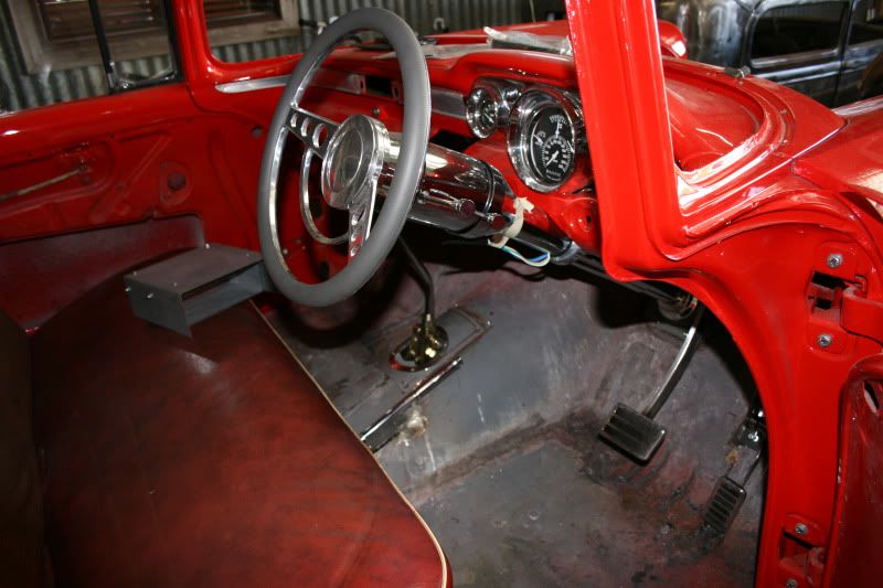

Lookin good Scoobb
What steering column you running

WesternWagon wrote:Lookin good Scoobb
Gazza
28 inch IDIDIT column :thumbsup:
