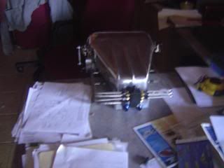

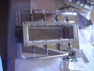

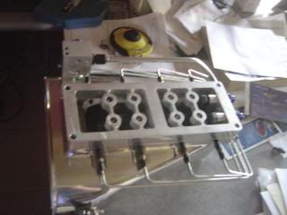

Holden 5 litre the injection setup is the same as the article in street machine mag(electronic) i got my hat and injector setup off the guy that makes them for Pro Flo.Bottom half of my motor is in the chassis at my parents house the hat is at home will go and measure for you now the hat is 150mm from top of blower case to the top of injection hat just a comparison my carbies measure 260mmImage
t
just got back from my parents place blower measures from sump to top of hat 840mm hope this helps
regards fat

Thanks Fatboy!! That does help, it looks like I will scrape in even if I go twin Carbies but that will take a bit more work (ie: sump mod). The EFI injection hat looks fantastic, read the article in SM again .... $6000.. :shock: but it would be worth it in the long run. I tried to call ProFlo but they must be shut still, can you tell me what the go is with an aircleaner?? the only ones I've seen for these hats attach to the front and cover the butterflies......

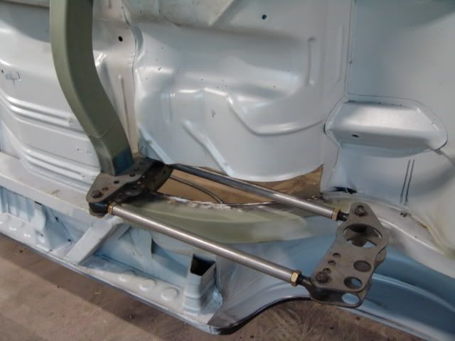

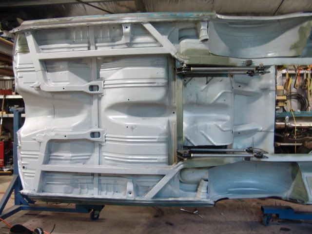

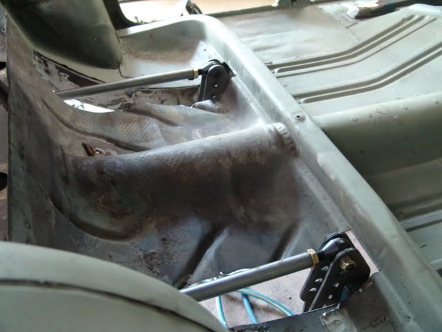

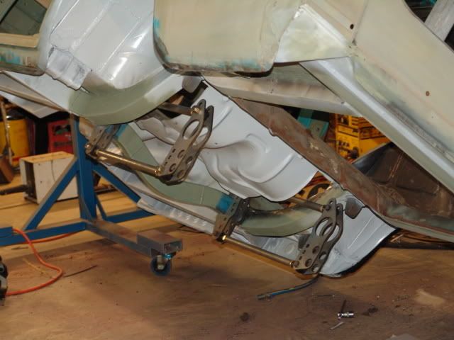

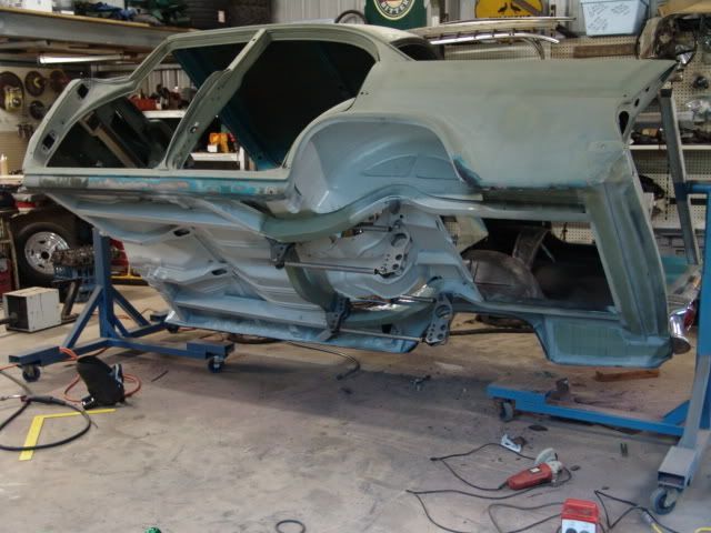

Got the 4 link cut/shut and tacked in place today. :D The area under the rear seat will be boxed in with a pressed section and fully welded, the box will have 2 sealed access panels to remove the top bolts to adjust the 4 links traction/handling setup. I wanted to leave as much of the floor as possible. that is the reason for only cutting the 2 channels out, also think it will look good when finished (different). The rear seat needs to be modified for the tubbing and a minor adjustment underneath to let the 4 link recesses snuggle in, be hard to pick once it's finished :wink:
Fit the diff tomorrow before fully welding ....... just incase :shock: :shock:

Post by mrs ratbox »
won't that interfere with the back seat?
Posts: 2694
V8EK4US,
Its obvious at this point that you've done this sort of thing before or you've just got big balls and dont mind experimenting. :lol: :lol: :lol:
Does the 4 link set up allow for axle articulation you know left wheel up right down and vice versa if so how much?
Apparently the 4 link is great for straight line work but dosen't cut it when cornering at high speed, any thoughts?
