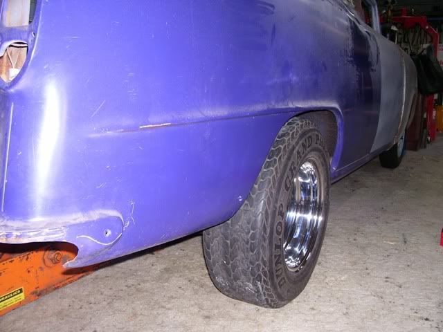

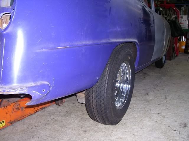

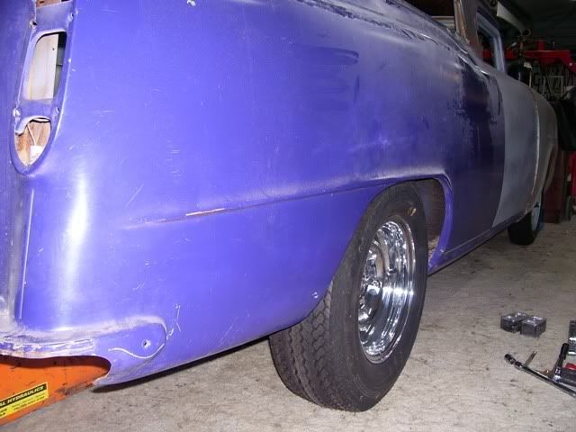

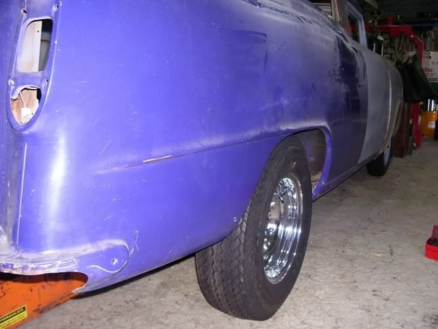

After. I should be able to lower the van right down over the wheels now 8)
With 2" lowering blocks fitted
Evan those deep dish 8" fit within the gaurd now, just.
But only without the blocks.

What width tyres are you running with the torana diff? I cant see myself getting anything wider than 205s in with my torana diff. The donor looks like a sweet colour :)
Hi (AUST)mod
The deepdish 8" rims wear 225/65/14
The 6" chromies have F70/14 Mickey Thompson Indy Profile's
Both rims have 3"1/4' backspace.

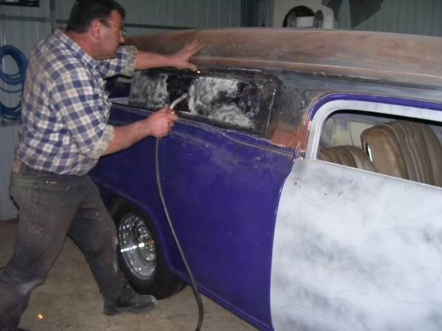

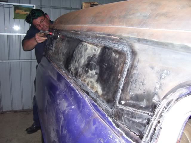

Started on filling the side windows tonight.
Tacked with mig first
Then oxy welding them in
Slowly, but surely :)

Progress report;
Still welding the side windows in,
Len also repaired the gap in the rain gutter where some was missing.
The panel between the gutter and the van window was also replaced, as the
metal was so thin in that spot along the old chop join.
When the welding is finished, (other side has to be done yet)
I will measure just how many meters/feet of hammer welding
has been done to repair the old chop & fill the windows.
I have also picked up the torch (should have learnt something by now :roll: )
and started filling all the badge holes in the guards & bonnet.
Slowley but surely, it will get done :D
