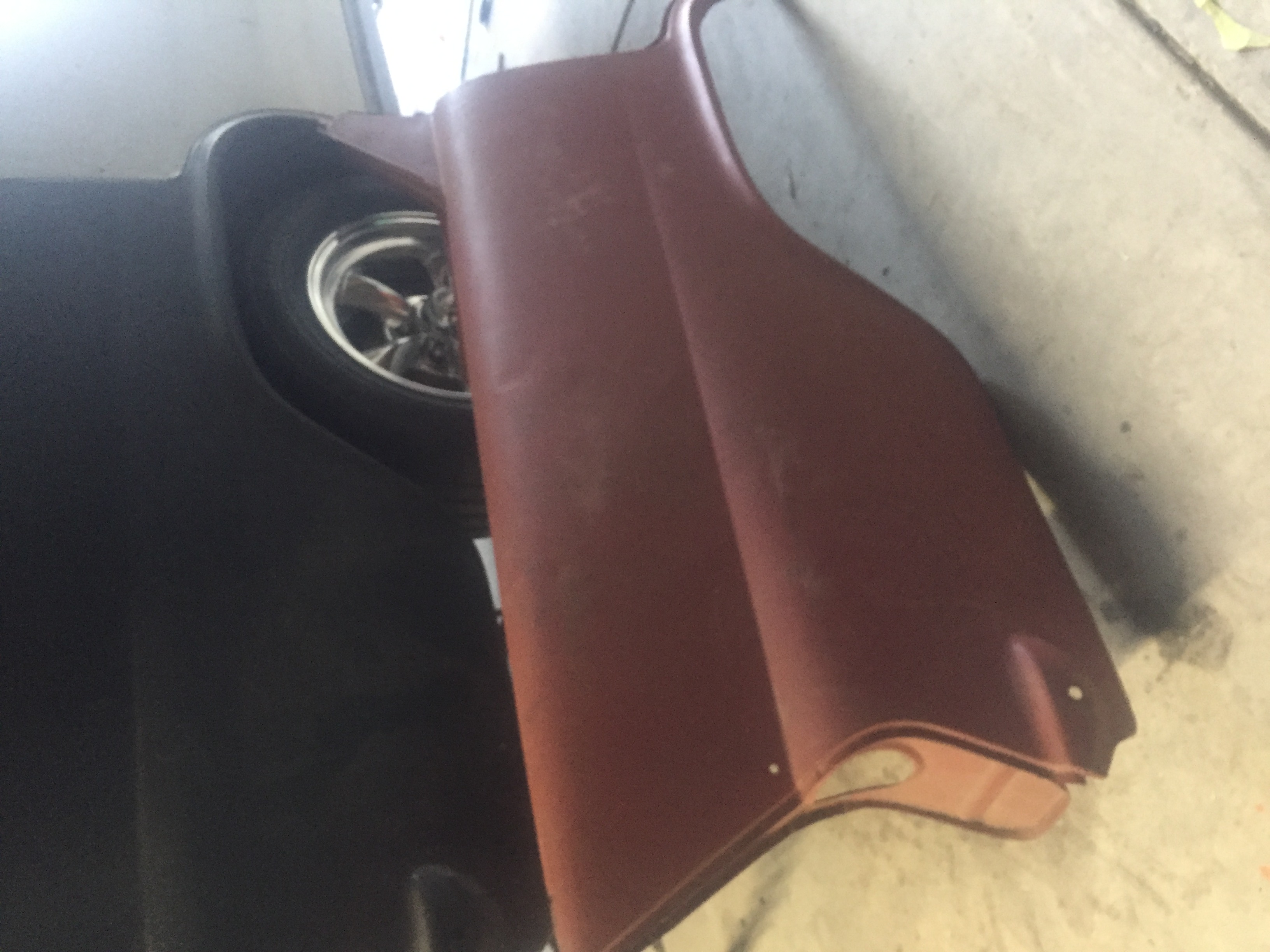

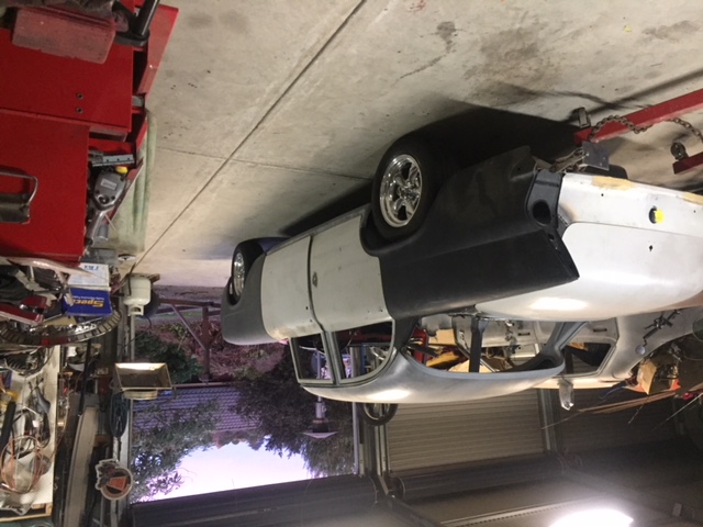

got the FB off the rotissierie and on the ground new mags fitted ,ride height level done , in the process of moving things around under the bonnet to give me as much room as possible for extractors. 1 new quarter panel on ....I will probably have a spare drivers side NOS quarter panel for sale soon if there is any interest ...I bought it off Bill Taylor from Taylors Rust Sections for $350.00 got some small dents from years of storage .....getting keen to get it on the road

What size are the wheels ?
Can you put the pictures right way up ?

6" x 15 on front and 7"x 15 on the rear .....how do I turn the photos up the right way ....they are the right way until I download them ....

the quarter is driver side as per your pic? and is it the same size as the black area on the right rear of your car?

Yup ... will do a photo tomorrow

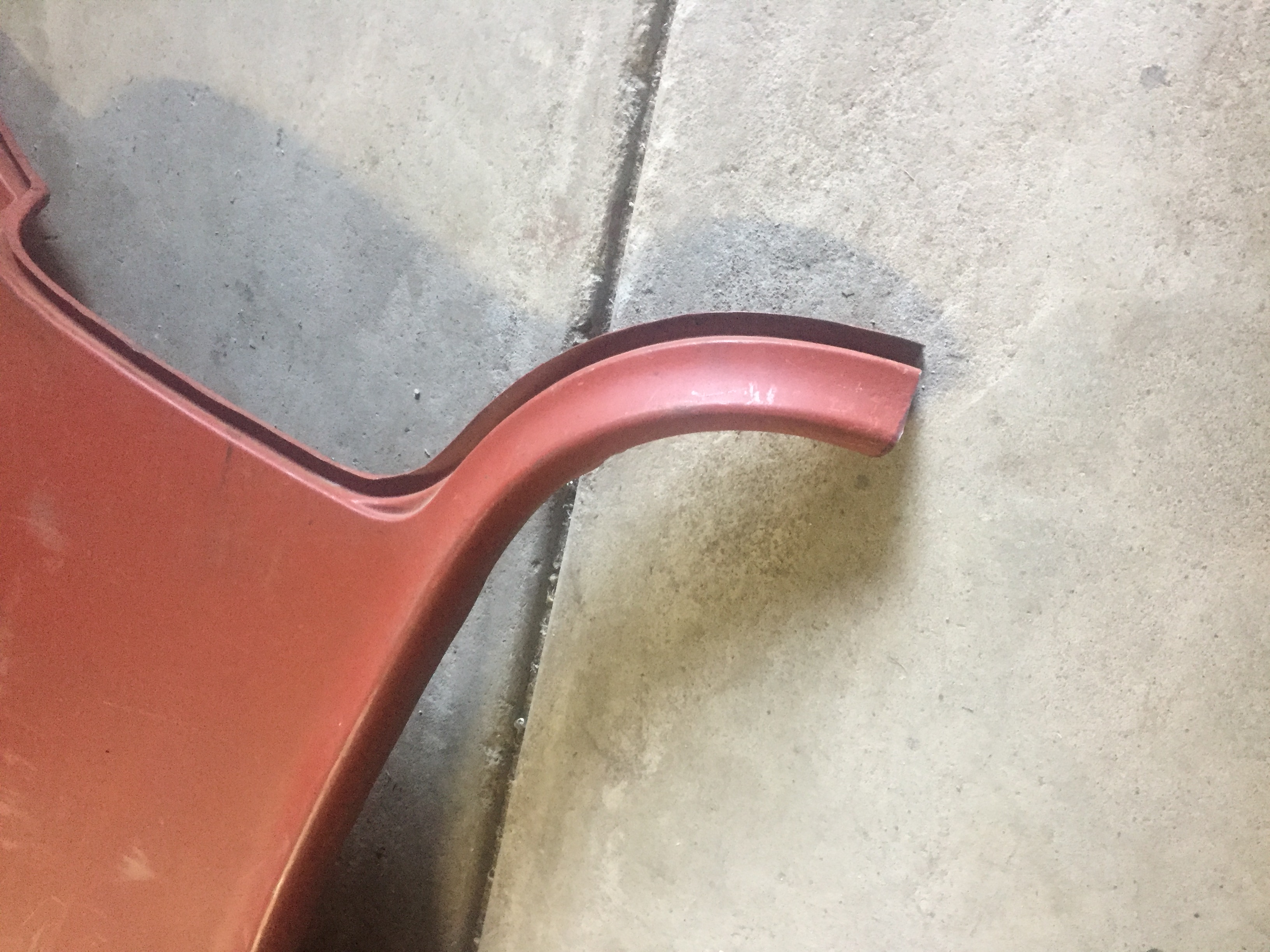

Post by fingers »
Has some small dents from long term storage and some surface rust pitting ....
