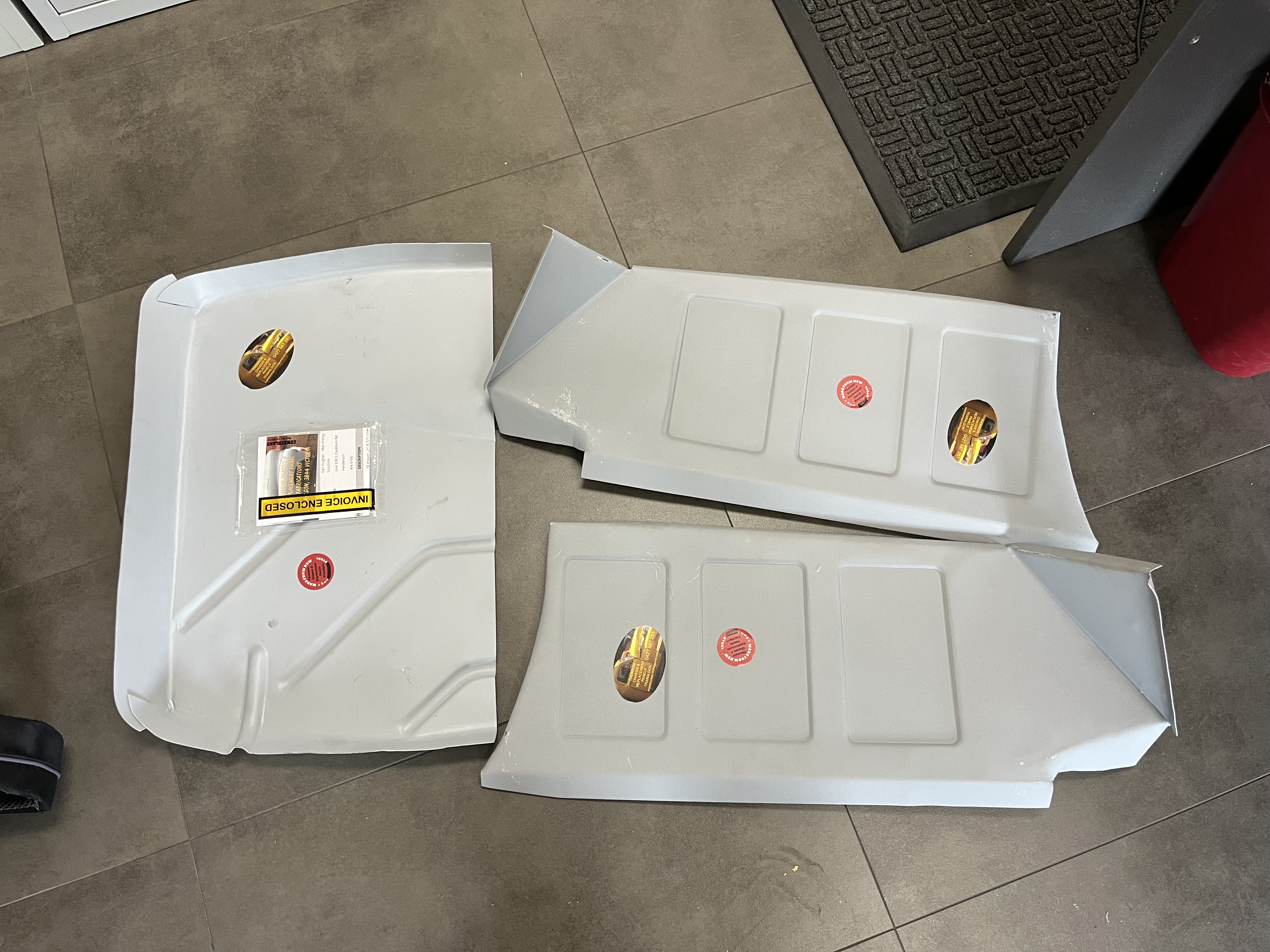

Got a present when I arrived at work this morning.
Mark Thompson certainly know how to pack his panels :lol: :lol:
Panels look great, I only need the outside half of the underseat panel, plenty of work to come and great that the next week or so is going to be cooler especially for our run next weekend.

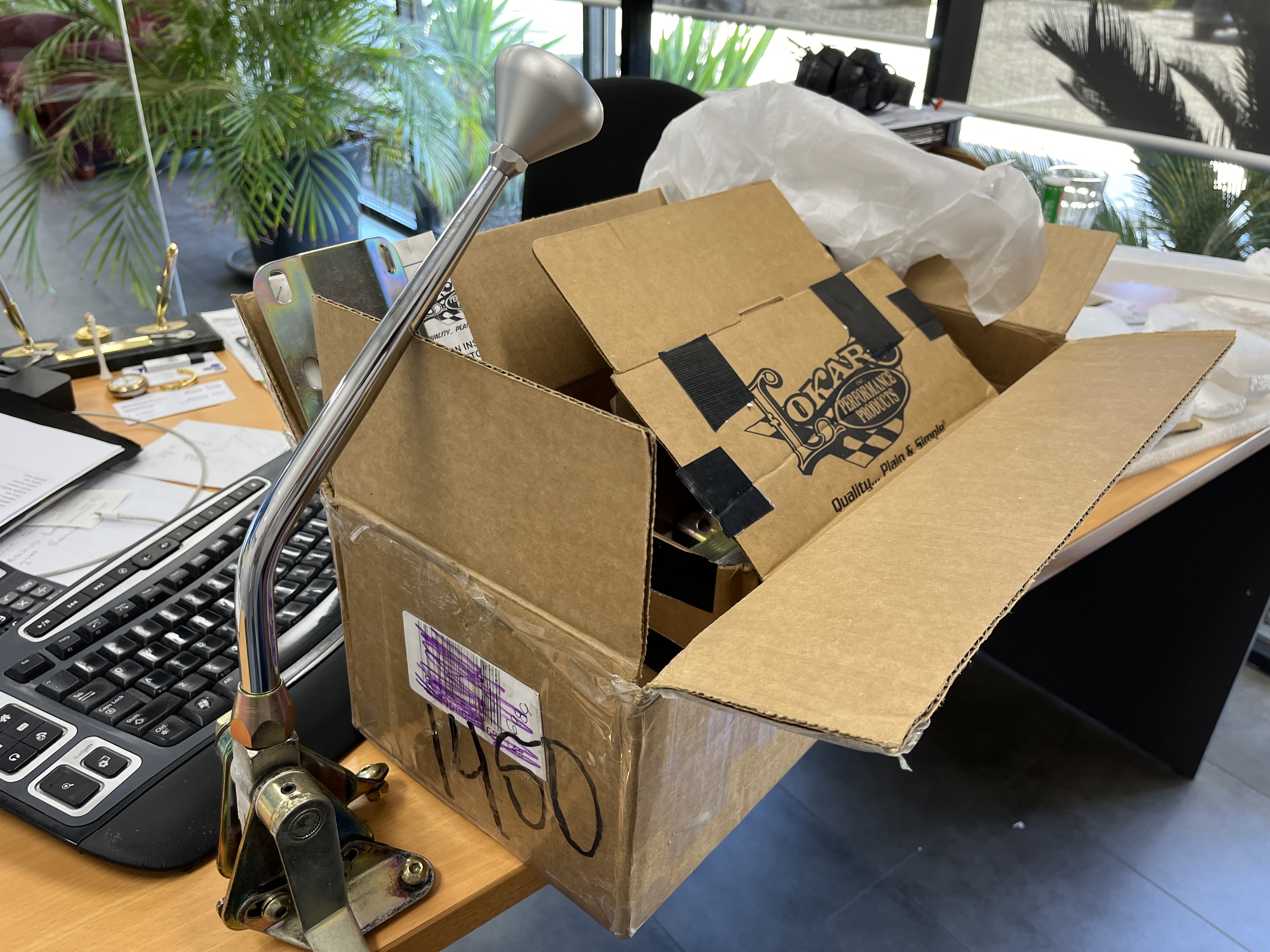

Was trawling the Yank eBay and found a Lokar 700 R4 shifter new in the box that a guy in Florida had purchased but not used, picked it up for 500 AUD, the guy is sending it to my sister in law who lives in South Carolina so she can send it to me, a bit of mucking around but seeing I'm a cheap skate I wasn't going to pay $2500 AUD for one in AUS and I'm not overly happy with the B&M that I have in Frank so going the Lokar route I know I have to spend some more to get the neutral safety/Back up switch and gear indicator but it will work out somewhat cheaper I think.

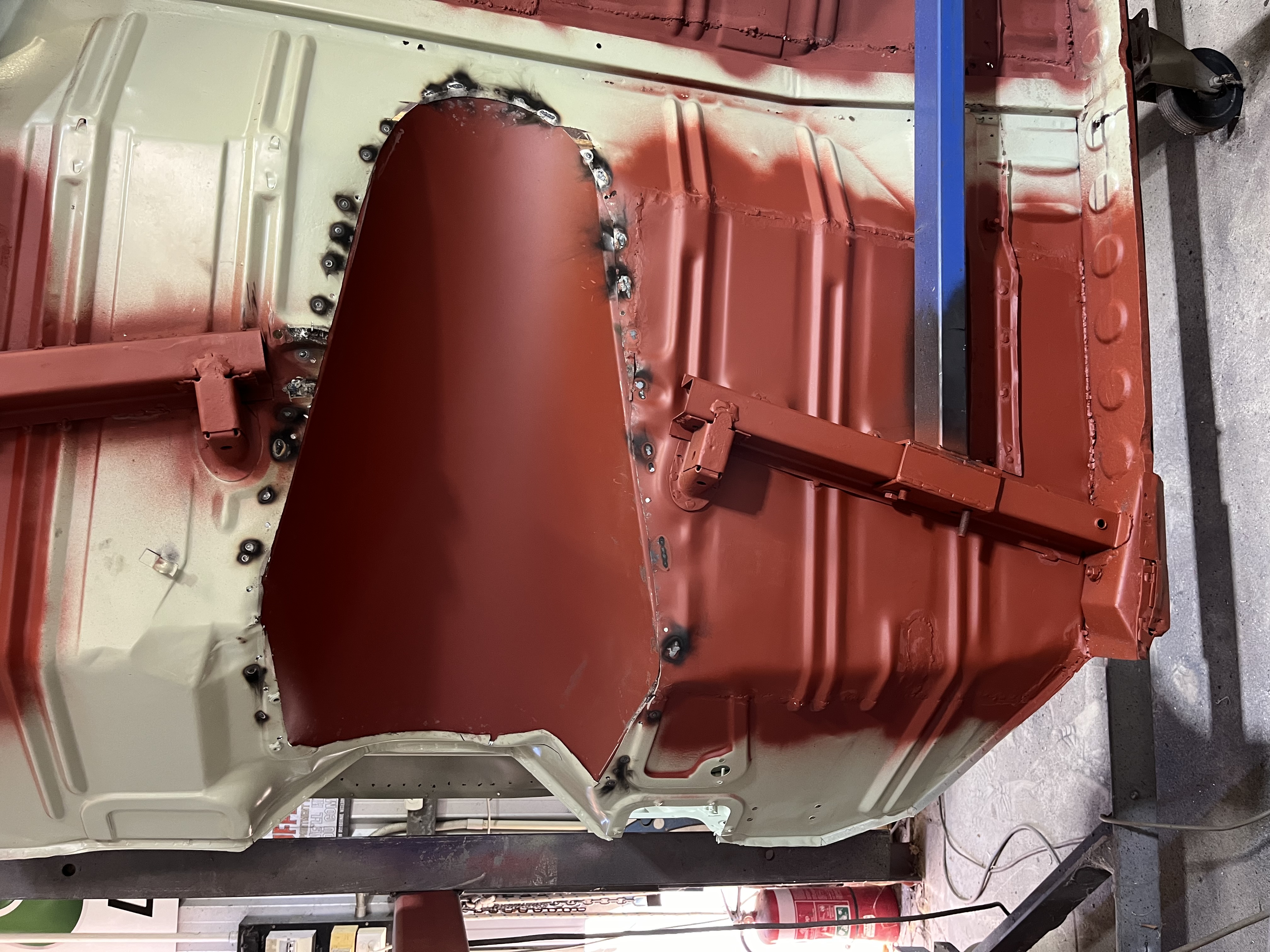

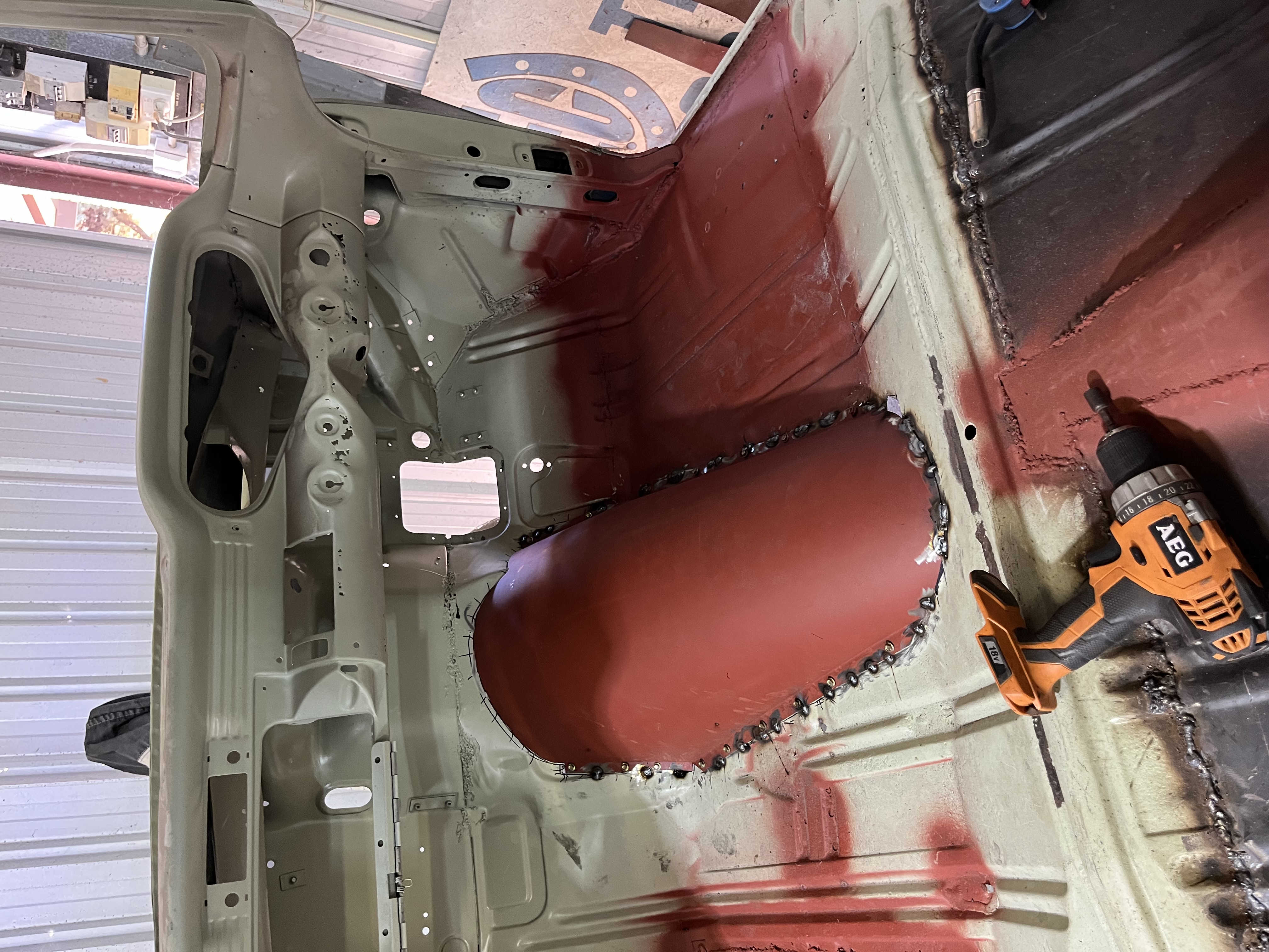

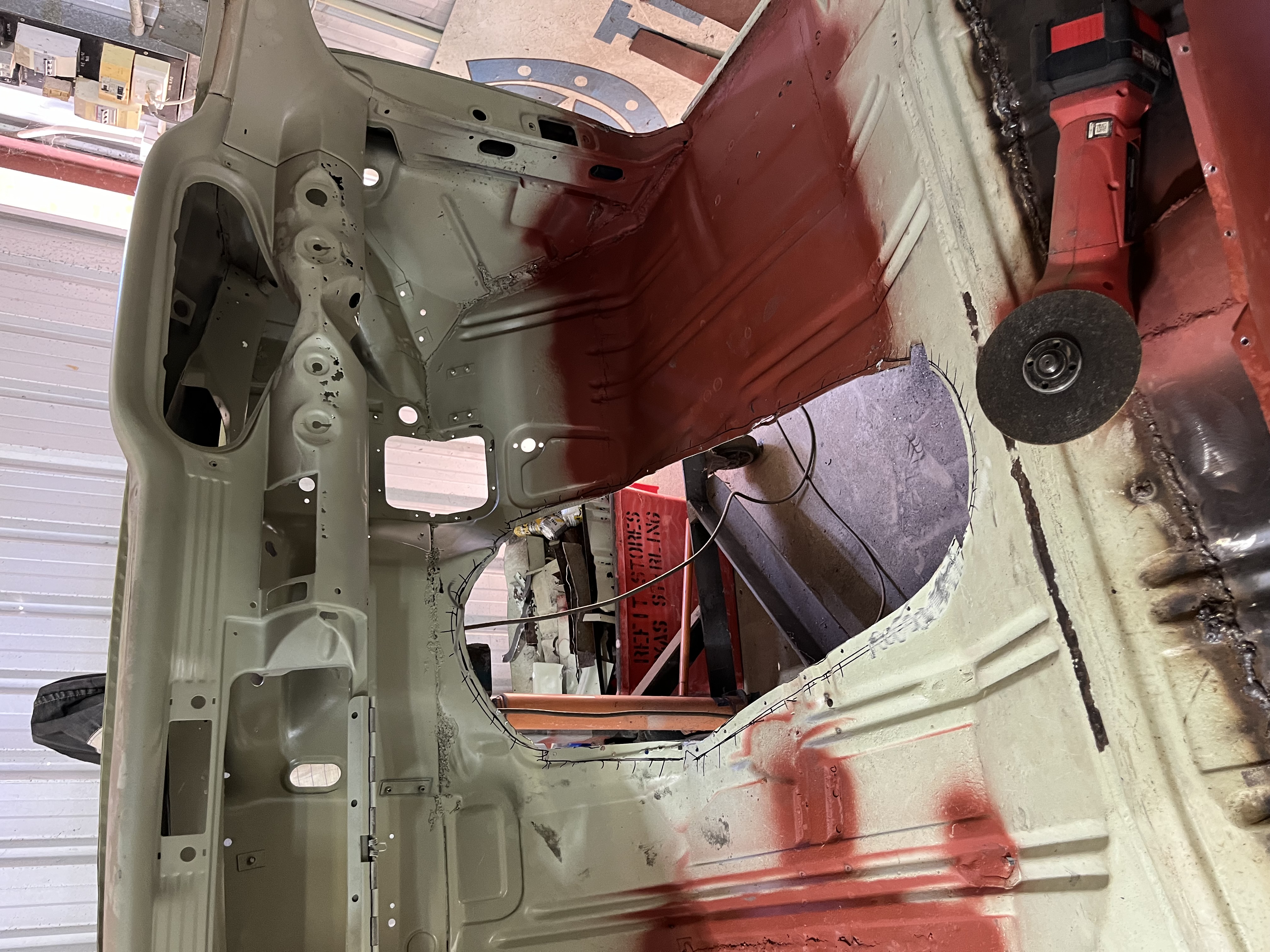

Sat down for an hour or two this morning before the club run and started on the inner rear quarters, not my most happy place once again drilling out spot welds :lol: :lol: :lol:
Just added photo doesn’t seem a problem to me :crazy: :crazy: :crazy: :crazy:

The Lokar shifter arrived from my sister in law in the states yesterday

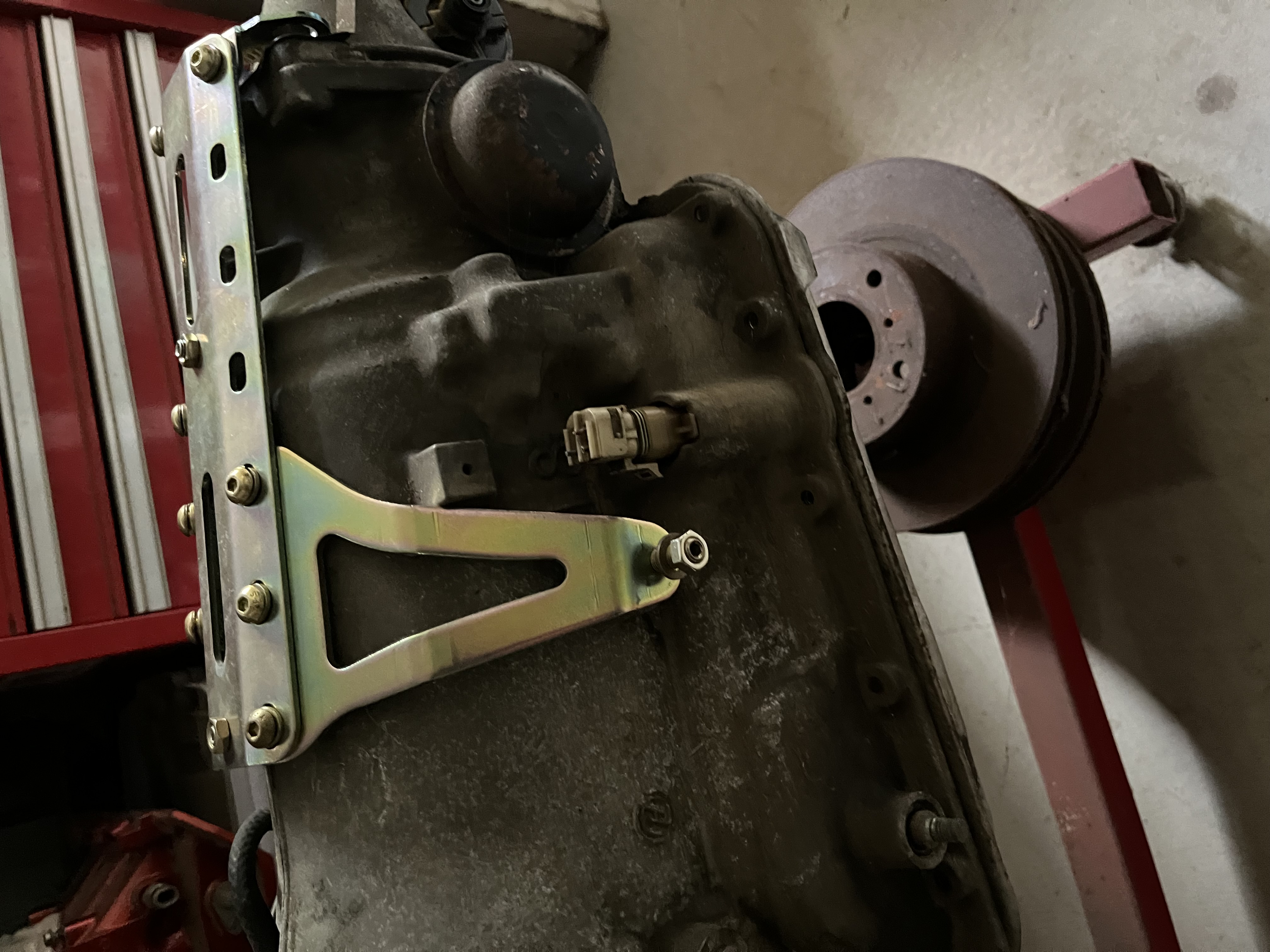

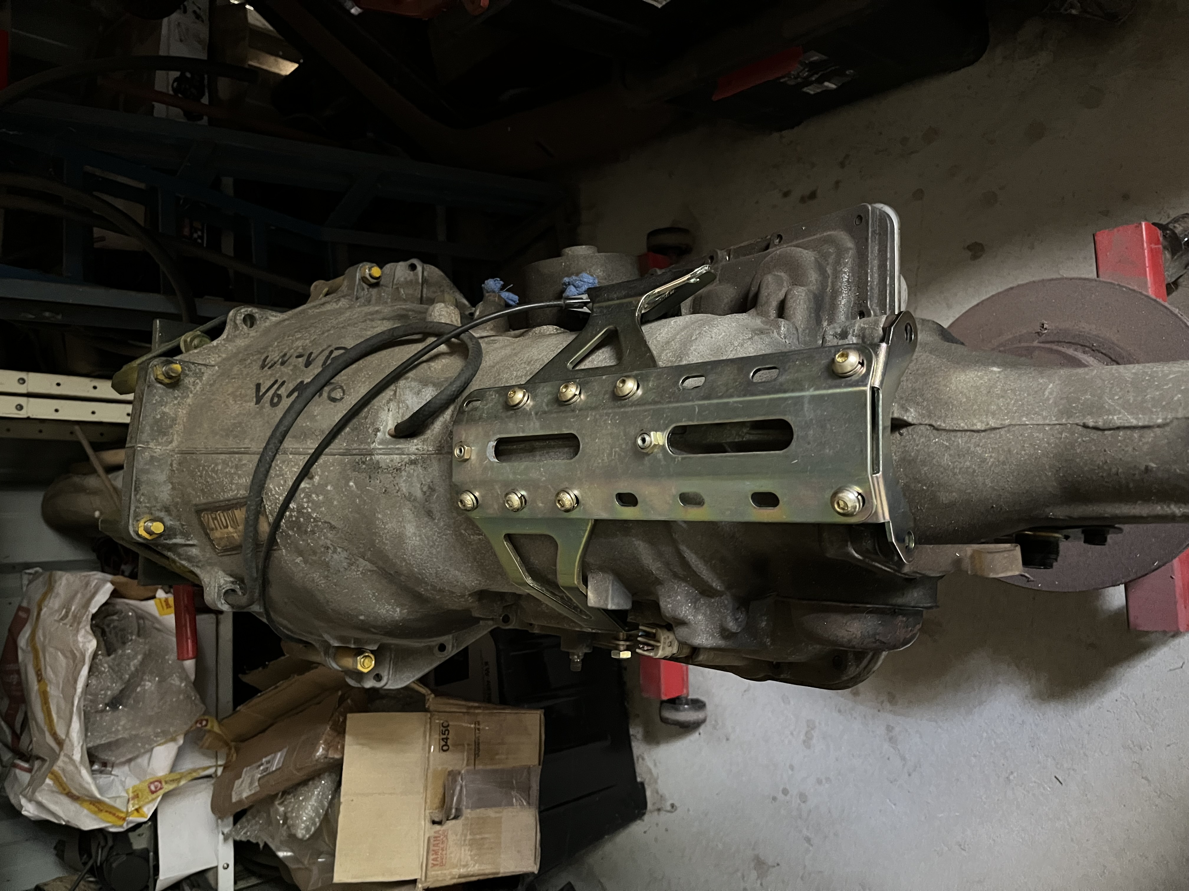

Couldn’t help myself when I got home and put the shifter mounting plate together to make sure I had all the parts, it is actually very ingenious how they have designed the plate to mount with the only actual bolts being the two at the back where the output extension housing is, the two front mounts on the side of the box they call tension screws where the mount is threaded and the screw goes through and tensions against the box, to protect the casing of the box they provide alloy plugs that the screws tension against.

by Cliff Regan
Hi Neil,
That Lokar Shifter looks the same as I have in My FB Sedan. I got mine from the Armadale Speed Shop, came with all the cables/wiring etc to set it up for 4 speed auto and unable to start in Gear etc. They work quite well and look a treat.
