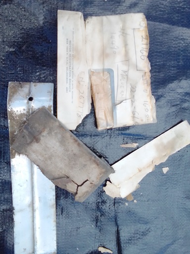

...or from my recent experience
had a bit more of a look at the 'patch' today, the two screws were holding:
a strip of aluminium,
a piece of sandpaper, and
a folded envelope

Thanks Stephen. I am enjoying the puzzle work so far. No documents in this one Patrick- but many wasp nests!
